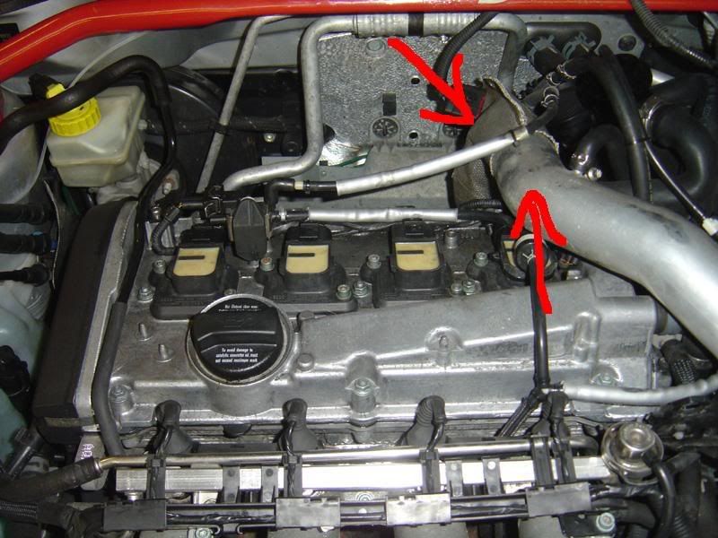

every time i acelerate in the car this hose blows of . i have got a jubelee clip on there at teh mo but it wont hold . is there any one tht makes a pipe that will replace this It comes of where it goes from metal to rubber to metal at the back , please help
hi, i had this problem, just get a normal silicone straight reducer (cant remember the exact size you need) from siliconehose.com and two good quality stainless steel clamps i use the miklor ones but there are other types, and you will be up and running in no time for about half the price if that. i run on high ish boost and not had any problems with it blowing off or the heat it encounters affecting the hose, hope that helps.:)

when you order the reducer it will tell you the wall thickness in relation to the ply of the hose (ply=how many layers of fiber weave the hose containes) so if you got a 50 mm inside diamiter hose and the wall thickness is 5mm you would need a 60mm clamp approx (2x5mm wall thickness gives an outside diamiter of 60mm) but you will have to measure the exact size because i cant remember what i ordered.:)
You want a 54mm-48mm reducer from forge, and some jubilee clamps, make sure you leave a bit of a gap above the edge of the pipe so the clamps can grip correctly.
