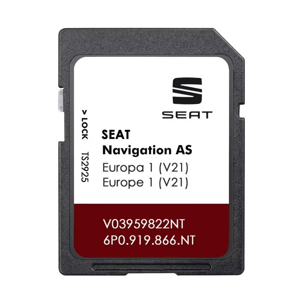

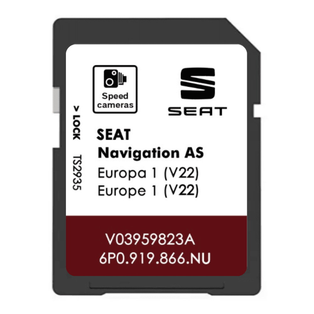

You can save yourself the money of buying a new card with modest PC skills. There is a resource built from the long running Leon 3 thread.
Yours I believe is a mib2 standard... I guess you dive into "how do I know" in the link, you are looking for 6P0. Also if it has a card in the system it will sag 6p0.... with other numbers on it. If so you down load the latest maps as linked
Then you MUST follow what this board calls the "workaround" devised by Exciter in 2017:
Steps:
  1. Download the latest standard MIB2 maps
  2. on the infotainment go to settings, safely remove, sd1 card
  3. remove sd1 card from glove box slot
  4. long press on the on / off to reboot it a couple of times
  5. insert sd card in to computer
  6. copy and paste all contents to a directory on your computer
  7. Delete the SD card keep it as fat32 and leave format settings as default in file explorer (don't forget to push the card lock mechanism to off) (ditto in a MAC or delete all from the SD card)
  8. Copy the new downloaded map version to the SD card (after unzipping it)
  9. Replace /maps/EEC/EEC_WLD/OVERALL.NDS on the SD CARD with the one from the original SD card
  10. eject the sd card (on a MAC run CleanMyDrive on the SD card - then eject)
  11. Inserted the card into the card 1 slot in glove box whilst infotainment is off
  12. power on and go to navigation
Step 9. Is the workaround. Skoda and VW offered life long mapcare via this download. Seat was awkward and didn't. Shuffling the that overall.nds file from the original card onto the new image forces the unit to generate a new navigation FeC in the unit. The method has been copied by all Seat formums across Europe now, all down to one clever poster in 2017.
If its a mib2 standard since 2017 circa 2020 or so the European map expanded in size. Original cards were 16gb. They can still be used if you pick a file from the link that is zoned. If you really want to travel across Europe all zones buy a 32gb card. These can cheaply be bought off eBay using what you normally do observe the reputation.
It's likely that the linked files release in June 2023 will be the last mib2 standard updates since nothing appeared in November 2023 across Vag boards.

Right well if it hasn't got 6P0 in the map descriptor then it's a mib2 high (Seat Plus). These were sold as the extra deluxe model to be added onto orders but fitted as standard on some Cupras from 2015-2020 (to 2019 model). The resource gives you the test. Again Seat tried to snooker owners from doing free map updates on these units. You can get the life long FeCs put on these units by East Yorkshire Retrofit or use one of two other methods, the mib2 high toolbox or update the firmware to 1447 AIO. Some late Seats in that range came with life long FeCs. You can do the test and check.
Mib2 high maps are still being updated and I'm running with the June 2024 (2024-2025 release) details on the discussion thread and resource. TMC Inrix can be coded onto these units as well, as per resource link and this does work with the latest maps well. That's a simple VCDS / OBDELEVEN coding change. We got to thank the TT programmer driver for that one.
Mib3 is what is used on the 2020 models to 2024. These use Here Maps over the air updates if you pay for connect services or you can do map updates twice a year. See pinned thread on the Leon 4 area of the board. Seat by mib3 scrapped a charged service via mapcare. Saying that best to use the VW files. Seat and Skoda post old files to their website. The user community find these files early why I've got the June 2024 maps on my car already. These Audi maps...
Mib1 the other other one prior to 2015 that's still being updated and the community has found 2023 maps now... on the main navigation thread. It was the Holy Grail early on the thread to update mib1 realiably. There use to be a 50:50 chance, the odds have been improved. Might still be work in progress. You need to carefully follow the instructions on that. See recent mib1 posts on the navigation thread.

That's a pricy card ?.
The pairing has always been difficult and dealships don't want to know about it. It's only recent that it's been said a completely new card will work straight in... but failing that we have a fix:
All of this has been worked out by posters on the main navigation thread on 5+ years.
Many, many people just update the mib2 standard with the workaround method. If you loose the card, buy a new one and use the link above plus the workaround method. They have all been doing it since January 2017. 6 years years of updates twice a year for free. The issue comes up when they delete everything on the card, hence the link or obtain a new card. The Seat site does say not applicable to the UK, people ignore that. Mapcare was sold in Europe for a princely sum after three years or 100€s new. About 600€s I recall after three years Europe for another three years, whilst UK customers were suppose to fork out £250 or so a go.
Basically when a navigation card is first placed in the unit say version x, it pairs with version x. An online update without the overall.nds trick won't work. You do just the link plus the workaround if you introduce a new card and you don't know what version of card you had. You can buy old cards using the method if into cost saving and put the latest map on them.

I gave up faffing around with map downloads on my 2019 Leon ST with the 6PO system. I bought a 2024 maps update SD card from an eBay UK seller called "XL Navigation Cards Specialist" for £20. It works perfectly, I wish I had done this in the first place. It is a maps only update not a system update as well.
It's not difficult to do the workaround but some people don't have the basic computer skills where buying a map on an SD card comes in. In the past one person copied the directory where the NDS file was rather than the file not understanding the difference between directories and files :unsure:.
I suspect the 2019 people might be riding on the back of when they took Mapcare off which is why you are getting away with buying a map card and not doing the workaround, if it was that easy people would have done it before !. Seat in Europe wouldn't be charging you 600 Euros for for 3 years of Mapcare if you could do it for less buy buying the card. It was the last year of Mapcare on Seat when it was scrapped.
It's this post:
So when you say easy just buy the card... yes if you have a 2019 Seat !. Those cards were sold for people with map care or where map care had been taken off.
A simple check you can do if you follow the link above. Those that have done it without the workaround will have EE at the end.
Yes just change the SD cards over. It really is that easy on a 2019 Mk3 Leon ST and no need for a degree in software development.
