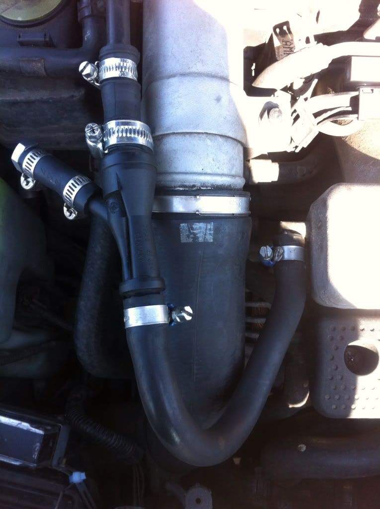

lcr pcv delete with catch can = correct?
Just done this an and it doesn't feel right.
From catch can to t piece. From t piece onto cam cover and to the crankcase breather by oil filter. No hockey puck.
From catch can to the TIP
Connection in middle underside of intake manifold blocked off
The 2 pipes on the left of the intake manifold I swapped so just the 1 goes onto the intakeanifold and removedthe excess hosing.
Can somebody correct me or is right?
Any help would be much appreciated.

Thanks for the quick reply. Guessing the hockey puck is a sort of one way valve / pressure release? Probably why dump valve seem quieter. Does it go between TIP and catch tank then or between cam cover and catch can?
Normally there is a hose that runs from around the brake reservoir area down the OS of engine into a t-piece under the intake manifold which the 1st goes to the piping that comes out and the 2nd goes to a connection on the OS of inlet manifold. I just connected this pipe direct to the OS of the intake manifold. My guess would be a brake servo pipe.
Thanks again.
d4ns
Nov 10, 2012
101
Cool will go and fit it back in now then. LCR with AMK engine. Guessing it goes from catch can to the bottom of the hockey puck not the side?
d4ns
Nov 10, 2012
101
Perfect. Thanks. So if venting to air you wouldnt need the hockey puck, youd just run a longer hose down to nearer the floor to get rid of gasses.
