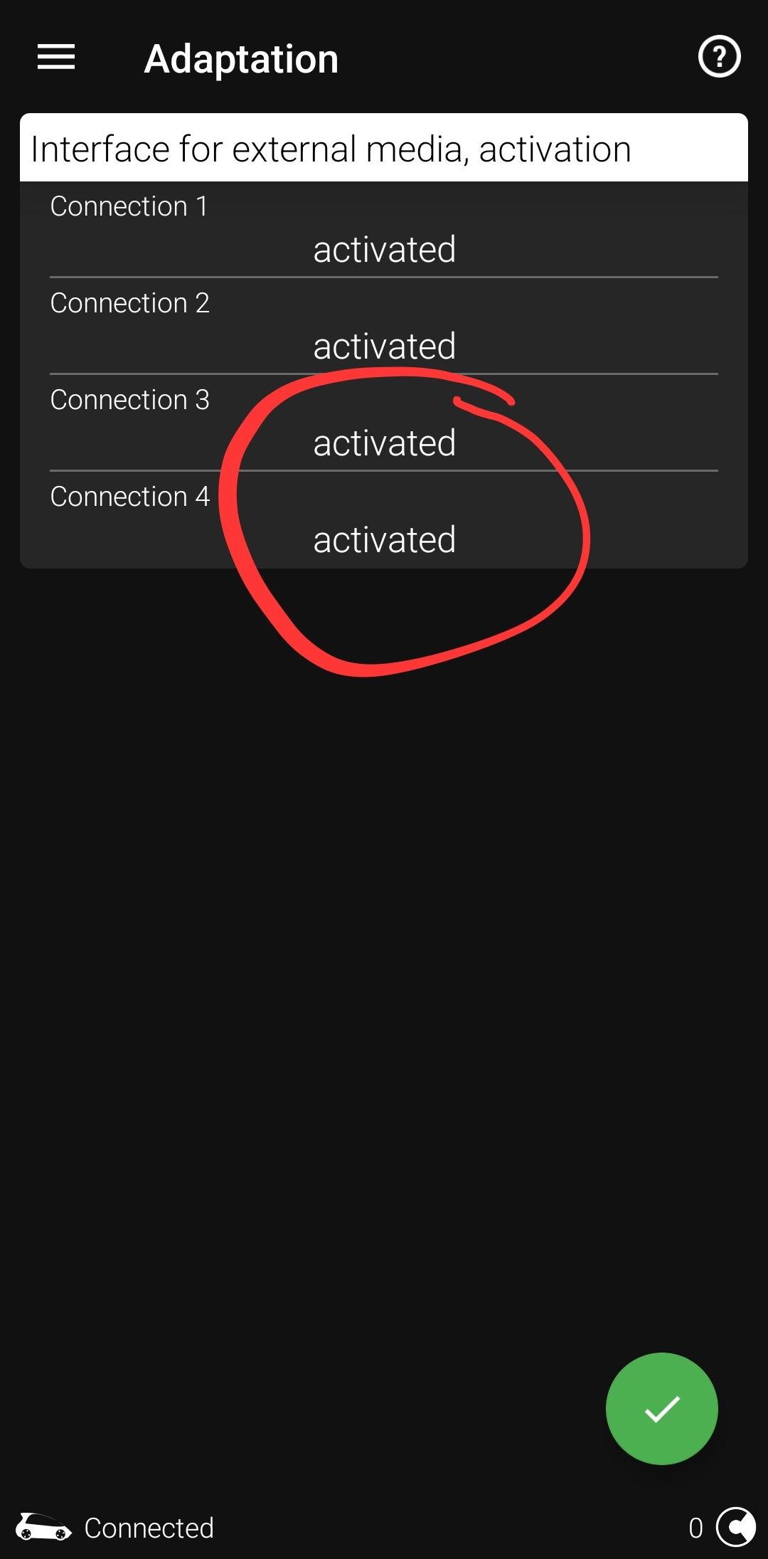

Using obdeleven,

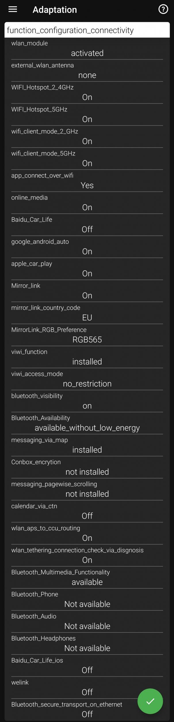

Head into multimedia and Adaptions.
First, in function_configuration_connectivity enable options that allow wireless connectivity.
Then, in Interface for external media, enable options Connection 3 and 4
I hope this worked for you, but you might need to reboot the infotainment system by long pressing the power button or you might need to turn the ignition off and back on again.
