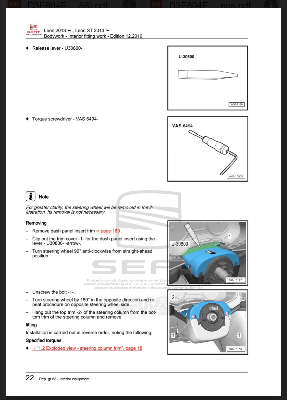

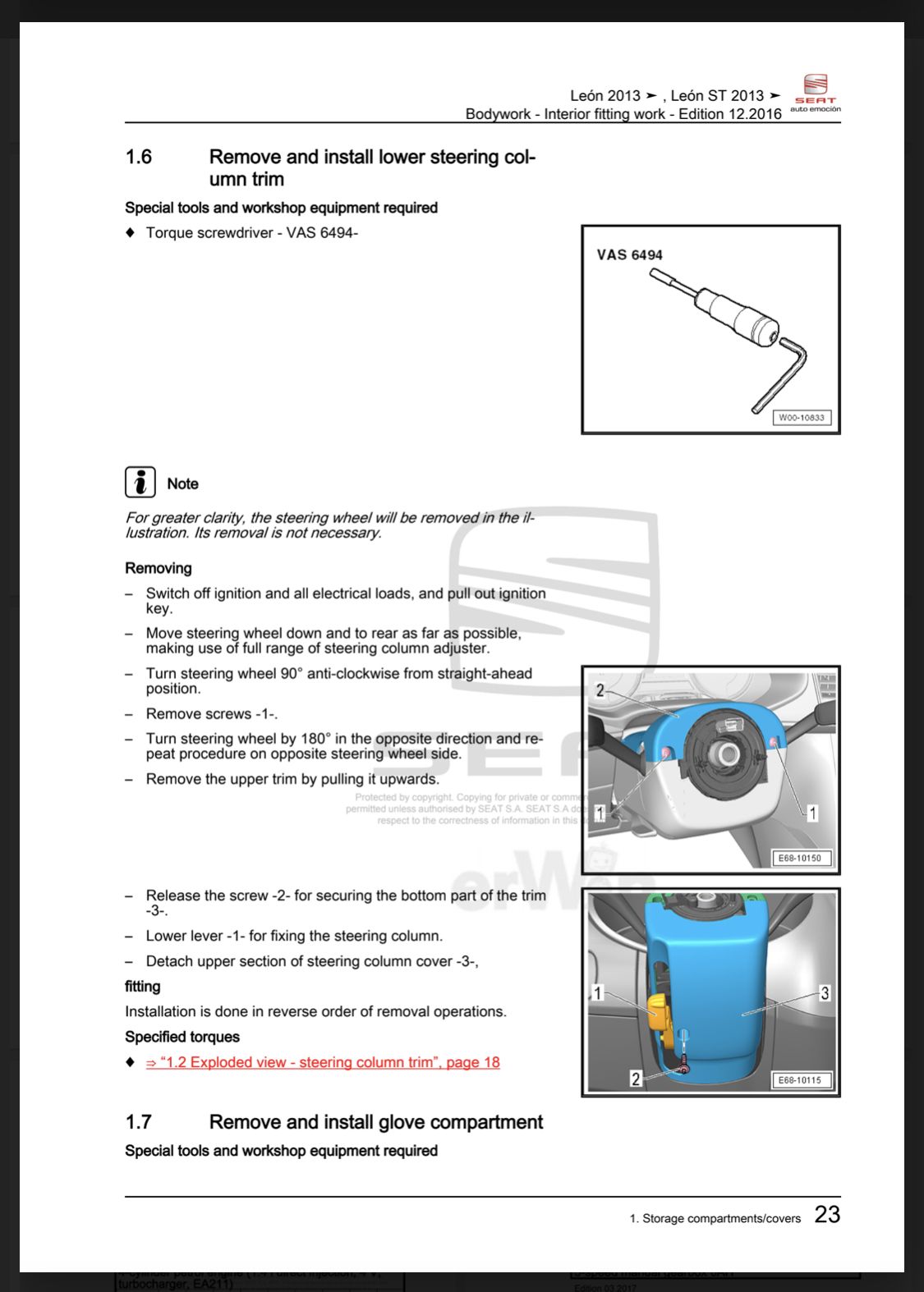

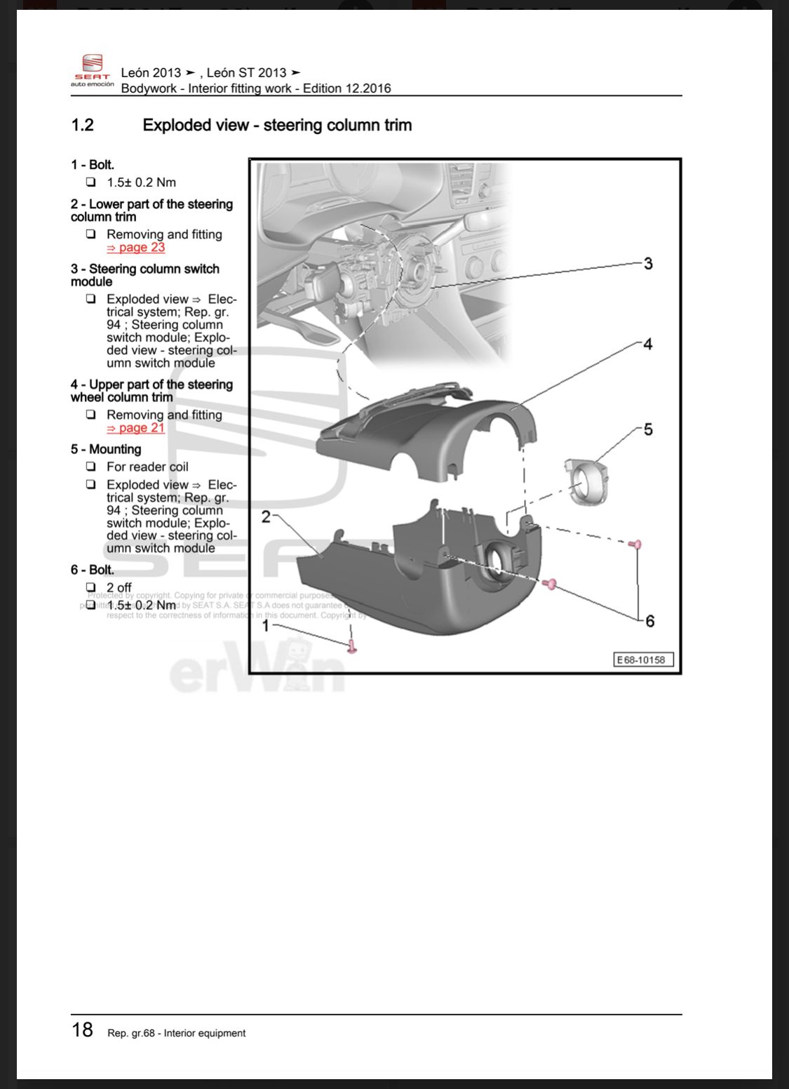

NotSoSimple Simple Mar 3, 2017 243 17 Suffolk Nov 23, 2020 #1 Can anyone help with removing the steering column plastic covers on a 2017 leon mk3? Obviously, i remove the screw and the back half of the cover come apart, but is there another screw or something near the wheel i cant spot. I don't want to pull too hard if there is something else to remove!
black_sheep Active Member Mar 10, 2013 1,244 588 Nov 23, 2020 #2 Some pics here: Attachments 8AF35DBE-02B8-422D-A311-4BB11E876F23.jpeg 135.4 KB · Views: 1,424 E249387F-A60B-4766-9E84-1AE29D3B2D54.jpeg 117.5 KB · Views: 1,866 1D76F59C-63DE-42FD-8F24-68AA74E9BEFE.jpeg 147.3 KB · Views: 965 Reactions: Mr Pig and NotSoSimple
NotSoSimple Simple Mar 3, 2017 243 17 Suffolk Nov 23, 2020 #3 You absolute legend, that's exactly what i needed. Remarkably the internet did not seem to hold this answer, thank you.
