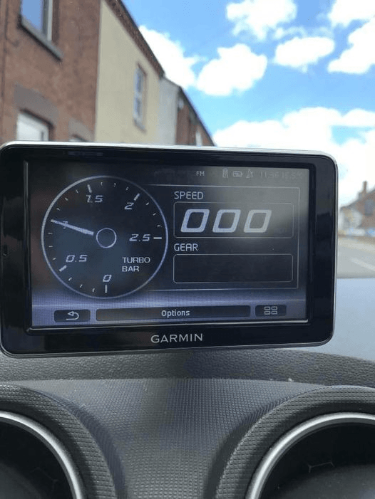

Hiya Mate, i have updated and worked perfectly the only thing that looking around is perofrmance display just to be able to show the Speedometer in Mile with Big display.
Did you be able to do so ?

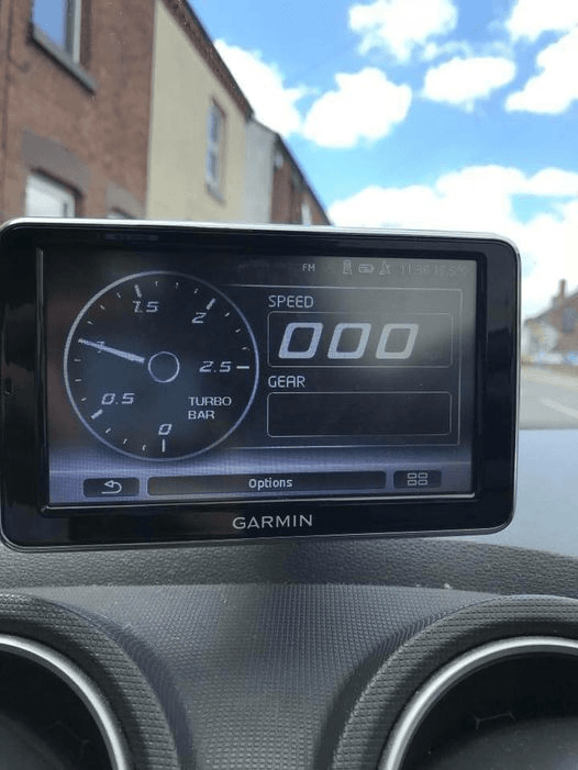

Did you be able to do so ? View attachment 34771
I'm not going to lie to you mate, my Garmin doesn't have that app , in fact it never has. I wish I could help you but I've never seen that screen. A guy in my work has an FR I can ask him if he can help.
