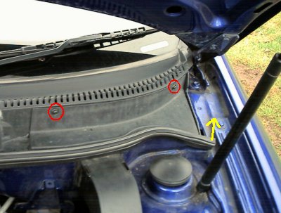

Do you mean the 2 pop studs?
The joys of google found me this photo - these ones, yes.
Like with so many parts, they've got a thousand different names, and I'm yet to find the name that actually takes me to something I can buy.

Yeah, guessed you meant those. If you want the real easy answer - don't bother, I've run both my Leons' for nearly 10 years without them. Just a pain to be bothered.
If you want to know more it may mean a trip to a dealer and look on their system as they one's we get access to like OEMEPC don't list them or indeed the part being held.
I've got a mixed bag of fittings and later I'll have a look to see if any are the right ones.

Part number is 1M0853547A £1.09 each. No.5 in the pic
Perfect - thank you.
