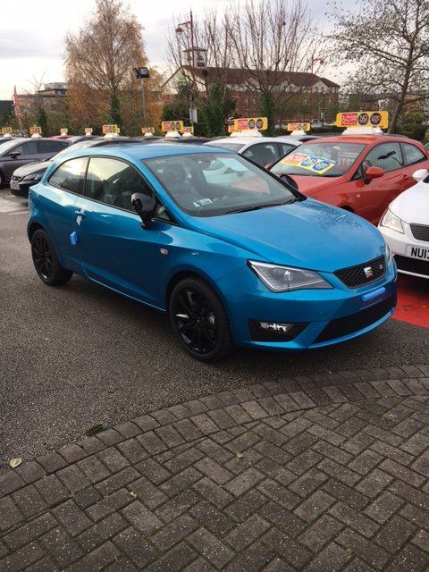

It's a massive job, and also not easy to source the OEM Bi xenon since this version of Ibiza has been discontinued. Don't need Cupra bumpers as mine was an FR. I did pay £425 to upgrade to these BiXenons from factory order though. To do the upgrade this now to OEM probably will cost 3x if at all you can do it. So probably for looks you can just get a Led DRL lookalike and perhaps find some h7 bulbs that are whitish like Philips Diamond visions or similar. Here is mine on stardard FR bumpers.

Damn. Looks like it’s not worth the hassle & money. Better to pick up some good aftermarket ones & get decent bulbs
