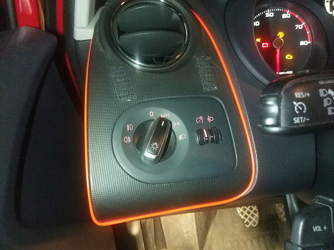

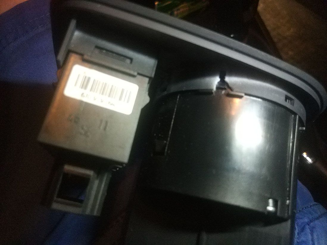

hi all I have a seat ibiza fr 1.2tsi 2014 it doesn't have auto lights but I would like to fit a aftermarket one from China as it comes modified with the wire sensor that goes on the dash i was wondering if anyone had done this and what part number would I be looking for thanks in advance
Hi,
I have bought something like this:
/www.aliexpress.com/item/WarriorsArrow-AUTO-Headlight-HeadLamp-Switch-Light-Sensor-Module-Bluetooth-Upgrade-For-VW-Golf-MK4-Jetta-4/32837624671.html?spm=a2g17.10010108.1000001.12.78a85efbL9PA6b&isOrigTitle=true

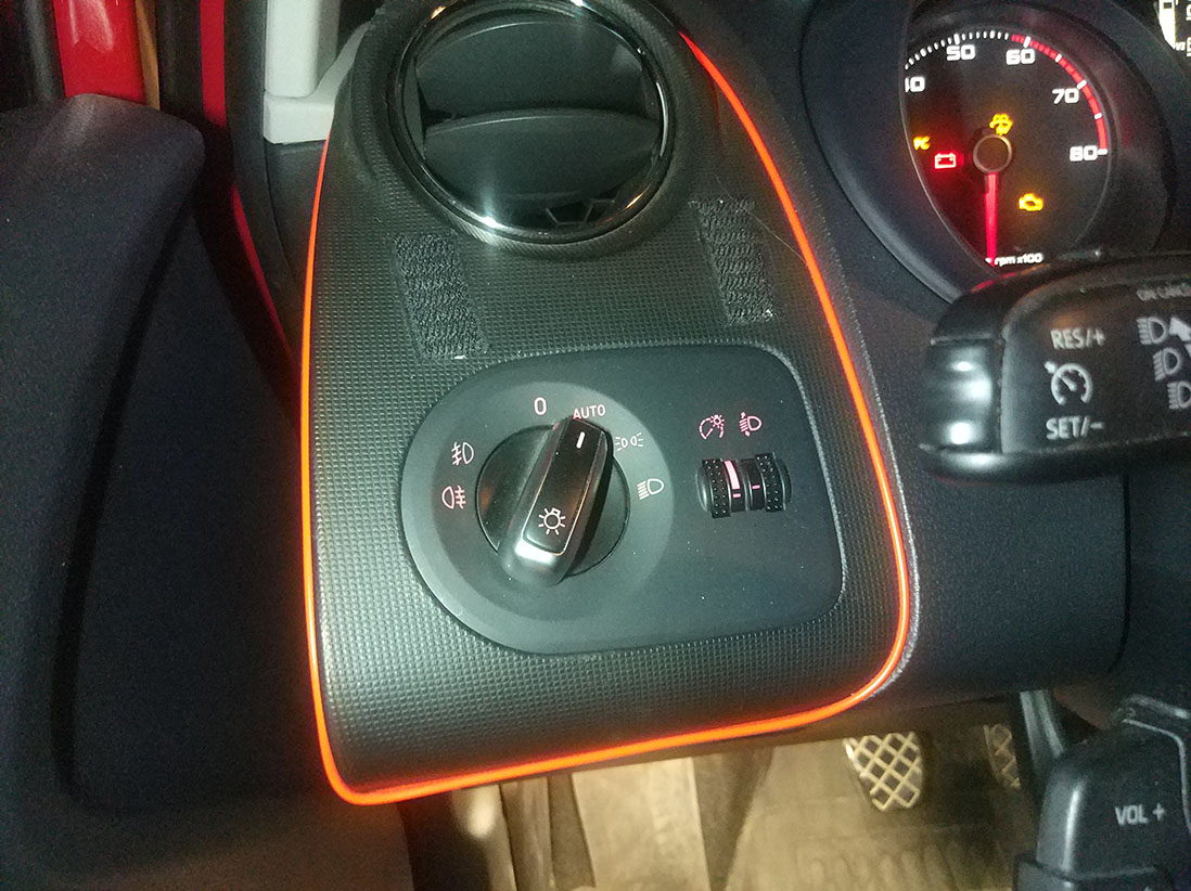

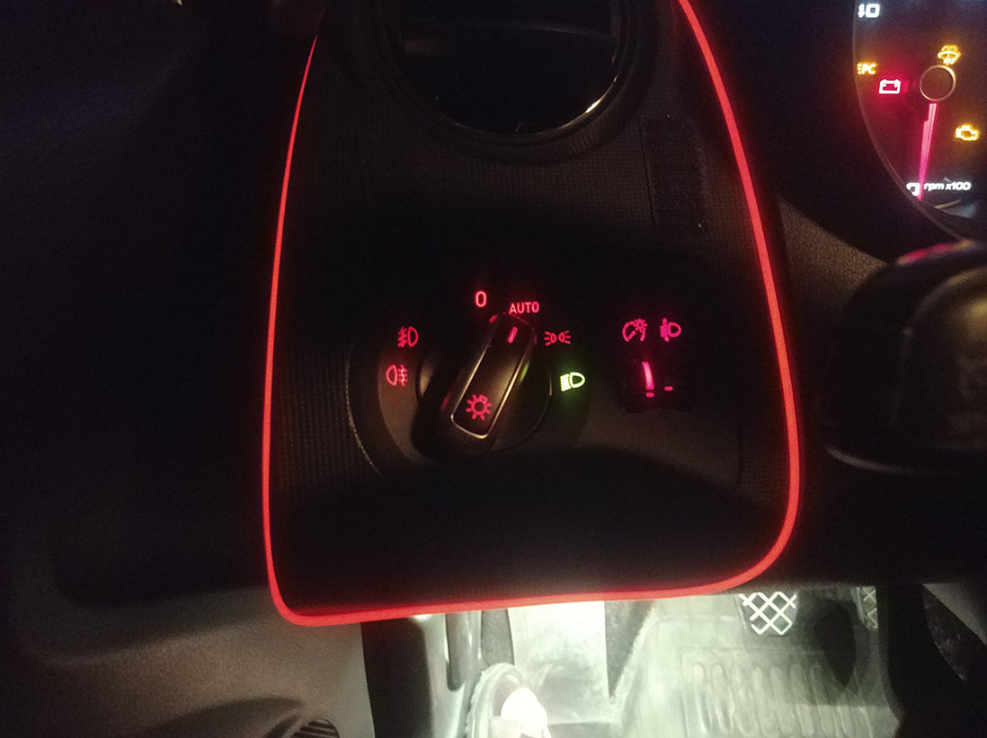

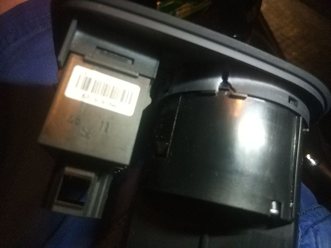

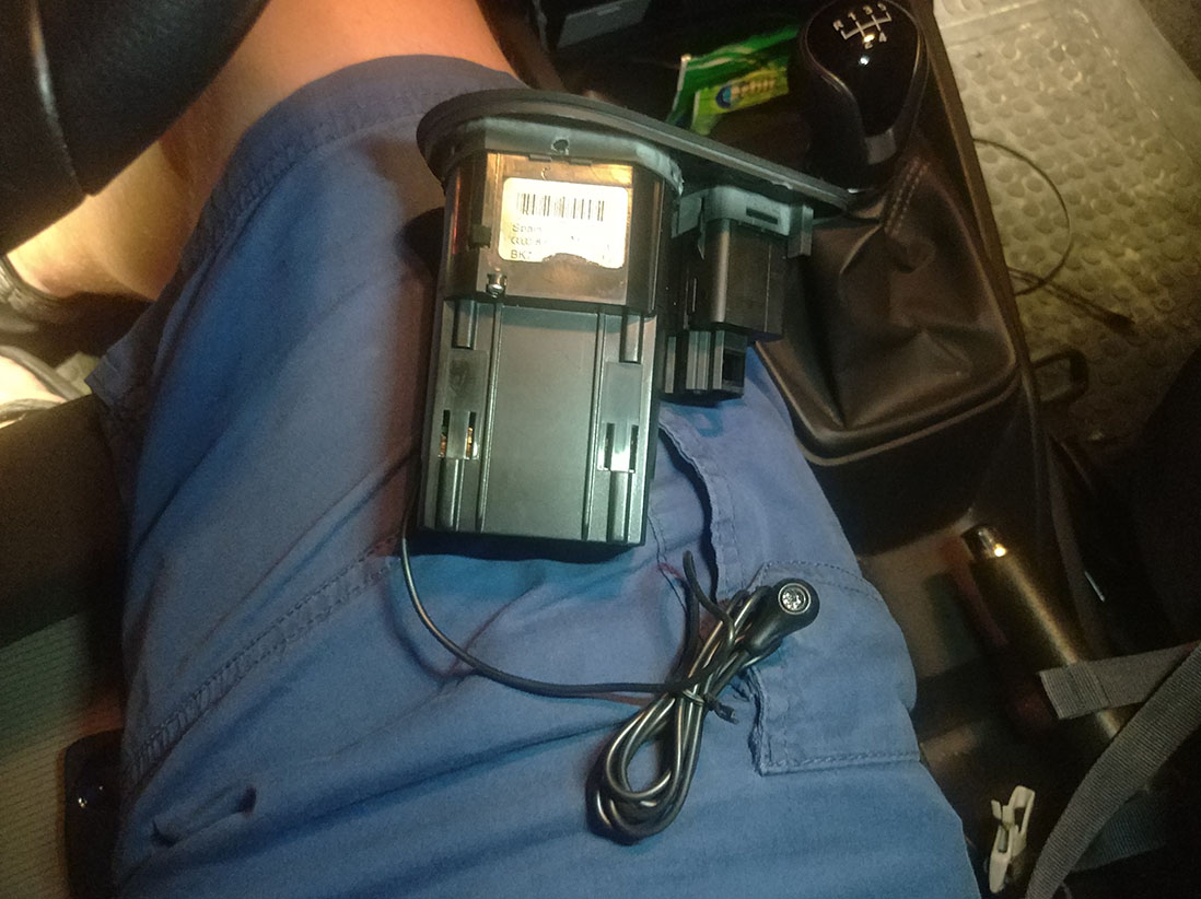

It works like a charm. I have also bought a switch with AUTO label (6J1941531AF) only to use a cover out of it, so that it looked almost OEM. I had to make new mounting holes in order to fit aftermarket switch with cover but it works fine. As for the switch it also work as it was described.
111IMG_20190604_213128.jpg 111IMG_20190604_213143.jpg 111IMG_20190604_213421.jpg 111IMG_20190604_213434.jpg
View attachment 7575 View attachment 7576 View attachment 7577 View attachment 7578

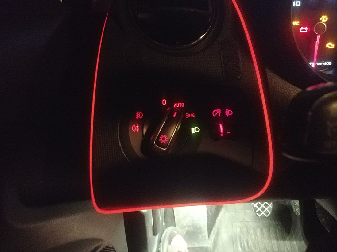

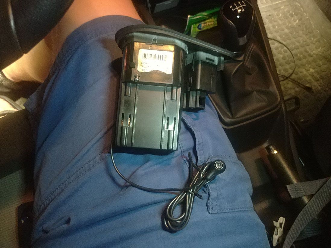

What are the lights around your trim?
Regarding this Auto light. where did you run the sensor to? Also, what is the purpose of the bluetooth, I assume that's not actually required to make the light work? You ordered an OEM switch so you could use the cover off of it instead of the one that comes with this switch?
I just hid the sensor near module itself because I wanted lights to always turn on. You can mount it in the corner of windshield and the A-pillar in order to work with the sunlight. Bluetooth allows you to configure the device. You can set CH/LH lights, set time after which the sensor will turn on and off the lights and light sensivity. I did bought used OEM switch with proper cover just to use cover. The one which came with the switch I orderd from china was for VW cars (different cover) I didn't found the one for Ibiza. As for the red trim it's called el-wire, I have mounted it also around door trims and central console the one with passenger airbag.
Jacek, did you had to take the new “auto” light switch apart because the switch itself can go trough the hole?
Hi sorry to revive this old thread but I am also really curious @Jacek785 how did you manage this? I have bought the same parts as you and ended up damaging both trying to get the switch through the hole lol!
Did you ever get the switch to fit through the hole, reason being I am currently in your predicament
Hello, i have the switch and everything else but i cant get switch thru the cover. How did yall do this
