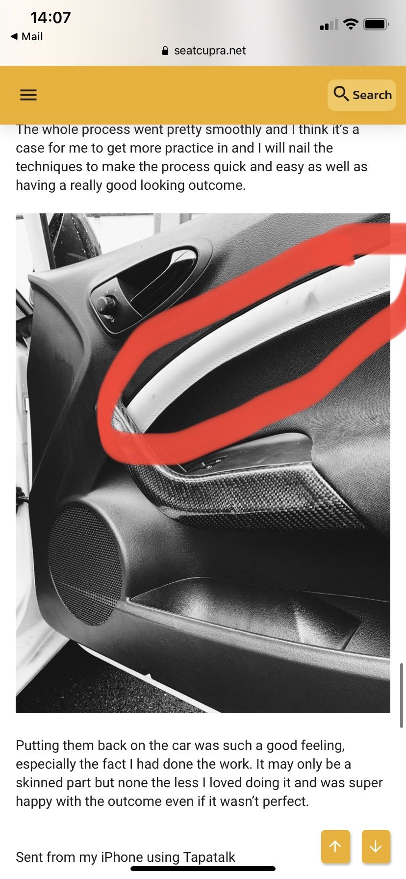

So these past few days I have been experimenting with carbon fibre. I’m completely new to any composites and thought I’d give it a go.
The whole process went pretty smoothly and I think it’s a case for me to get more practice in and I will nail the techniques to make the process quick and easy as well as having a really good looking outcome.
Putting them back on the car was such a good feeling, especially the fact I had done the work. It may only be a skinned part but none the less I loved doing it and was super happy with the outcome even if it wasn’t perfect.

Do the other bit of door trim to match and that will look spot on ? ??
Which bit mate? I didn’t do the underneath as I have another idea for that, when I fitted them I did think to do the top bit where the window buttons are.
Got plenty of carbon fibre left so I am looking to do more parts but trying to keep it looking like it was optional extra from the factory so not wanting to go over the top.
the bit circled in red, agree with the factory extra type theme, too much would spoil it

That bit I 100% agree with you on!
I will get onto doing that bit next for sure, I’m gonna be doing some more experimenting soon as I’ve got a few ideas and there isn’t much on the market for the interior.
