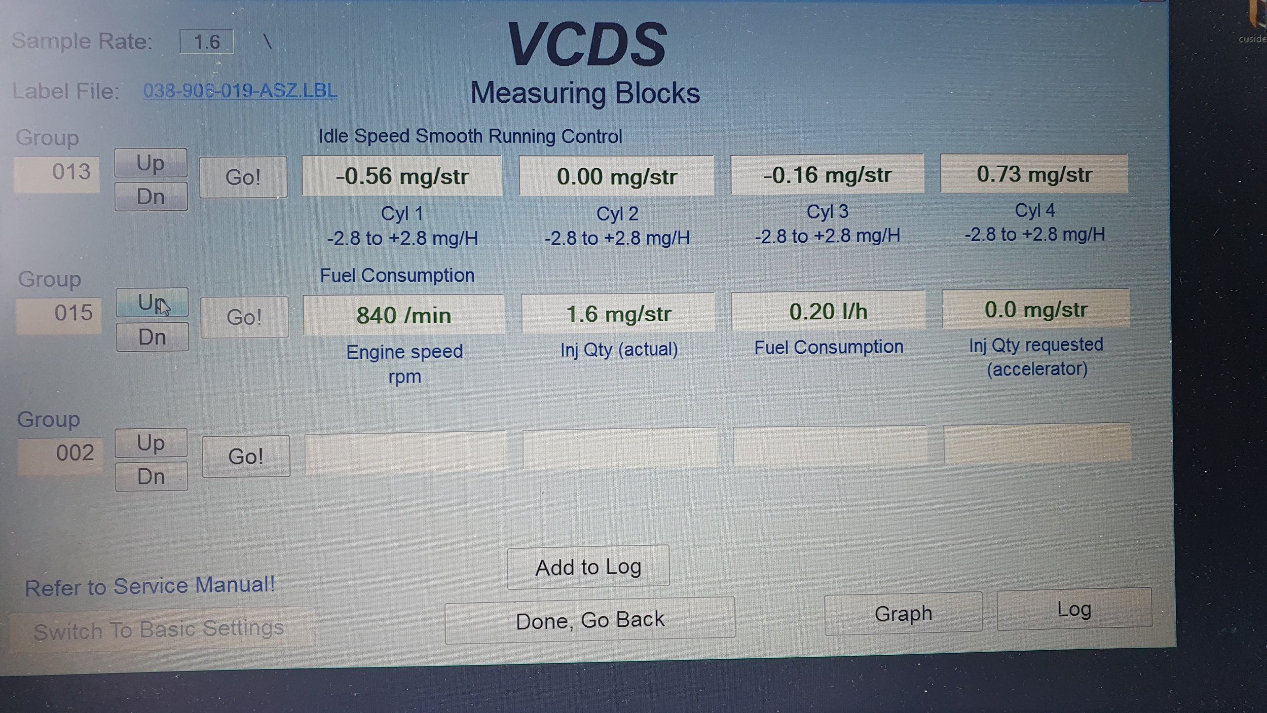

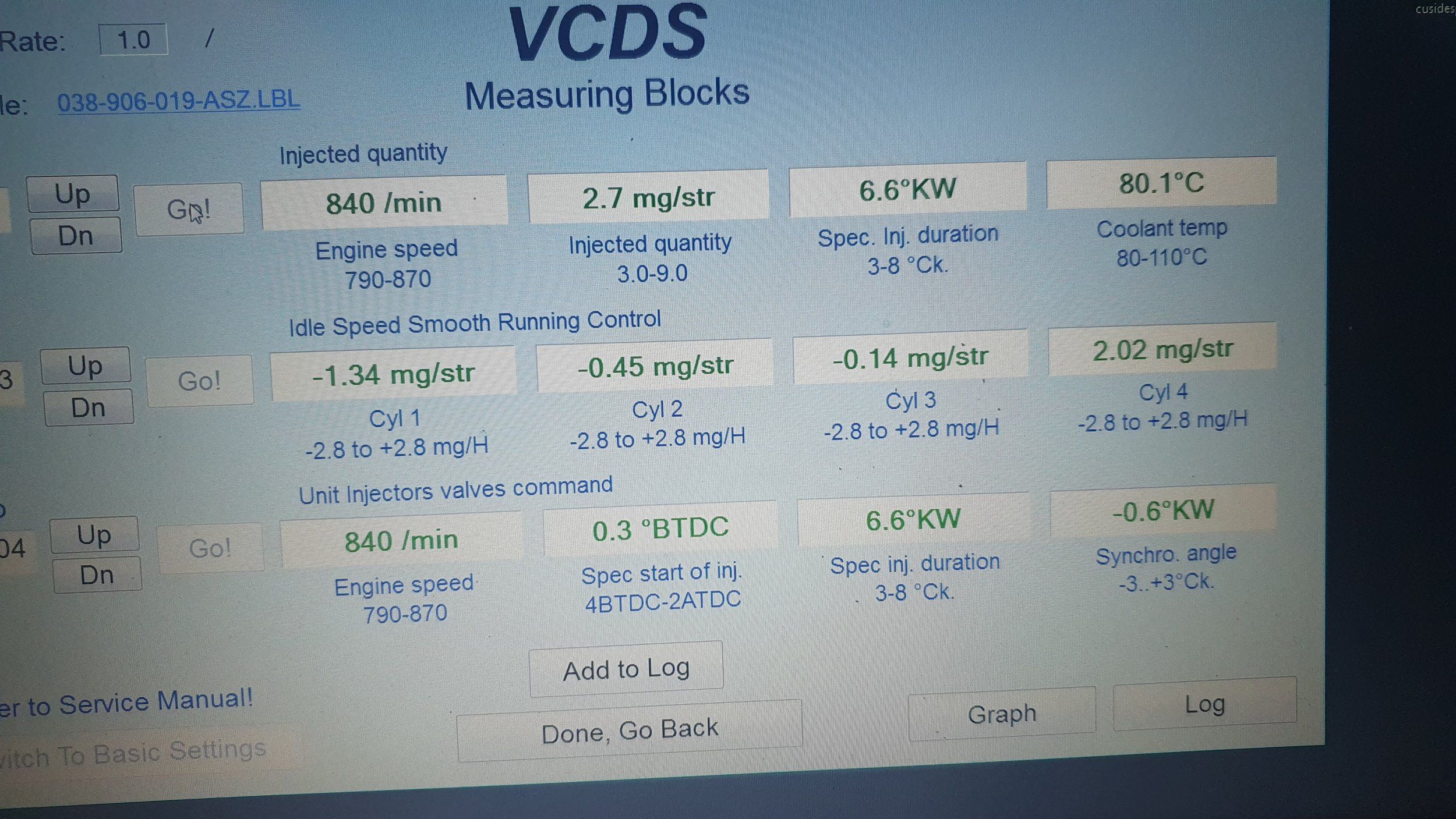

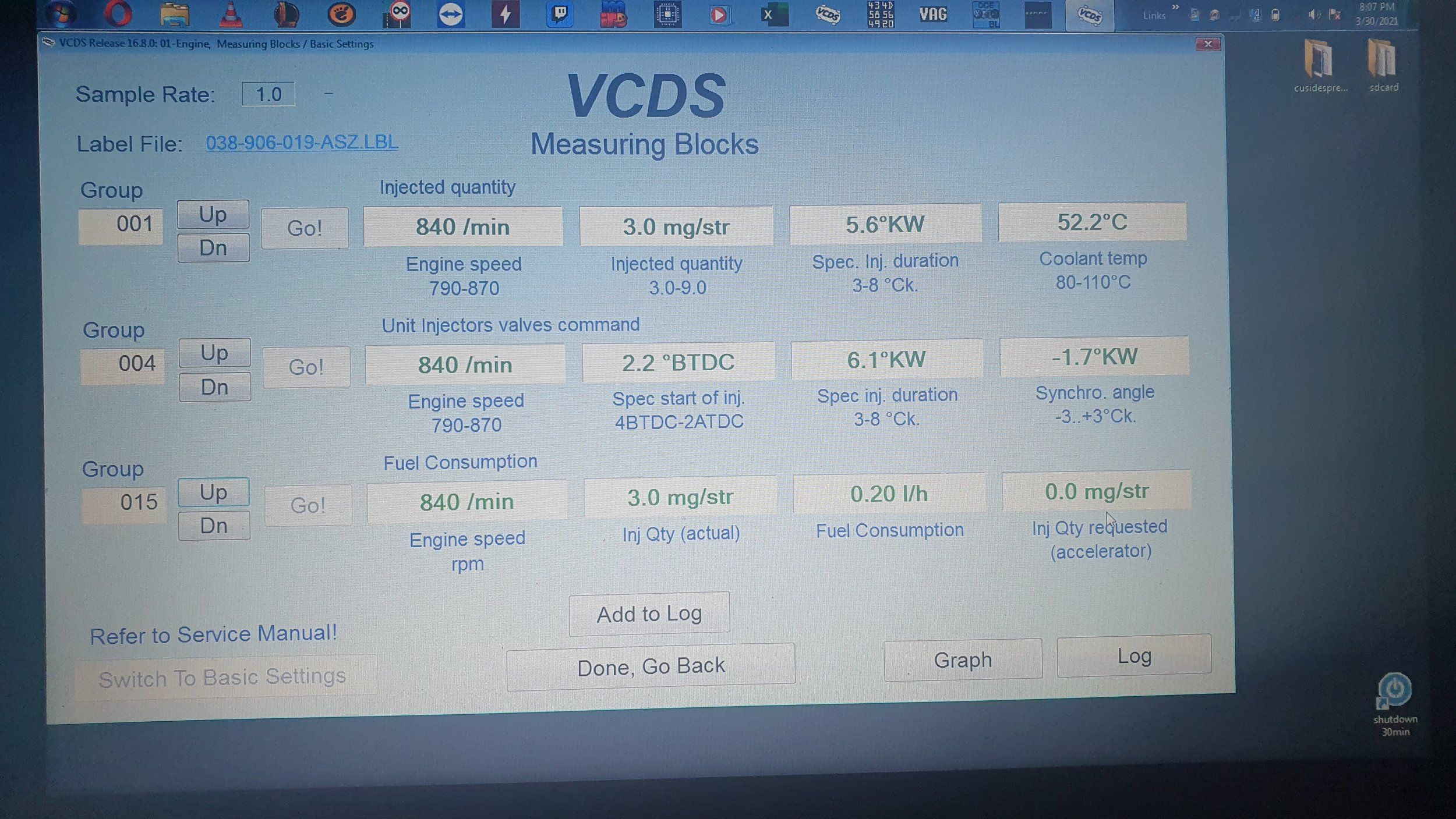

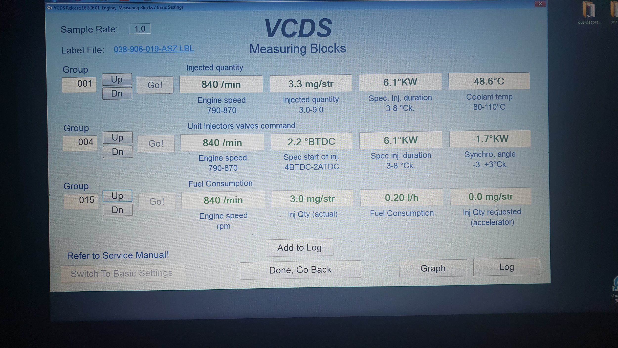

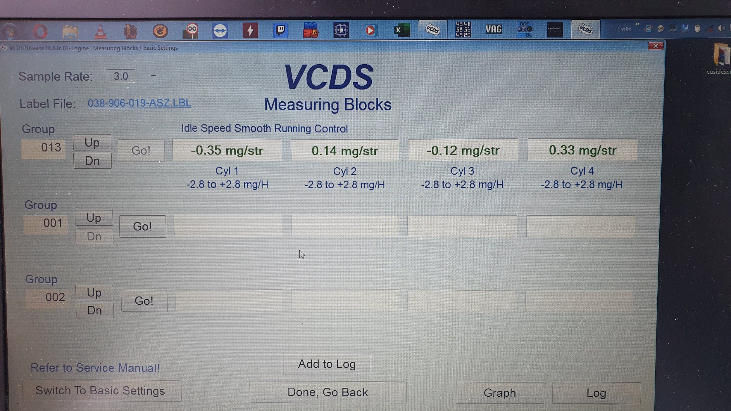

Hi guys! I really need some help if you can!
My Ibiza Fr has a very strage behavior at idle, when started from cold all good, no smoke, no strage sounds nothing, letting her idle for 2 to 5 min and thing go out of hand. No errors related to engine malfunctions or so.
1. Idle consuption go far down to 0.3l/h(somethimes 0.2) and 2.2, 2.8mg str(somethimes under 2mg str) injected at idle(too low)
2. Injector 4 correction incresed as engine get warmer, i've seen even 2.02 corection on injector 4 (changed yesterday with a good know injector same code BA, no difference)
3. timing belt was done 3 days ago with blocking tools, all good torsion value after tb change -0.6 0 +0.6 depends on engine temp(i've tried to play with torsion values but there was very little to non in injection department)
4. camshaft and lifters are in very good shape.
5. Temperature sensors are good I think.
first image is with a new timing belt, others image is with the old one with changed torsion values.
As you can see when cold injectors got good values.
if you have more question I'm here.
Thanks and have a nice day!!!

Update: Disconnected EGR, NO CEL, disconnected MAF NO CEL, map is stock so how doesnt trow a cel? Any ideeas?

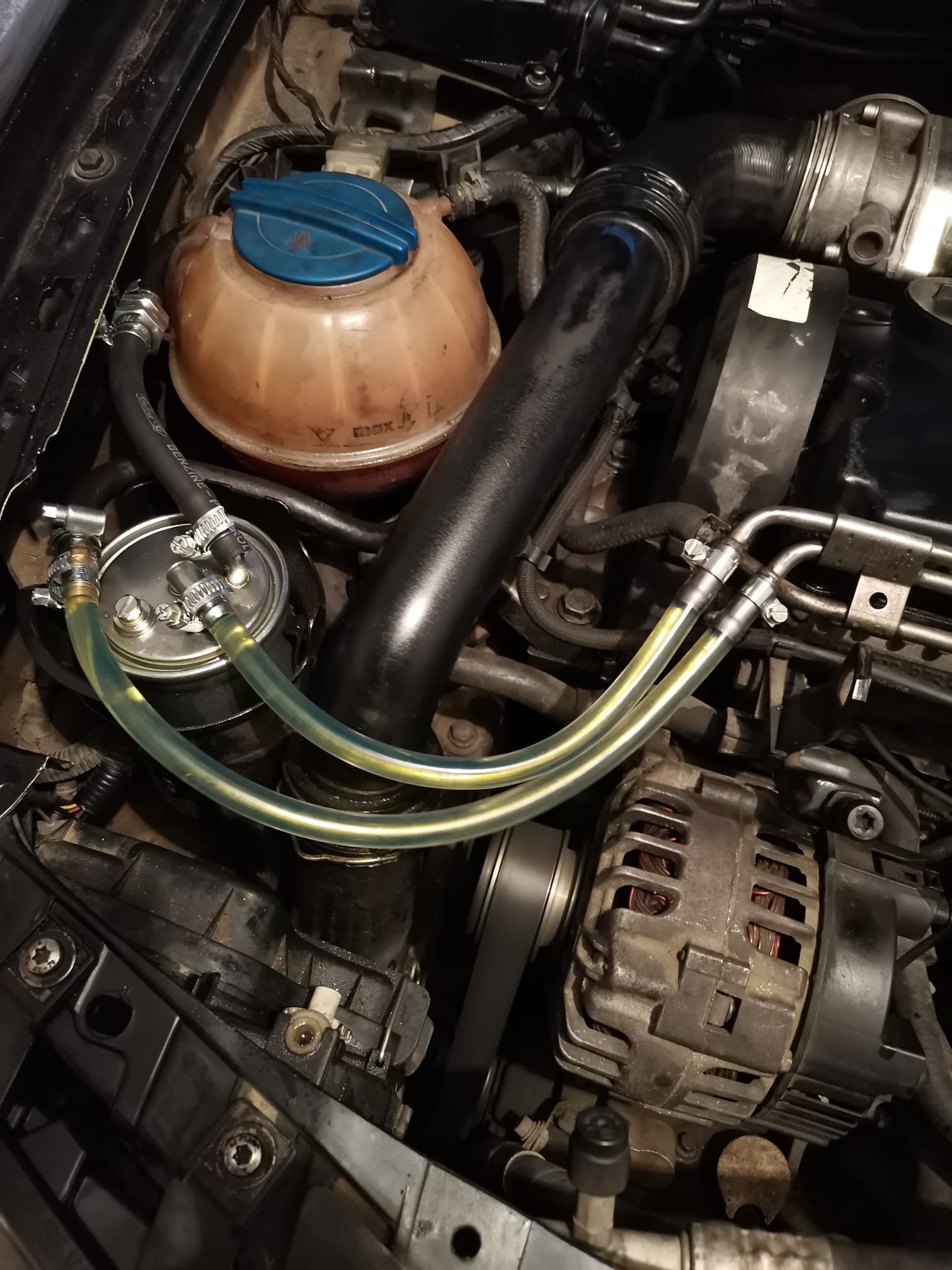

You could put a see thru(transparent) hose into inlet fuel hose where the fuel goes to the engine, so you can be sure that engine is starving from fuel.
What about tandem pump? If I remember corectly you've change it no?
It's ok, you need to try to put transparent hose as feedline to see how much fuel you lose.
I try with transparent and 2 hose is full with fuel and when start car after 6-7 hours from unnecessary hose i see bubbles air
if you see air bubbles, thats the problem, you need to find where air get in the fuel system. or put a unisens valve on the feed hose and see what happens.
