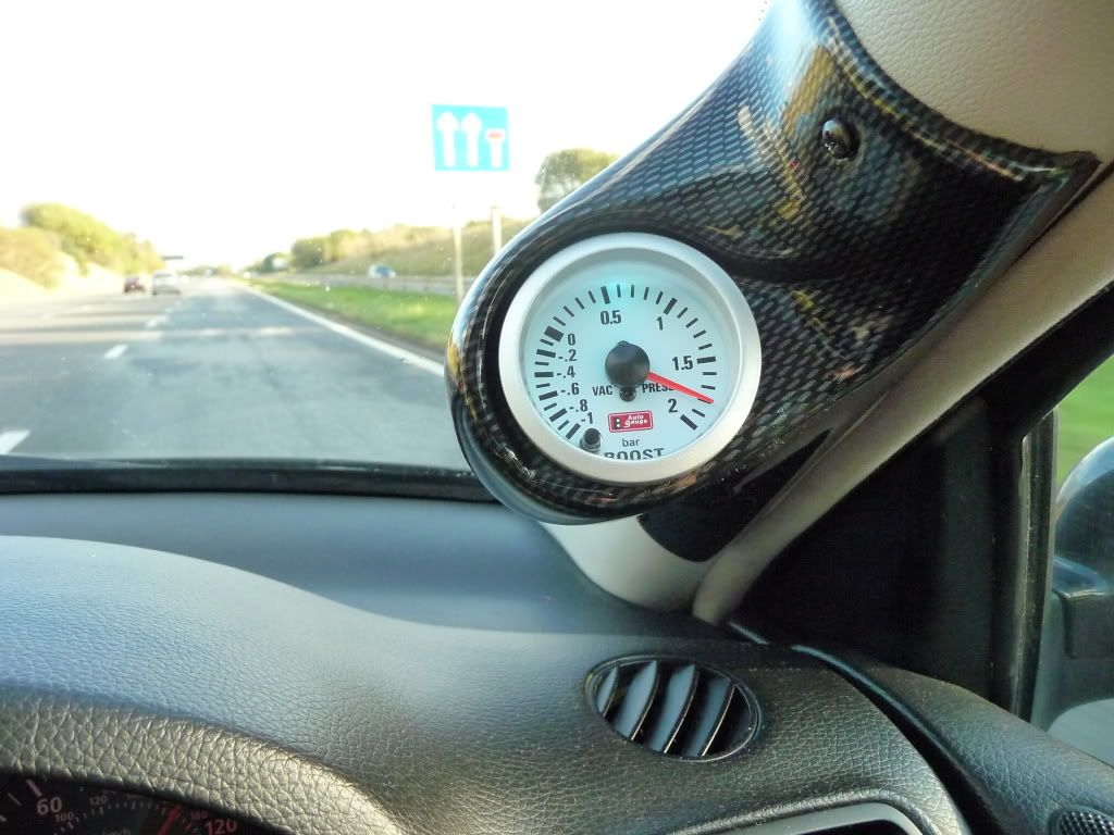

It seems to have made little differance but the needel on the boost gague seems to move a little smoother up n down (?) .

OOPs ! lol didnt see that , but the road you see in front of me is my driveway lol ( diclaimer )
