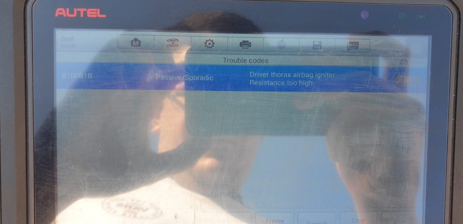

I went to get some new shoes for the car after the MOT also said that my front left tyre had a worse hairline than me, and was so bald Mystic Meg could see the future in it. The wicked bloke there was like "what's with the light on the dash?" and got his diagnostic tool out and showed me the error code: B100B1B
I'll be honest, I ain't got the foggiest when it comes to any of this, but I don't mind cracking out a spanner if I need to, I just don't want to get absolutely shafted.

that fault code is to do with the passenger airbag resistance being too high. Sound very expensive to fix
with it being high resistance maybe a loose plug on the back of the airbag, sounds like a nightmare and not one i would choose to play about with myself, basically a small bomb

Quick google have a check of the wiring / plugs below the front seats, make sure they are plugged in correctly / no damage to wires.
high resistance is the code which would indicate open circuit / slack connection so maybe an ill fitting plug or been disconnected by someones feet in the inadvertantly in the rear footwell.

Once the open circuit issue is resolved, the fault will still appear on the dash until it is cleared with ODIS (manufacturer’s diagnostic tool), professional code reader or VCDS (or equivalent). The cheaper diagnostic tools will not clear this fault.
