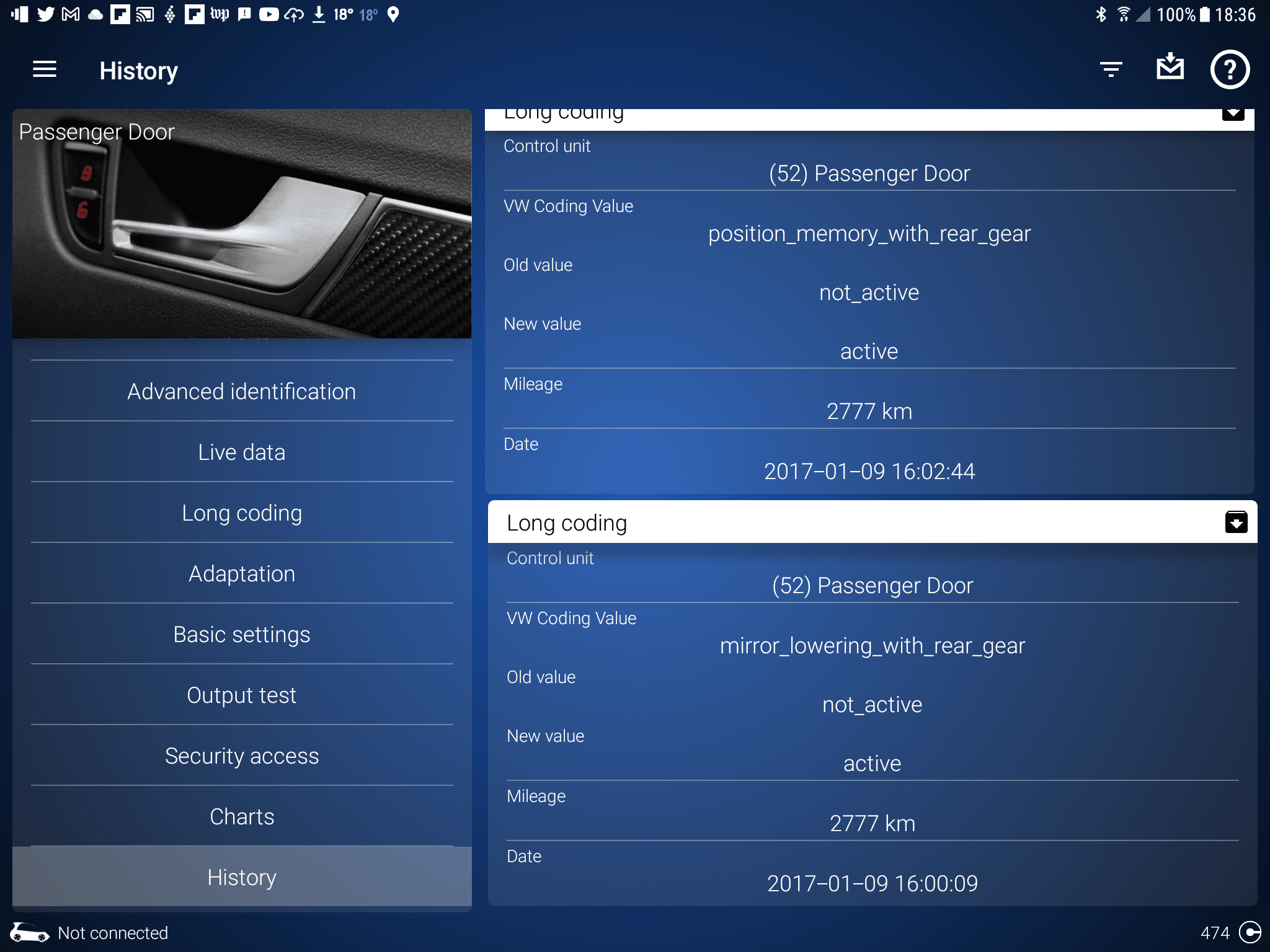

Has anybody got the reverse mirror to work? MY19
Ateca FR. I have enabled it on OBD Eleven, enabled it in the car menu but still doesn't work.
www.seatcupra.net
You get the live data. When I did it for Andrew JB it showed that it didn't have the correct motor in. Mirror Dip is a lot of puff if your car isn't equipped with it since you may not have the supporting VAG component in it. That test, tests for it.
On a LHD car you turn the mirror switch to R after the coding mod and ticked the mirror dip switch on the infotainment screen. RHD, to R. Select reverse it dips. If incorrect parts it drifts with repeated use. I'd say the
