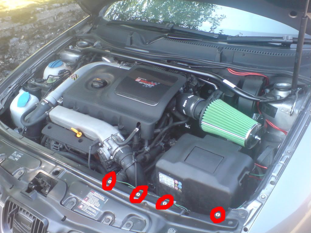

if it is the drivers side you should be ok, if it is the passenger side there are a few bits of plastic that need removing, 4 screws only from memory though - but even then it is tight!
yes it is the passenger side, i thought it may of been the for screws that are on the top to take it off, any pics??
yep, those 4 screws and then the plastic slides upwards:
(the plastic covers were not on mine when i took this photo)
i have quickly took the plastic parts off, but i dont find any way of getting my hand in there to change the buld, will try and take some pics in a bit as its freezing out there
