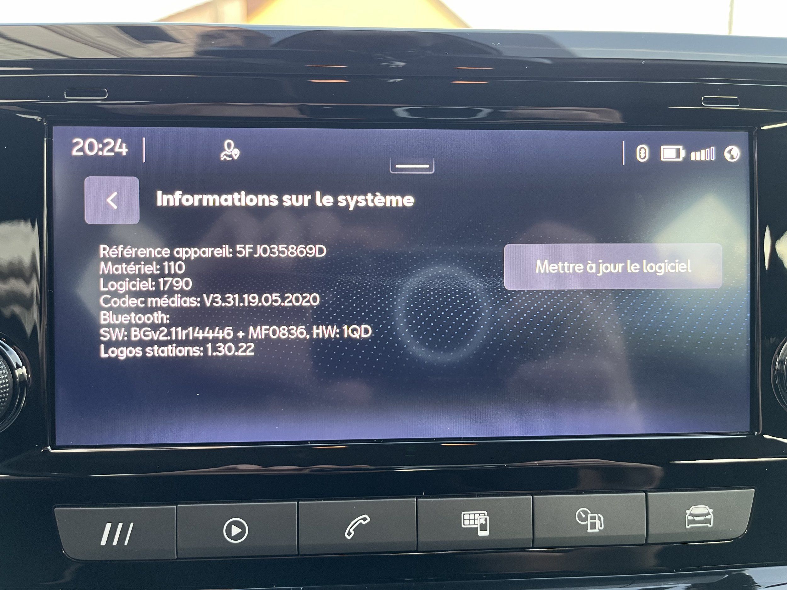

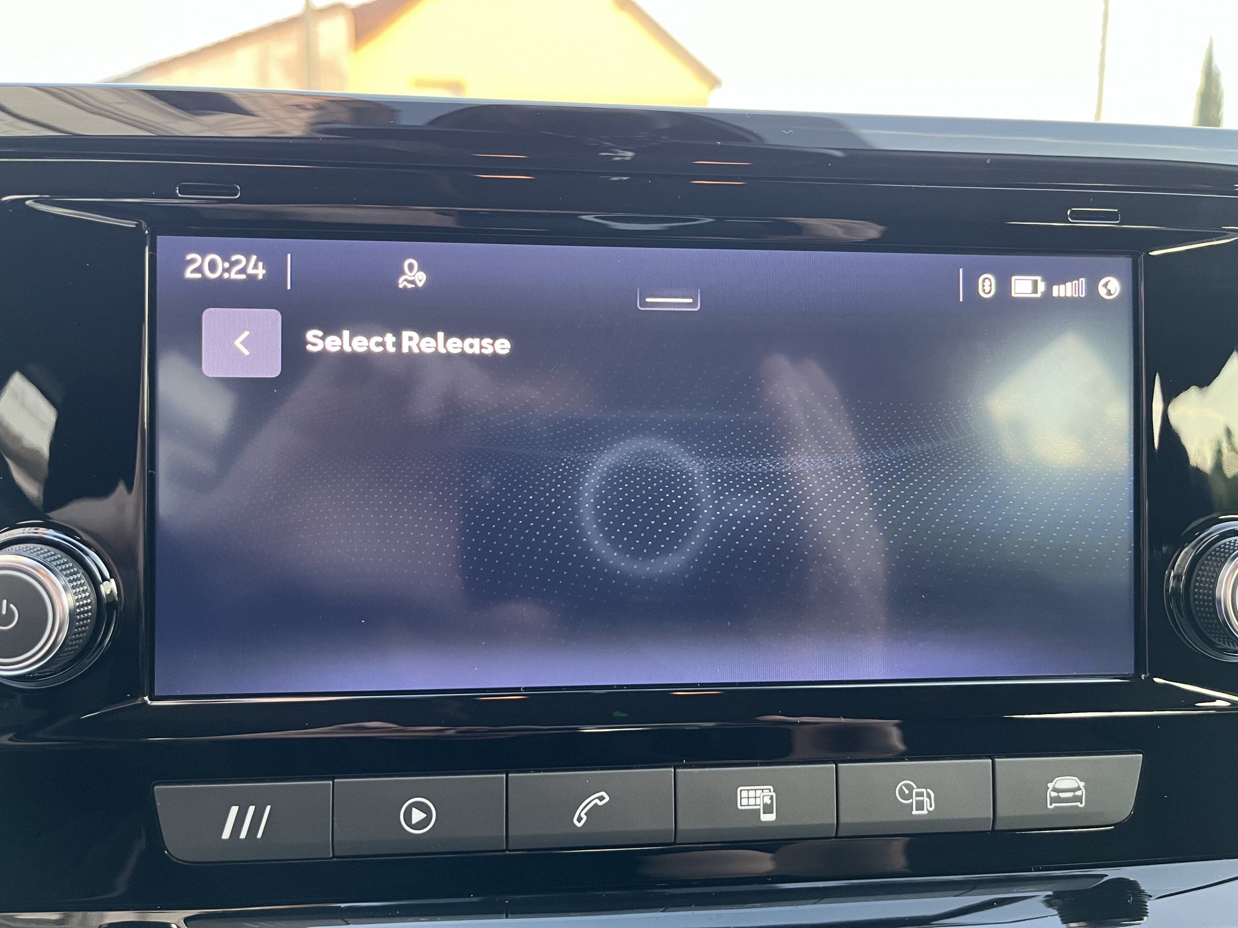

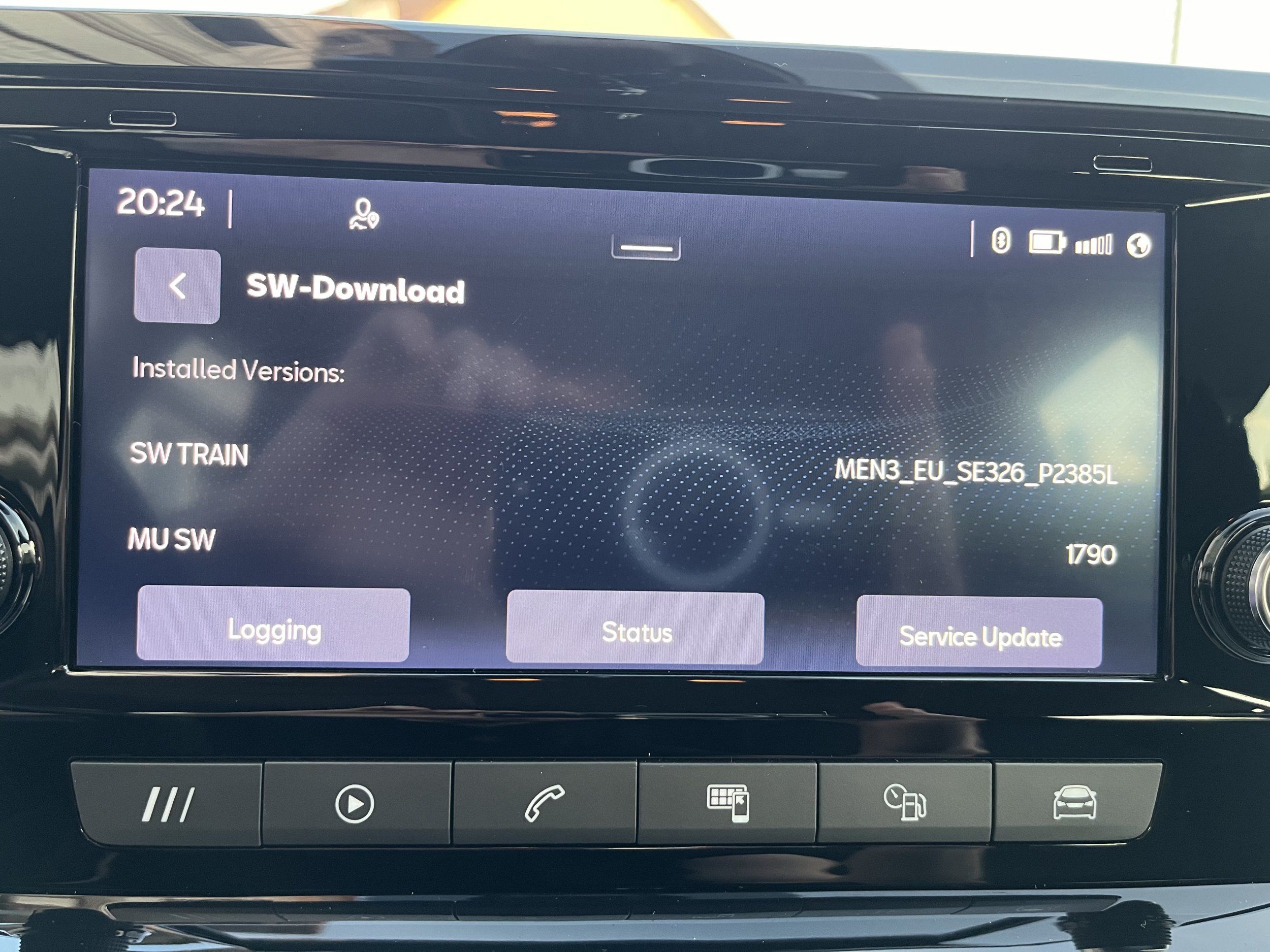

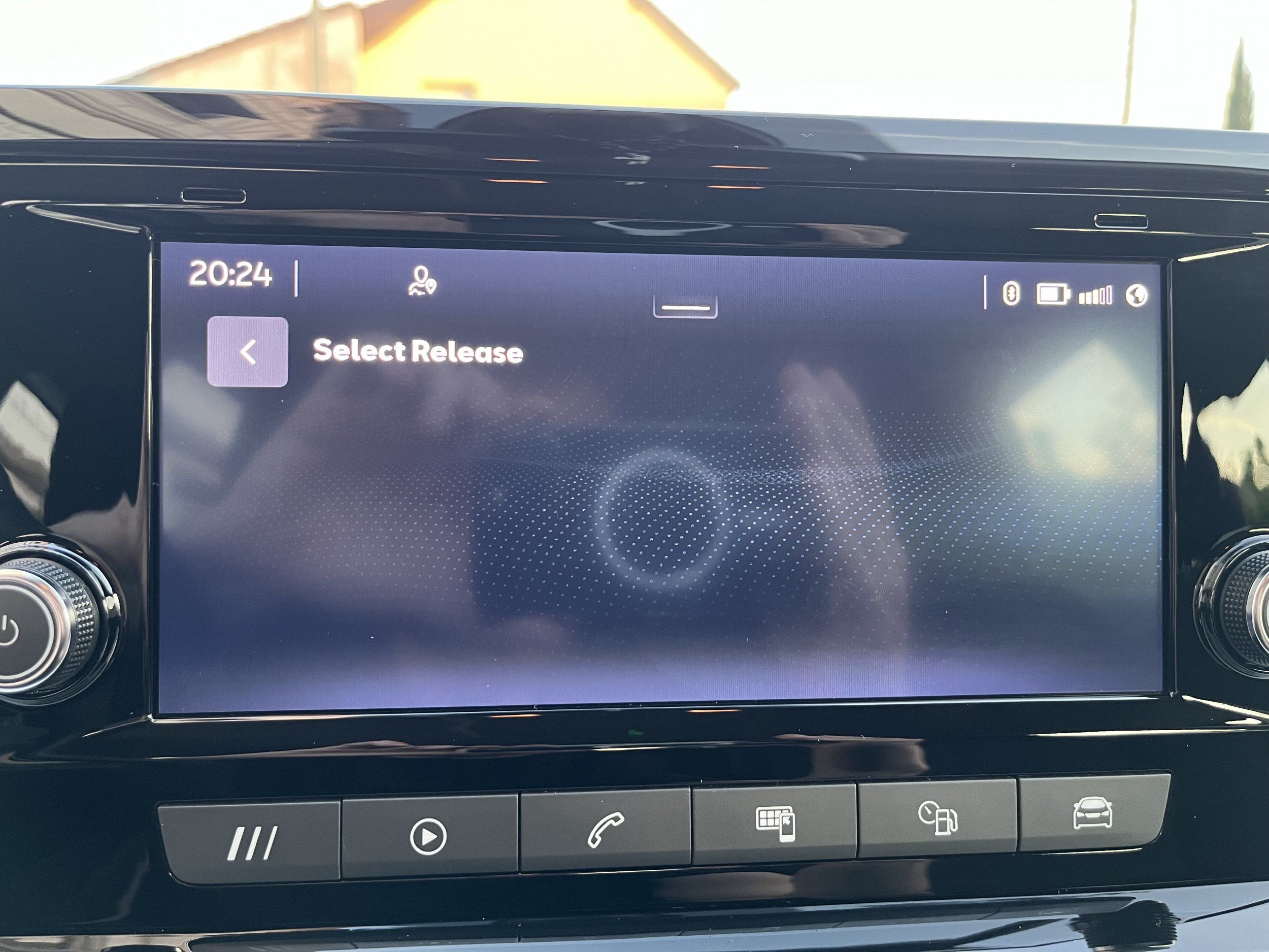

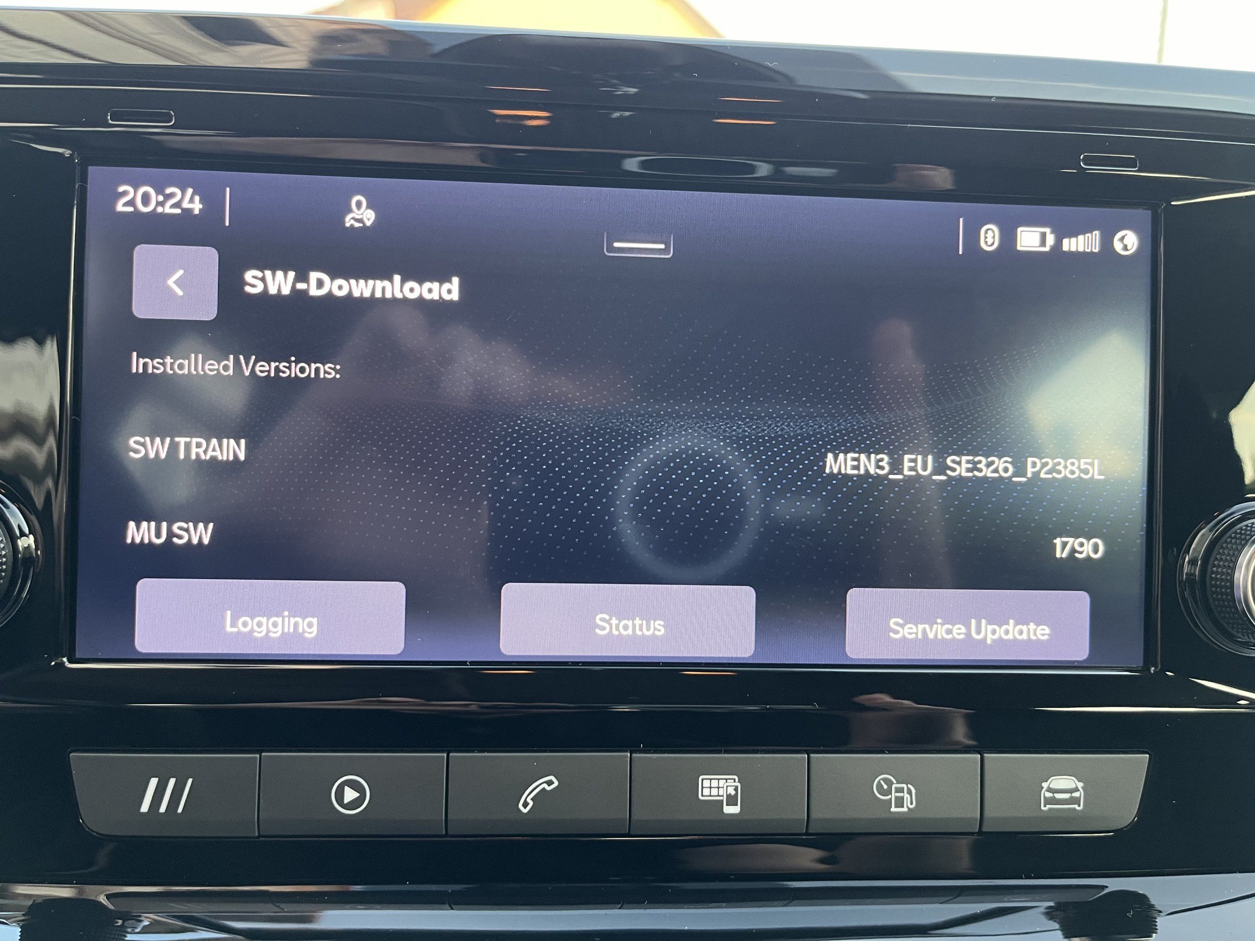

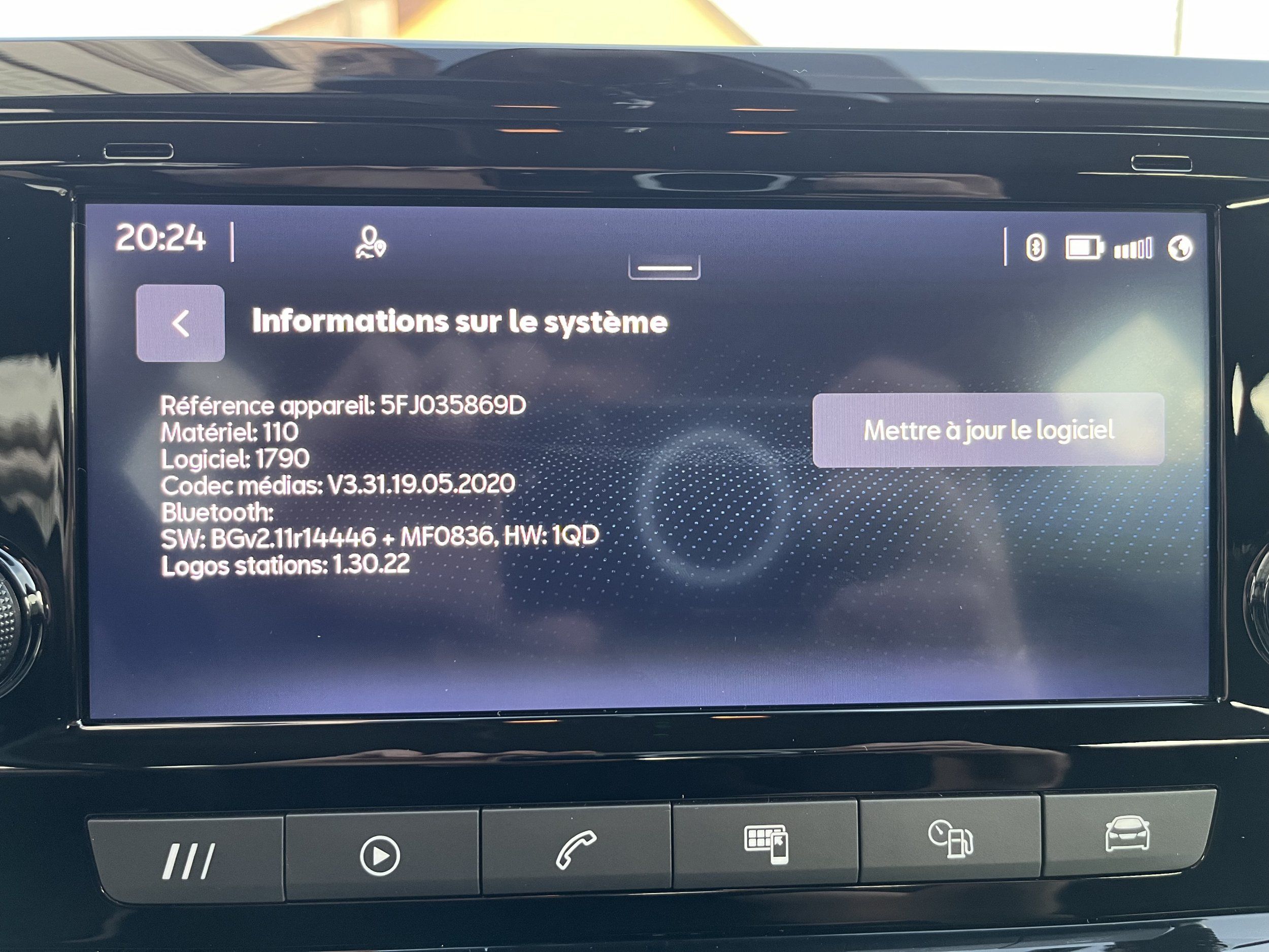

Hi,
Today I tried to update the infotainment system of my Ibiza 2023 due to the famous "CarPlay-not-fullscreen" bug and many others like unable to volume up when playing music from an USB drive, album cover art not showing on speedometer, etc... After searching on the internet I found an update file but I have an issue. (On MIB-Solution.one)
When I go to the service menu -> service update -> load from local USB, the files are not appearing (Data and Meta folders). But the USB sticks are showing in the media menu.
I tried with USB sticks formatted in FAT32 and exFAT on a Mac and on a Windows PC.
Here some photos.
Can you help me ? Thanks in advance
PS : My English is not the best, sorry...

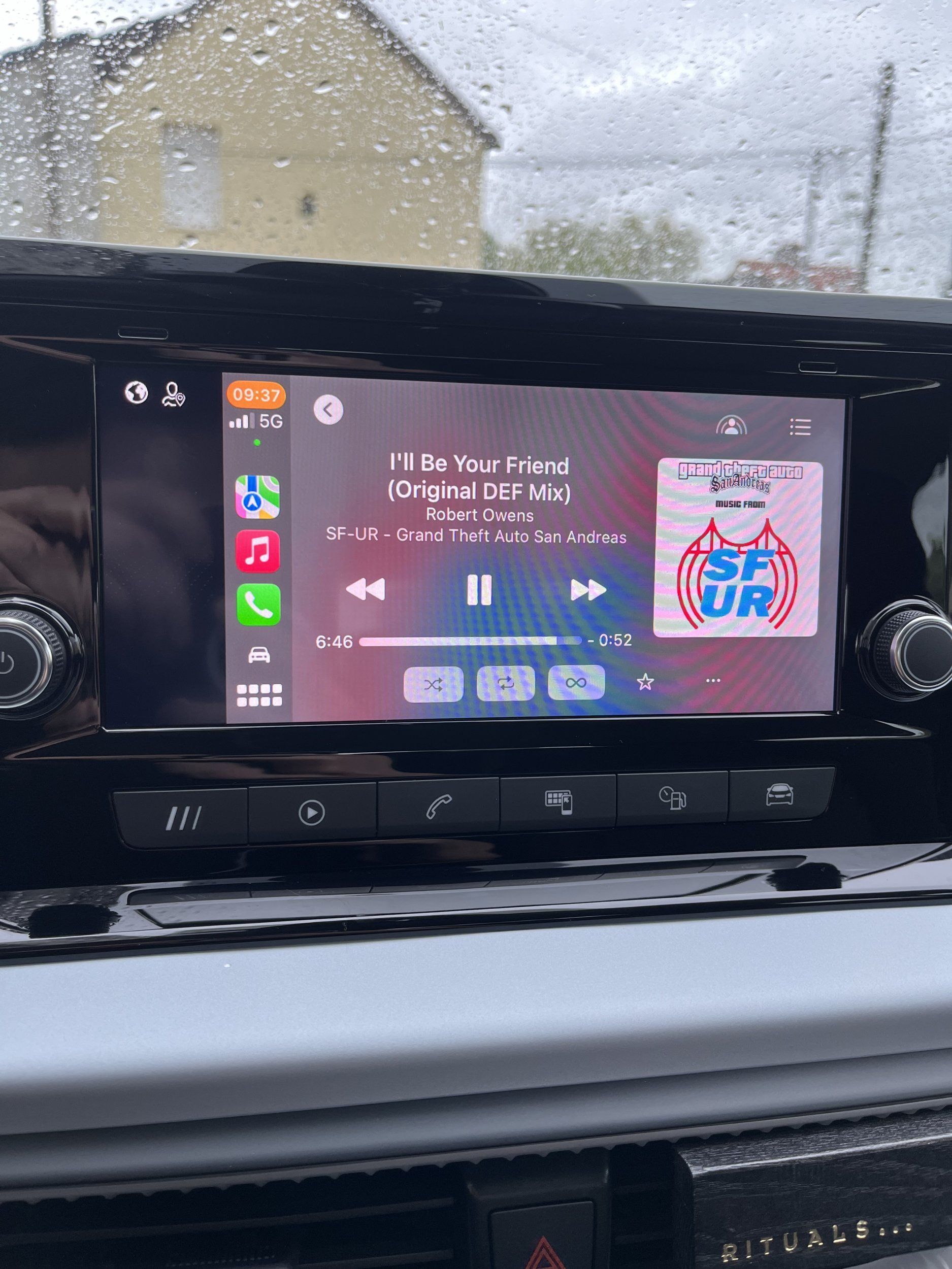

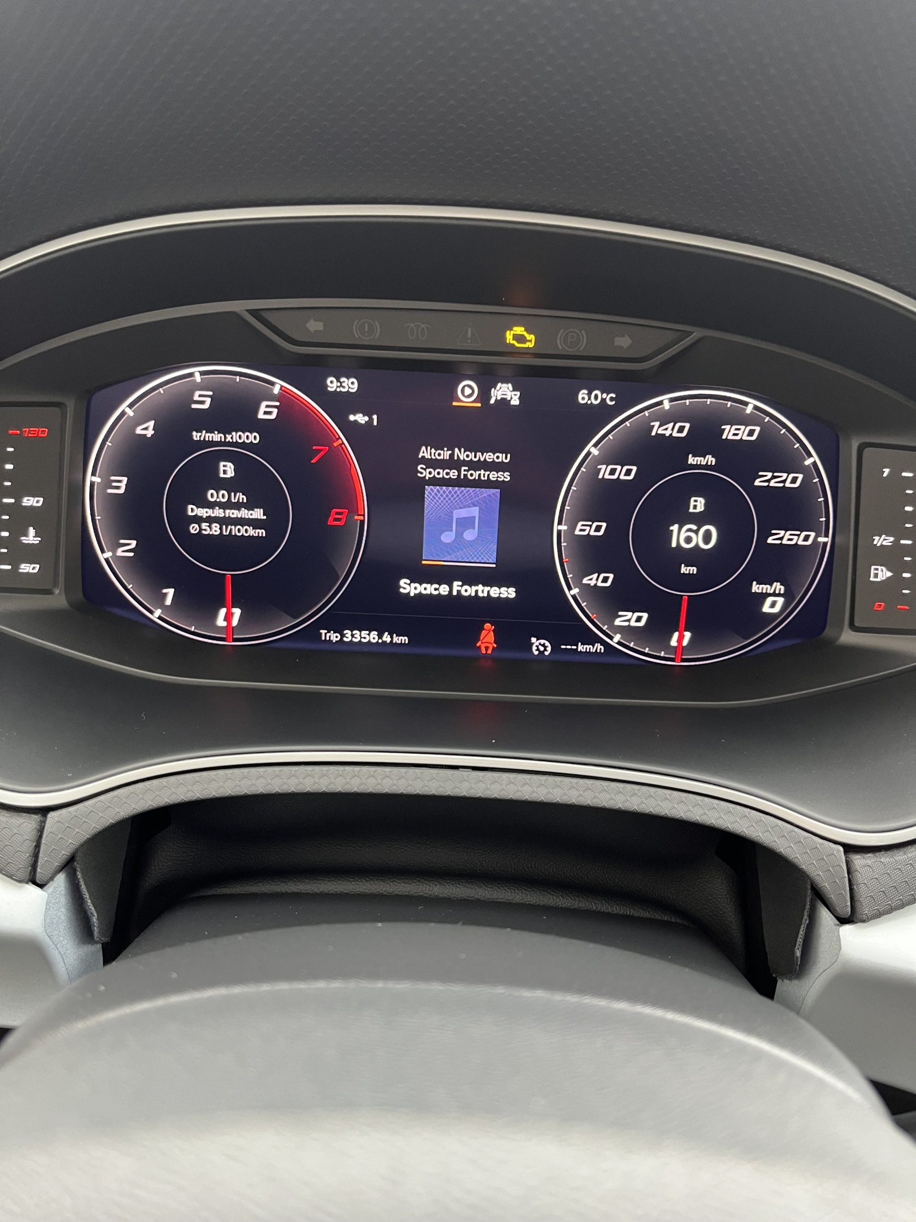

Little update, the update worked, thanks to East Yorkshire Retrofits for the info !
But, it is useless. Nothing is fixed. The interface is still lagging, CarPlay is still a mess, the cover arts on the speedometer don't work (USB or Bluetooth). If you want to do the update to fix these things don't waste your time. Here some pictures taken after the update :

Hi,
Here some photos.
View attachment 42091View attachment 42092View attachment 42093
Hi iSlick, where did you find the software update to download for your car?
Do you have a link for me?
Assuming you're trying to update to 1805 - Insert the "meta" and "data" folders into a folder named MEN3_EU_SE326_P3385L

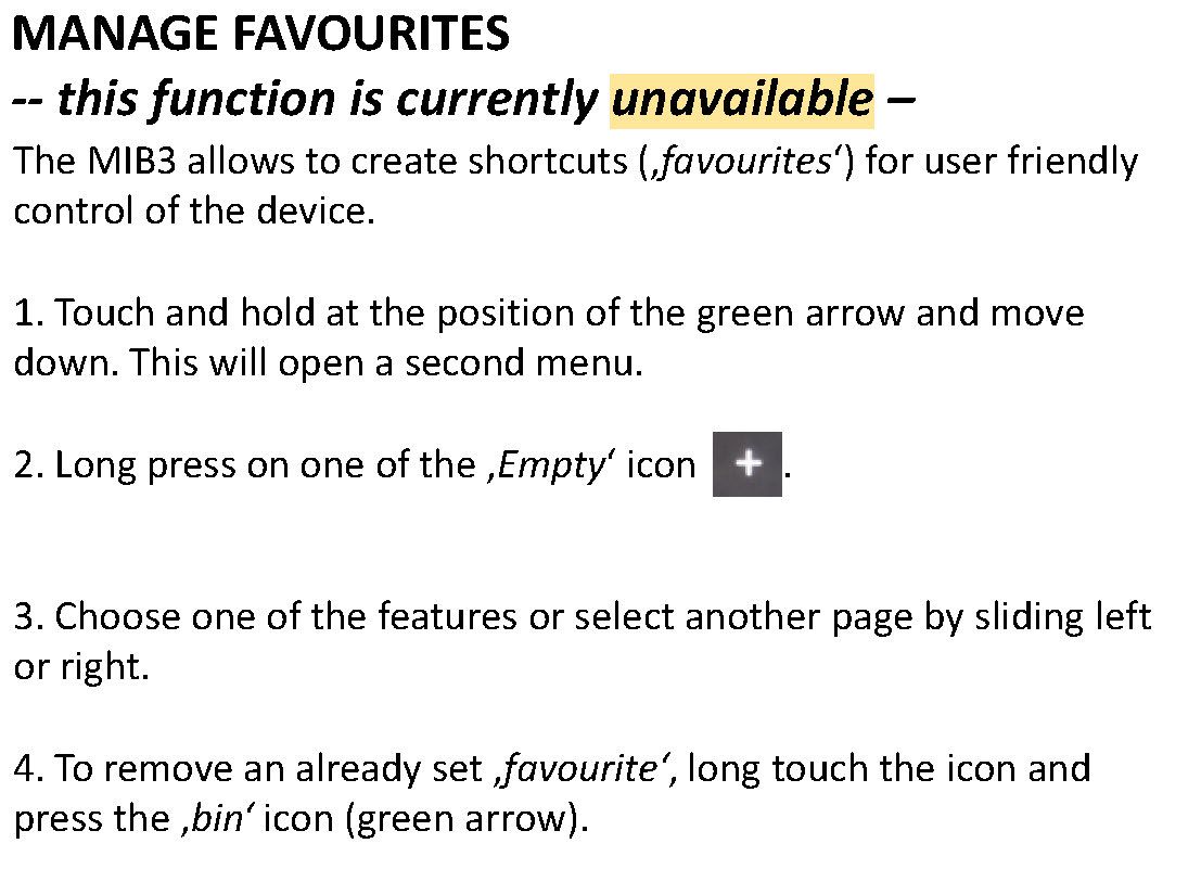

Hello. I want to manage Favorites on my MIB3E, but the functions seems to be ,,curently unavailble,, . Someone know how to activate this Menu?
