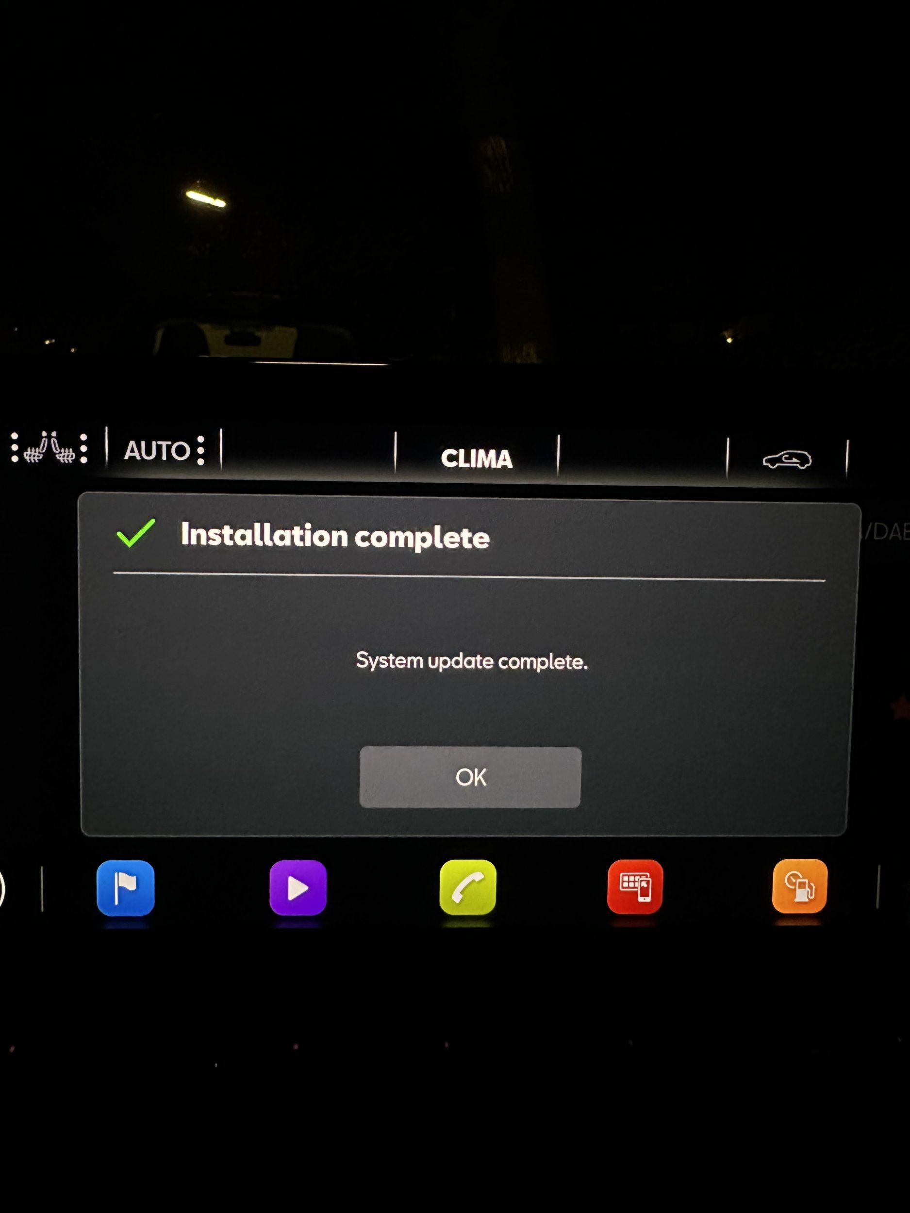

After the latest OTA which was 2.3Gb, this issue with infotainment restarting 15-30sec after starting the car seems to be fixed now. Also that update brought up a nicer resolution for the infotainment which I find it very cool.

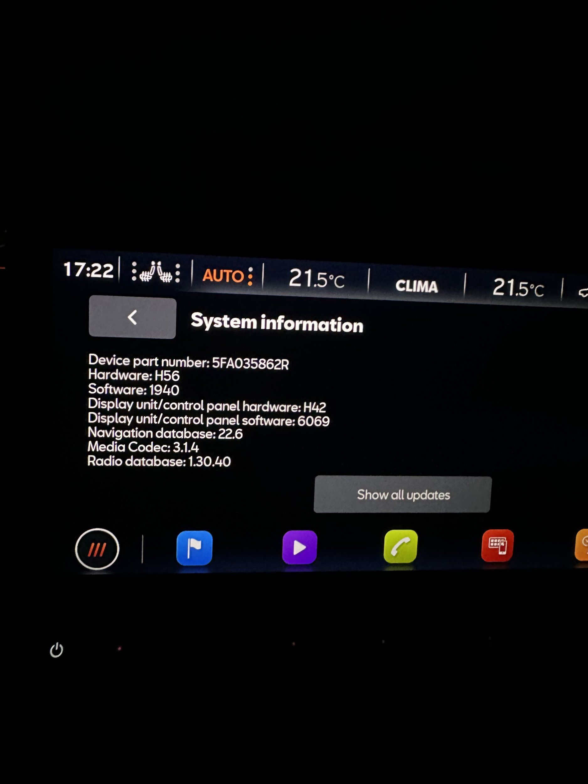

Took the Tormentor in as I was getting a periodic 'Maneuver Braking Not Available' when starting and the light would disappear after a bit. Plus I had 1899 and thought it might be related.
Deal said no issue with the braking, but he thought a software upgrade might help. I went up to 1940 and then they told me it wasn't correctly calling HQ to advise this VIN had an upgrade, but it might be there end. However, he did tell me a new fault had shown that the overhead light/SOS unit needed to be replaced. How odd it didn't show when they first plugged it in....anyway we'll see how it goes.

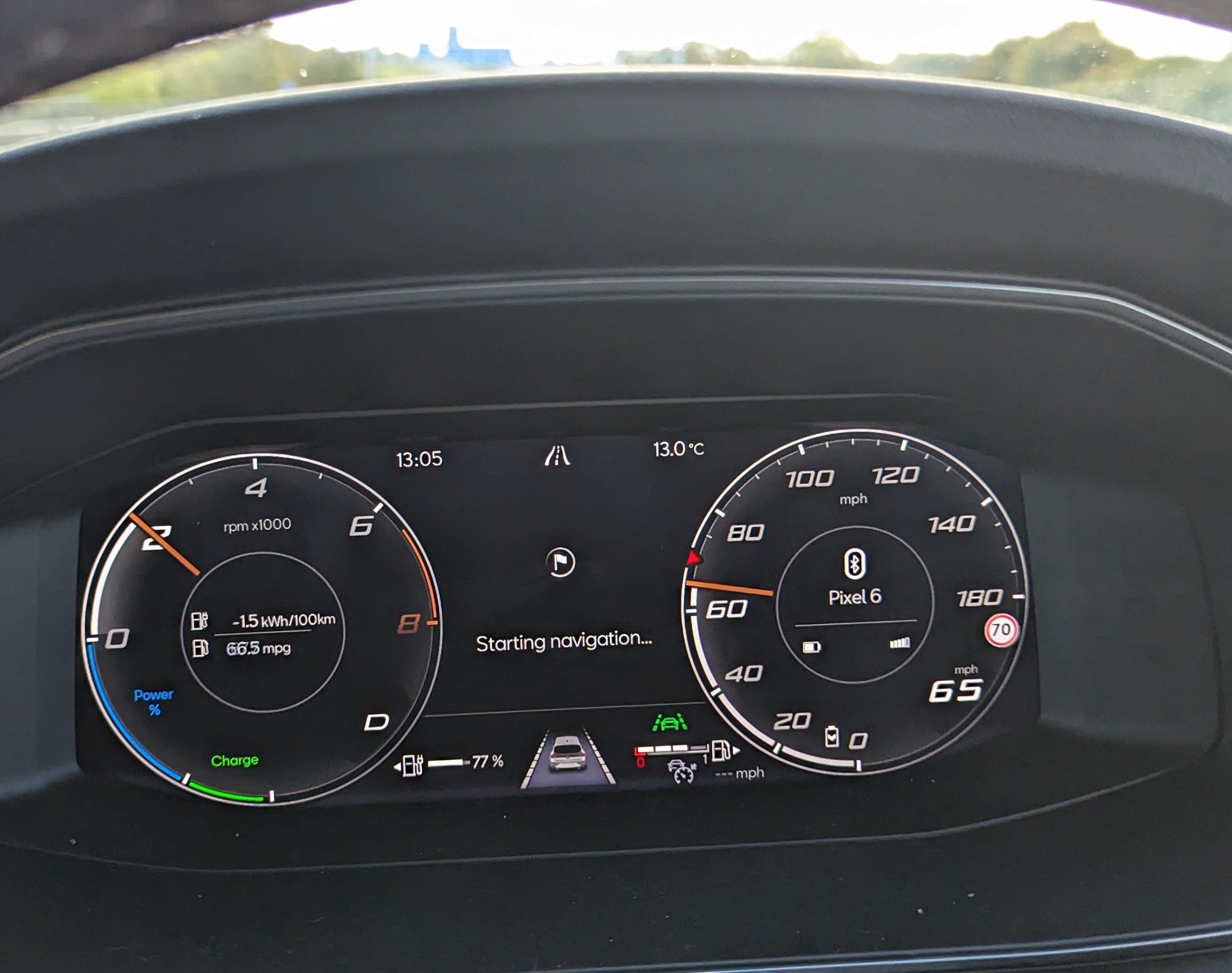

My 2022 build Formentor has been rebooting on and off for a few months now. I’ve mostly ignored it as it only does it once or twice at the start of a trip, and very few and far between.
However, today I took a trip to the shop and it rebooted none stop all the way there. Once it rebooted, loads of lights on the dash, parking sensors not available, manoeuvre braking not available, road sign recognition not available, SOS error, visit workshop, amongst others!
Got to the shop and the infotainment finally died. Screen completely black and couldn’t even reset by holding the power button down. Dash lit up like a Christmas tree.

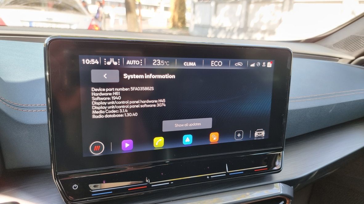

My car is back. Was a very quick turnaround. Seems to now be sorted and more responsive.
Things noticed so far moving to 1940 - parking sensor bongs are different sounding now and the CarPlay resolution is higher. That’ll take some getting used to!
