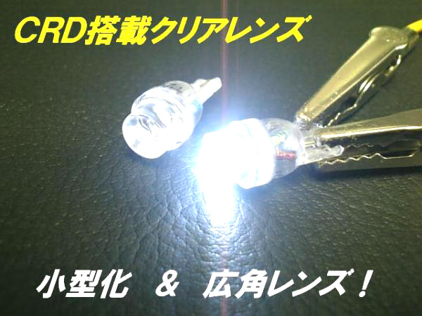

might try getting a pair of LED sidelights - cheap enough to give it a try !!
Or these:
Anyone had any success matching cheap LED sidelights to HID look ?

Lads lads lads, if you want a sidelight to match the HID colour.. get these
Wedge Sidelight SMT LED
I have a set in mine and Jonjay has seen them in the flesh and even he said it matches the HID colour! ;)
Little expensive you may say, but you get what you pay for here!!
A little note thou also, i use Ultra Leds for all my leds, getting all my festoons from there next week also! :D

Chris, i got mine from Demon Tweeks, but they have recently changed the website so i couldn't find them, but wanted to get a link to them so you could see what they were like and read up on them.
The second pic in the post with 2 pics..... AVOID. i bought 2 sets of them and the first set lasted 2 weeks before 1 bulb blew, and the second set blew a bulb the min i fitted them, so i bought the PIAA ones as they were better quality. So far been spot on.
