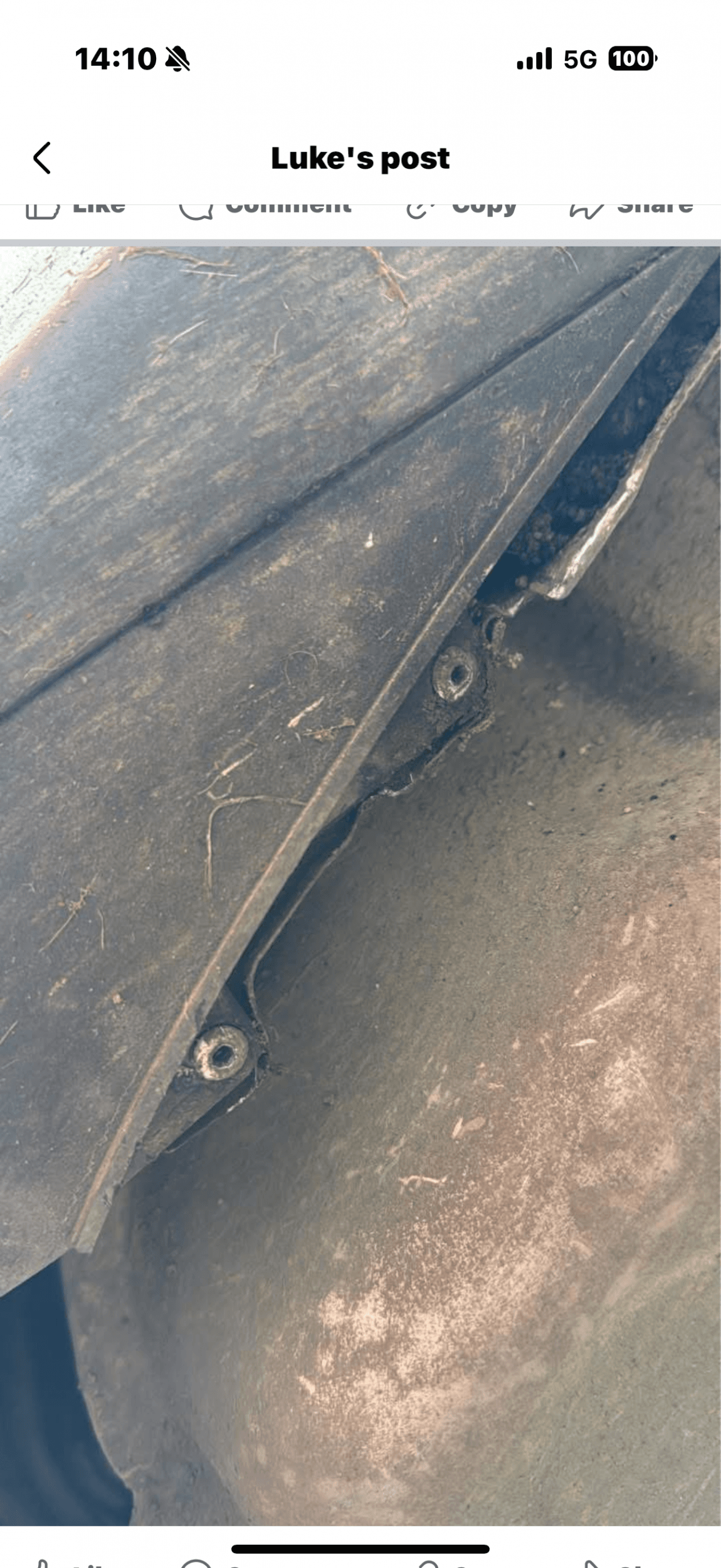

For anyone coming across this post with the same issue...
You will need to drill out 4 rivets (2 on each side) and remove 2 screws at which point the diffuser will just pull straight off with a little force.

Hello, having the same issue is it the same rivets as these you had on yours?
