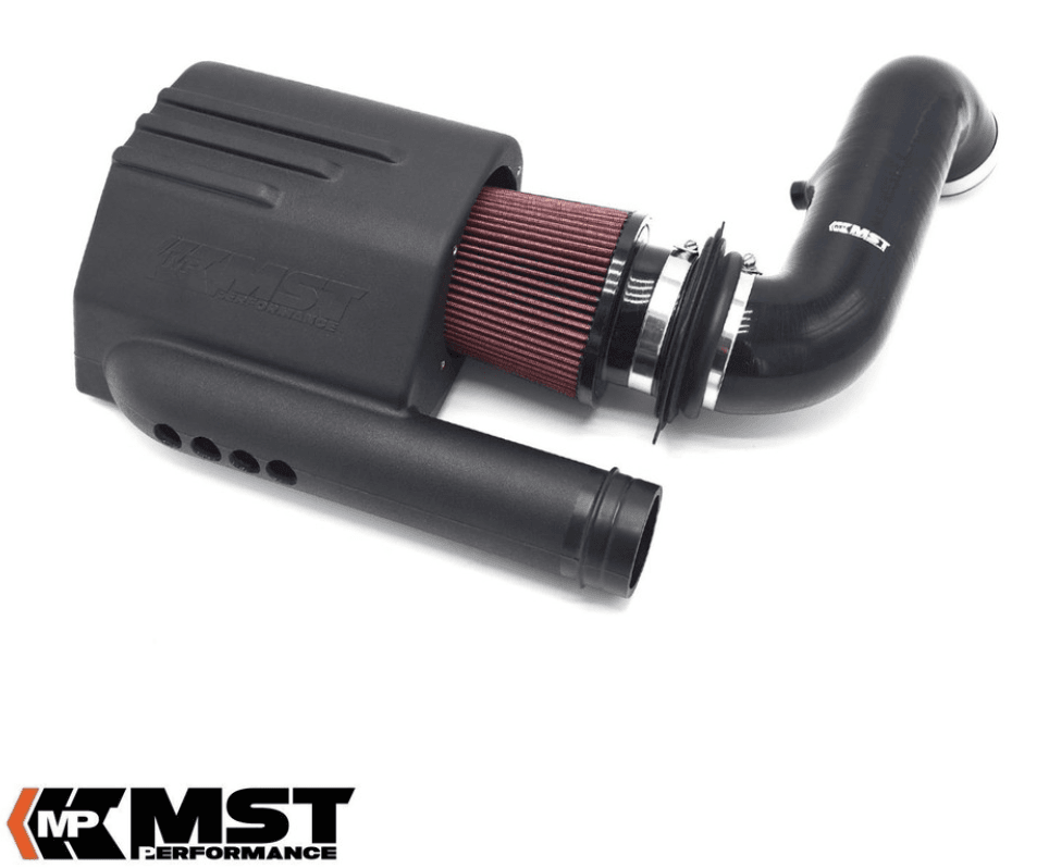

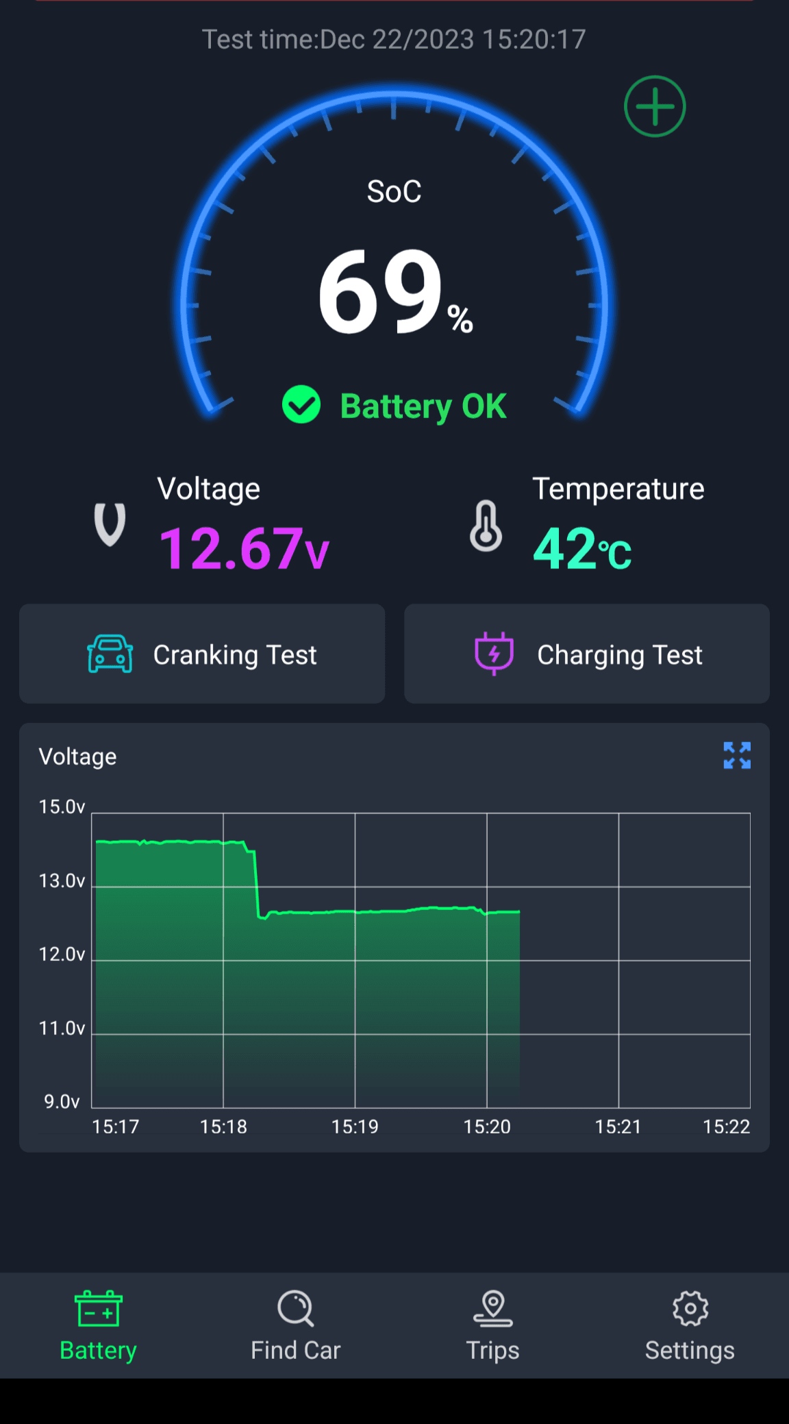

I'm about to buy the MST one in January and have been thinking about this myself. My current intake temp gets to 54°c checked using Torque Pro and a generic ODB2 BT reader. I have a temp reader on my battery monitor and it says the engine bay temp is around 42°C (motorway driving for 1 hour).
I'm looking at getting either of these two so I'll let you know if you haven't already got one.

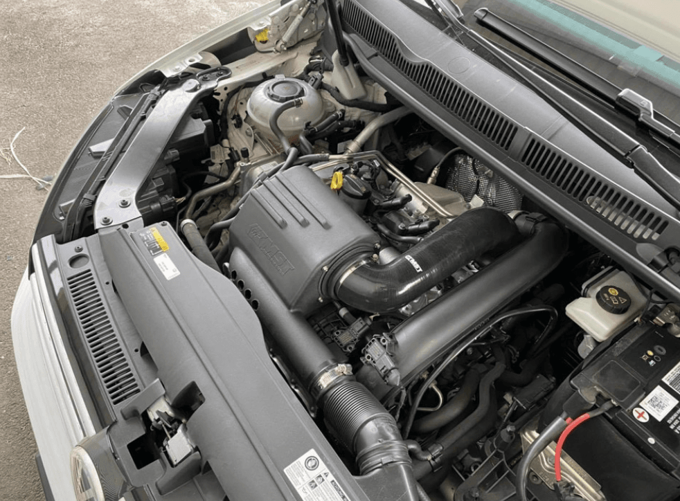

Open Induction Kit

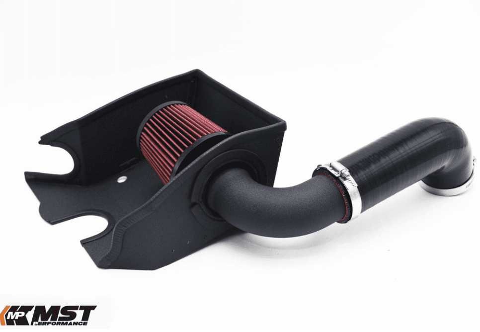

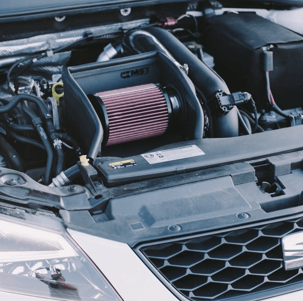

Closed Induction Kit

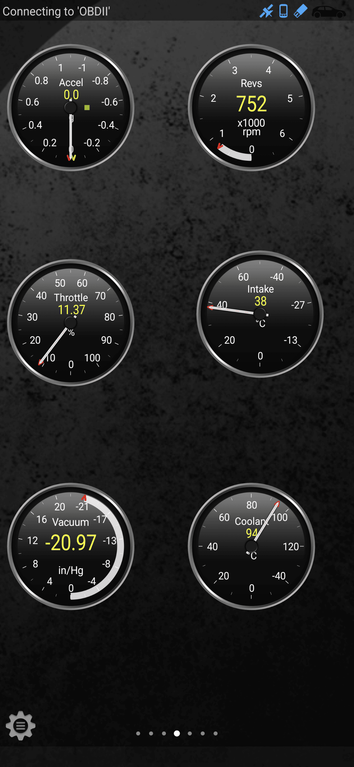

Did what you said. The intake reached 38⁰ and outside temp way 15⁰. The only thing is even with my foot to the floor the OBD2 reader said the throttle only ever reached 90%.

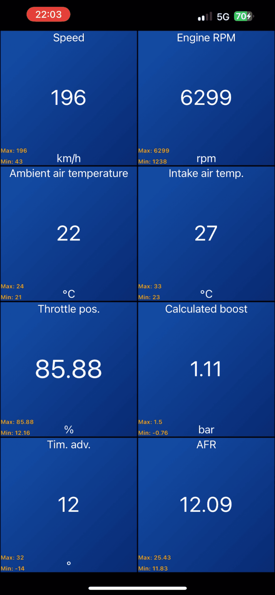

Look what I mean.
Full WOT
4th gear with 22 ambient I have 27 IAT
Typical IAT with stock IC was +15-25C°
You will never see 100% throttle position. Mine ends at 85.88%
