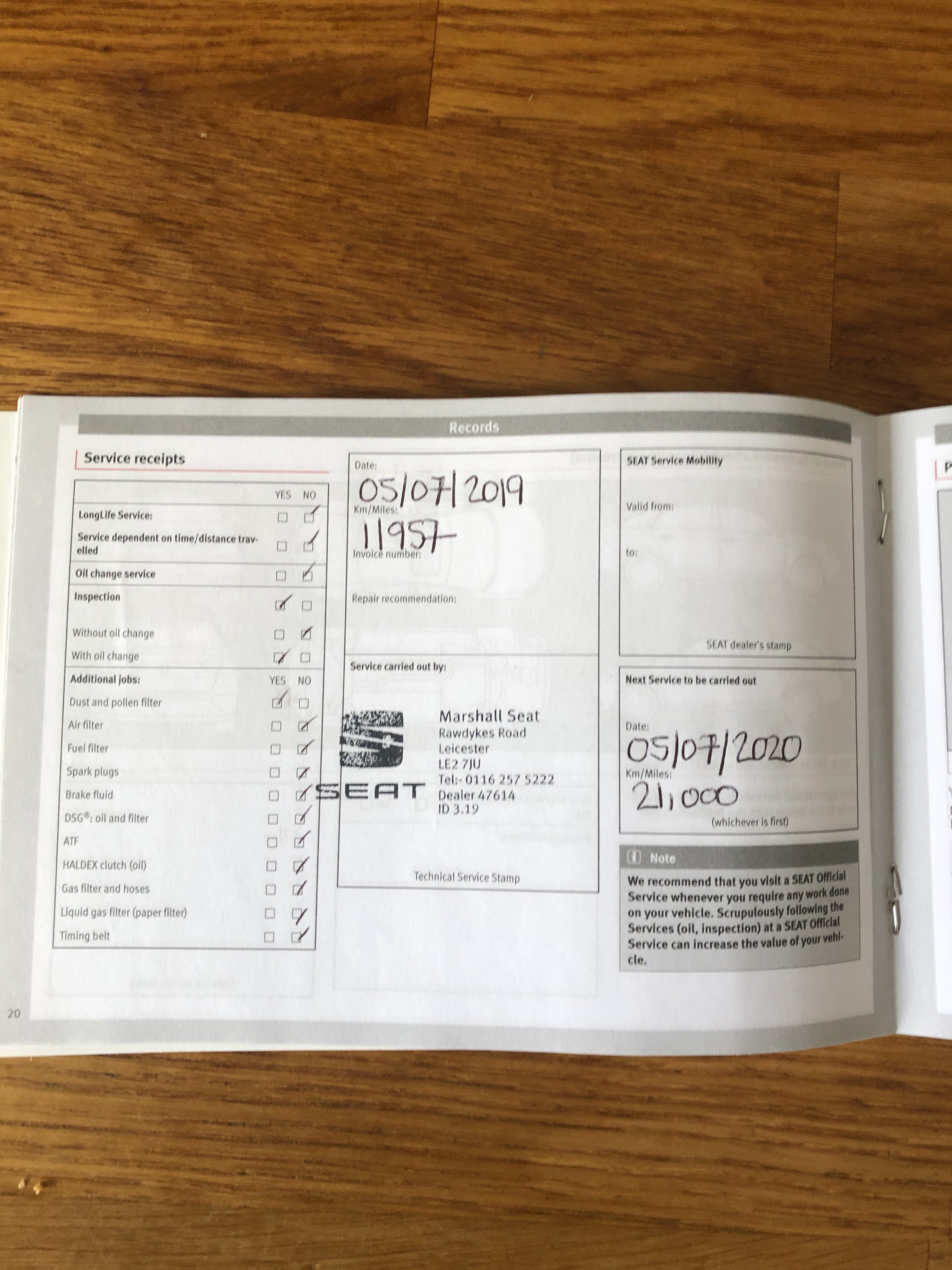

Hello sorry for the late reply, so iv owned the car since December 2019 so unsure what previously been done on it and only driven the above millage, so I’ll have to check maintenance book. My car is also a manual of this helps too.
edit:
Above picture is current service and mot which states to do next service at 21k miles but not near that yet, so debating whether just to get an MOT then as soon as I get to 21k have a service or just get interim and mot done
Even though you have not hit the desired mileage you are still close to the year mark so at the minimum I would an get oil and filter change
@Fortis; looking at the details of what was done at the last service in the picture you’ve posted, your car it didn’t have a brake fluid change. If it’s a 2016 car (seem to remember you’d previously posted in another thread your car’s a 2016 1.4 Leon) it was due one last year.
On VAG cars, the first brake fluid change is due when the car’s three years old and then every two years thereafter. Brake fluid changes aren’t mileage dependent, so I’d get it done when you get the MOT done, along with the oil and filter change if you decide to get those done too. I’d get the oil and filter changed as well at the same time, as the service due date is either 21k miles or 05/07/2020 whichever is first as per the text in brackets at the bottom of the ‘Next service to be carried out’ box that the service tech wrote the next ‘Service due’ mileage and date in.
Brilliant sounds like it’d have to be a full service then for all that, don’t think interim includes all that
@Fortis - As far as I’m aware, the brake fluid change is treated as a separate job - separate from either an oil and filter change (minor / interim) service or an oil and filter change + inspection (major / full) service. At least that’s how it works with VW; the cost of the brake fluid change isn’t included in the price charged for a major service; it’d be charged for on top of the cost of the service, so I’m assuming that’d the same for Seat.
