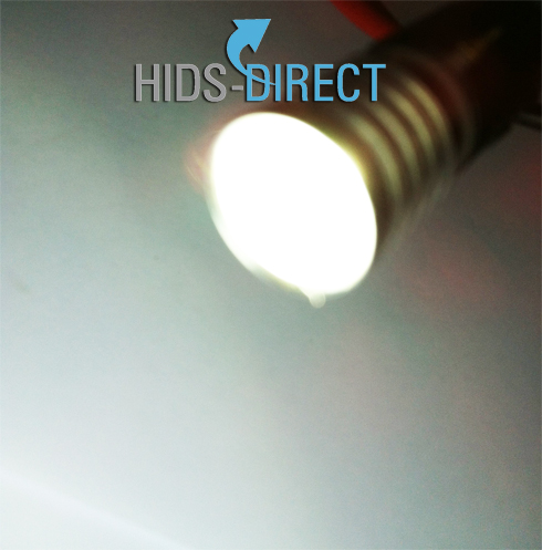

the 3 bulbs in the central light are 5W, it's difficult to read the bulb , 2 are buried and central 1 extends out from the hole
so best option would be to have 2 directional on the sides + central one with wider light angle
2 pieces like this one
1 central piece like this one
am i right??
this one should also work , it's 2wats , 8 x0.24w total power
i didn't understand well if we have to match the original bulbs power with leds power , because we have 3pcs x 5w in the center light alone
