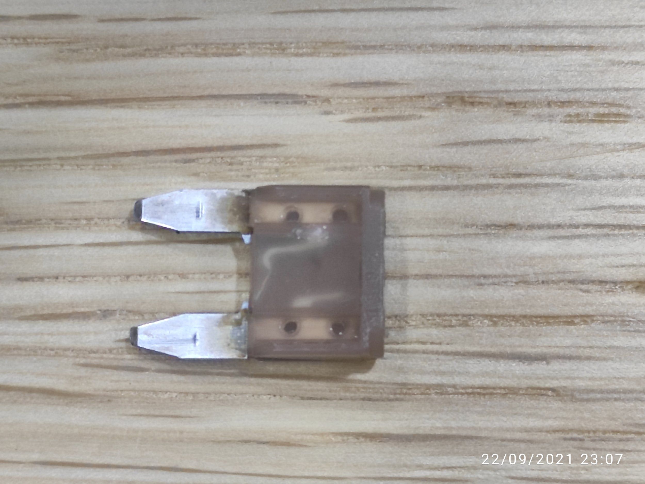

Goodnight. Thank you very much. I appreciate your time and your help. Yes, that was it. The fuse 17 blown/damaged. I only change it. Everything is fine now :) and working at 100%. Thanks again.
