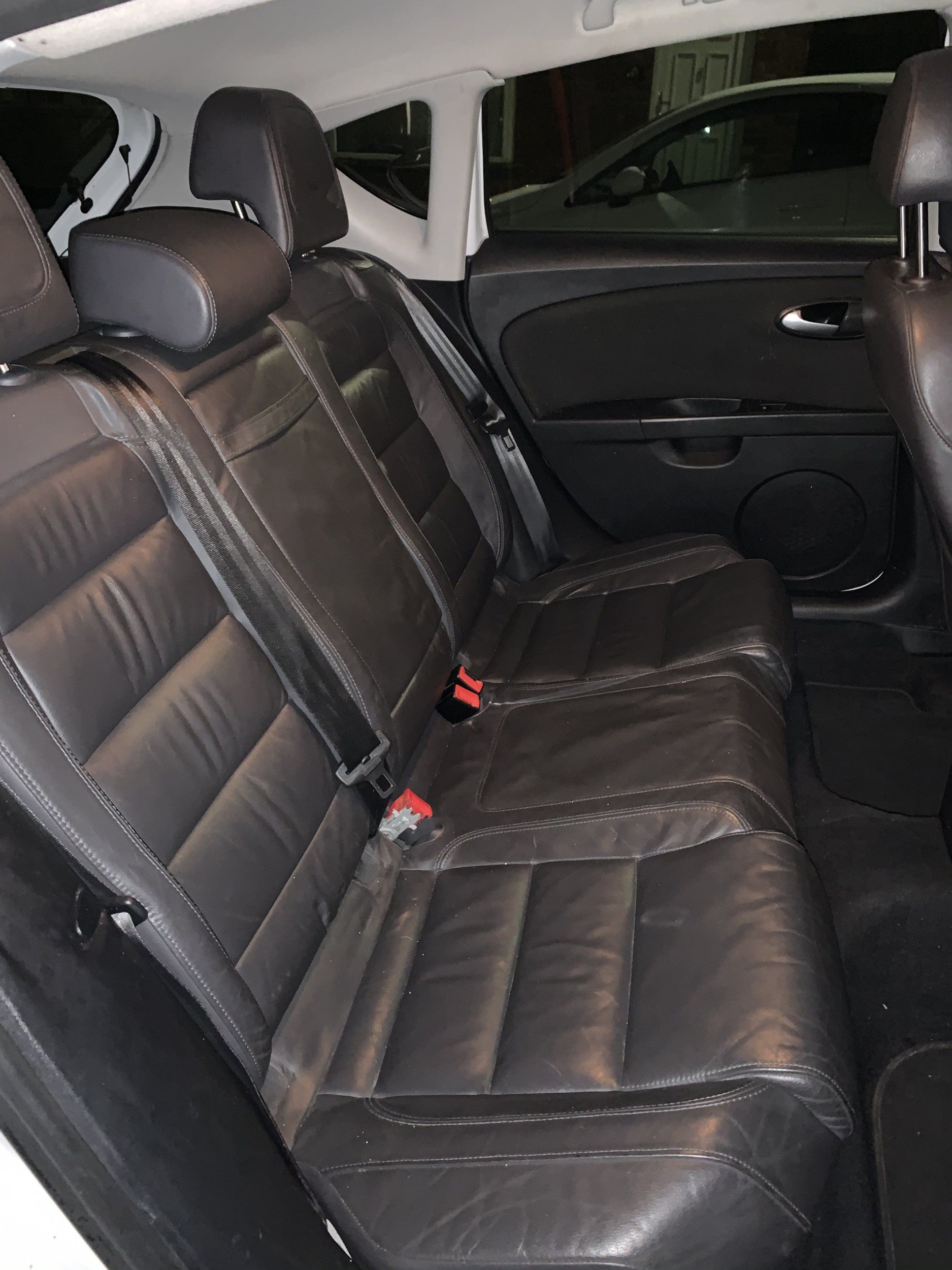

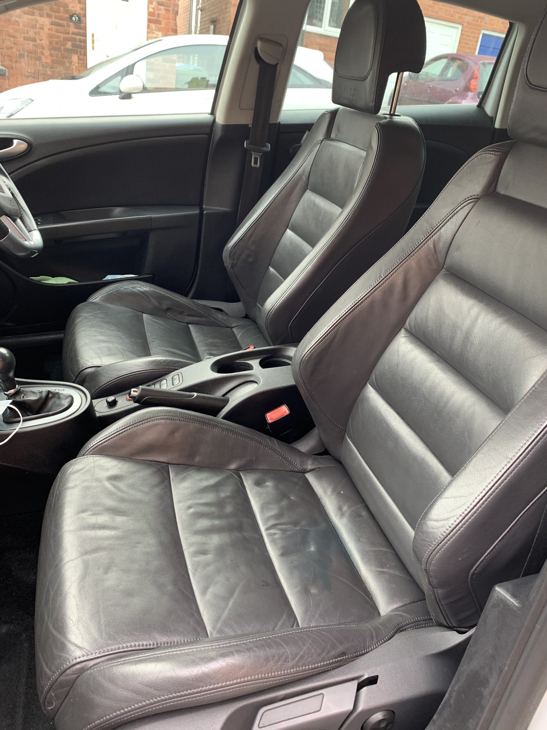

I’ve just put a set of mk5 golf R32 leathers in my 2011 Fr. Straight swap. Just had to trim the yellow plug to make the plugs slot together. That took seconds. Fitting the seats took 20
minutes or so.

I’ve just put a set of mk5 golf R32 leathers in my 2011 Fr. Straight swap. Just had to trim the yellow plug to make the plugs slot together. That took seconds. Fitting the seats took 20 View attachment 22197 minutes or so.
