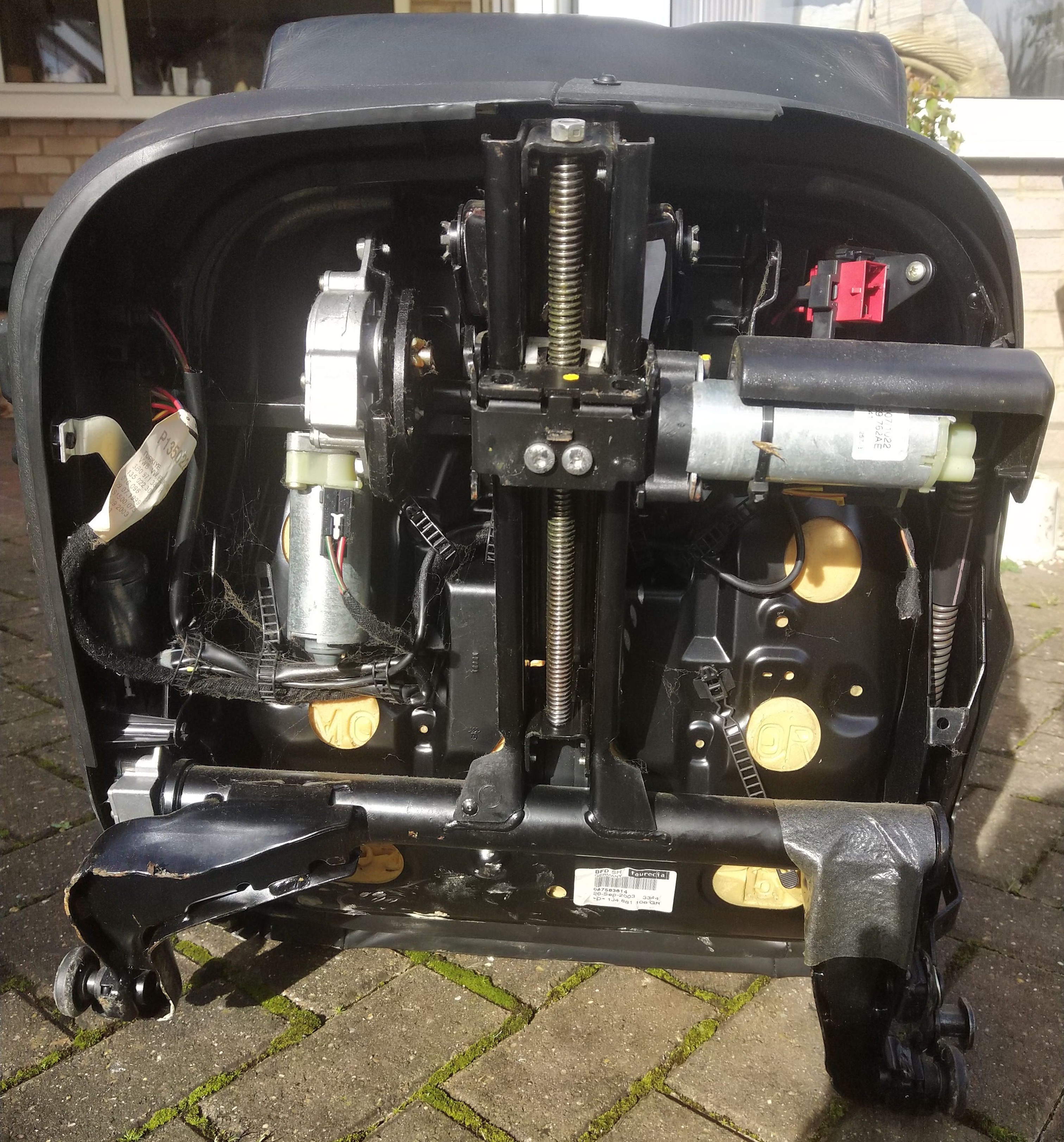

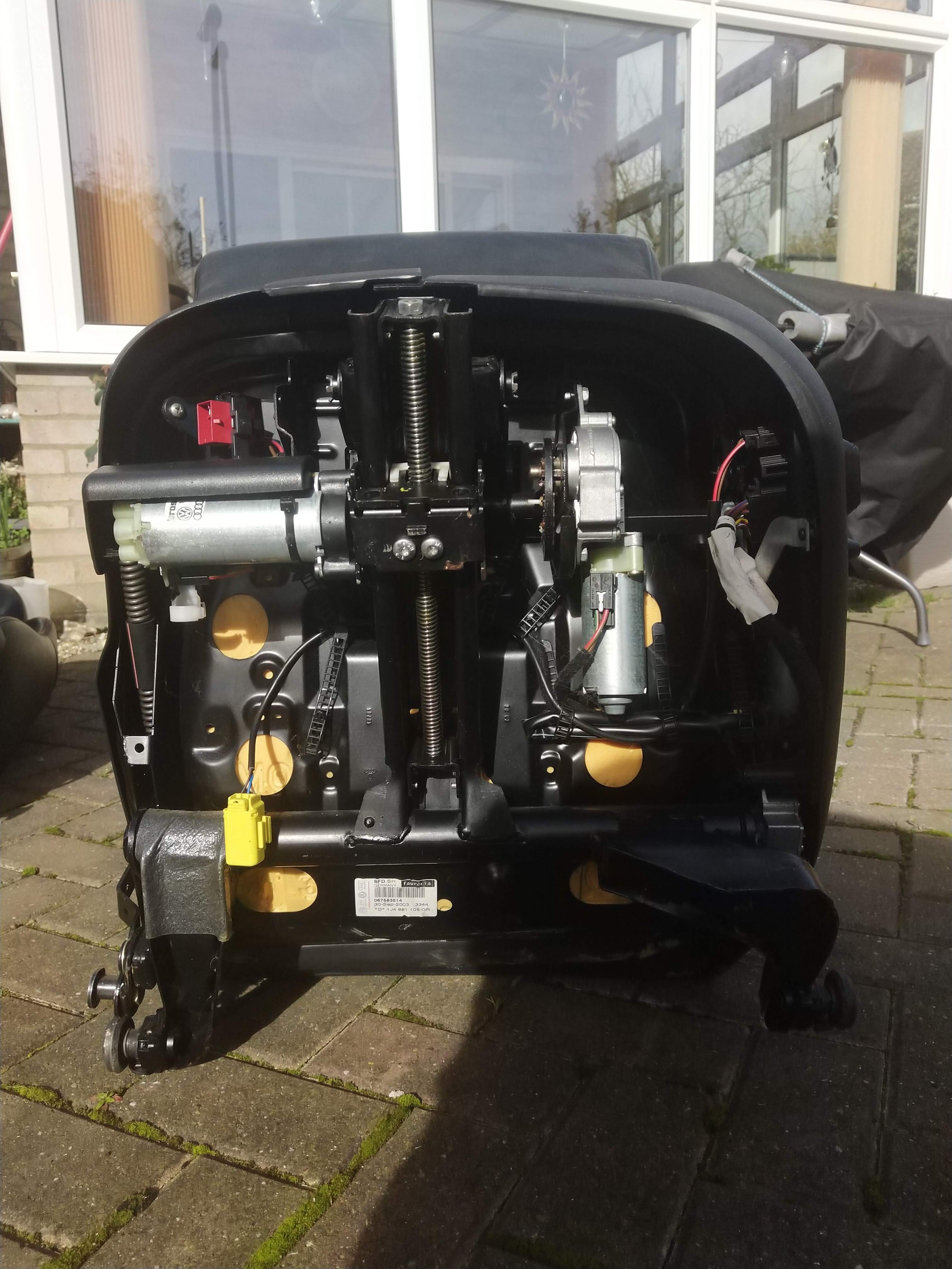

I have a question about these leccy front seats.... Will they be heated? I'm just looking on eBay for a loom... Figure while I've got time off work I should get cracking and put the stuff in. Any ideas folks? Thank you please
Hi Thai-wronghorse, Ive now had another inspection of the seats and there is only one plug so im guessing no heating... can i just redneck it in there as the plug only has two pins.....? if so , i see in the fuse box diagram, that No17 is free and has a 7.5 amp fuse in.. and No44 is for Heated seats and uses a 15amp.... any pointers gratefully accepted... then i might be able to both these seats in... :)
I've just had another look at the picture above, is there only red & yellow plugs?
No green?
Sent from my SM-G960F using Tapatalk
In that case you'll just need a live feed and earth to operate the seat motors.
So do i have to return to the fuse box for those? as i said 17 is free.. and 44 is heated seats... any idea of amps fuse required? 20A maybe?
im just gonna go in the garage actually and make a wire with inline fuse.... when they stop fying thats what size i need.. lol
Can I test them outside of the car using a couple of wires and car battery with a fuse in line? Will I risk setting the airbag off?
Yeah, just wire the red plug up. Just dont touch the yellow one!
Cool thx... Thought I better check... I've got an online fuse holder wired in... I'll start with a 15amp n see if it holds..
