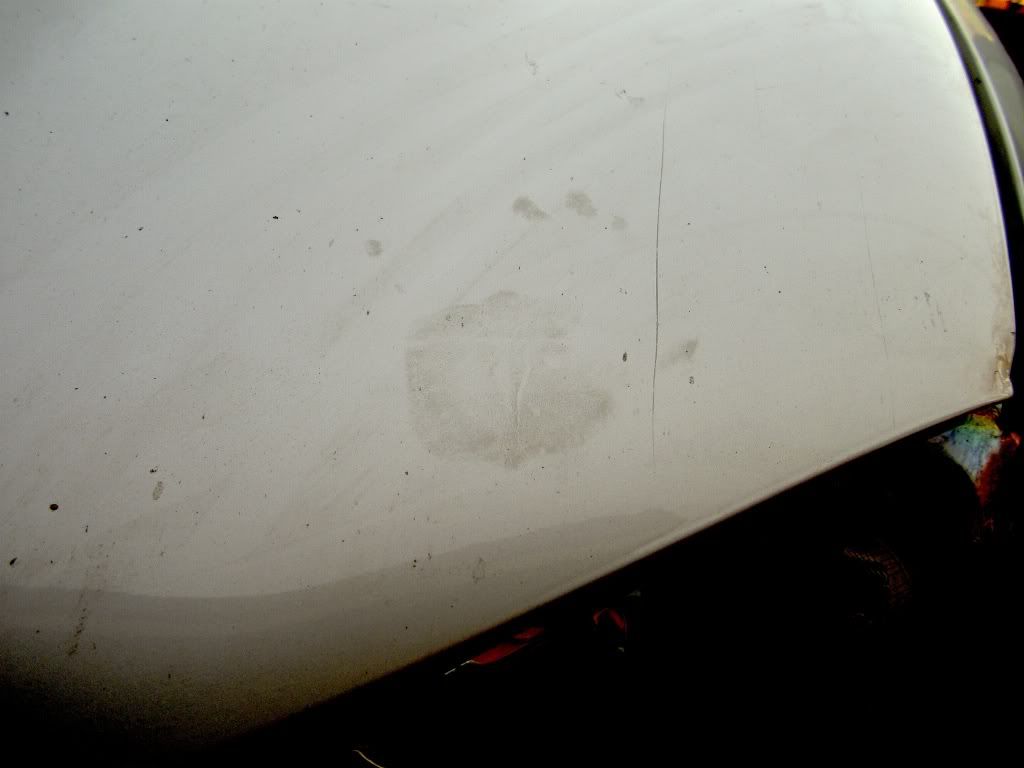

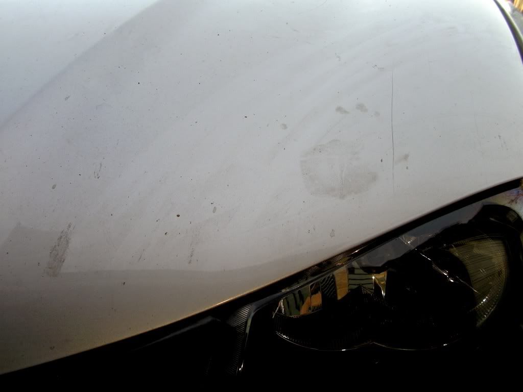

So I've had my Ibiza for just over a year, and in the summer I noticed on the bonnet, just above the passenger side light, a small white handprint, like that of a babies. I've washed the car a few times, however it's still there as sharply as ever.
Any ideas in solving this mysterious case?
Here are some photos, excuse the dirtiness of my car:

Strange, can you feel it or is it under the laquer on the paint?
Something like Autoglym Paint renovator may take it out or try a tar remover which would possibly work.
It really depends on what it is and how it got there.

Scrub it down with baby oil?
:ban: Dont scrub!
Try clean the car using fairly liquid as the shampoo, that should take the hand print off. It will also remove any wax or sealant on the paint work. So if you do use the fairly liquid then you need to polish the car, seal it and wax it again.
Alternatively you could try using clay as mentioned above or using a paint cleaner (AutoGlym Intensive Tar Remover is good)

I would try white spirit/tar remover first. Then a cutting polish like megs scratch x or similar.
Do not use anything abrasive, or any chemicals that are not paint safe.
