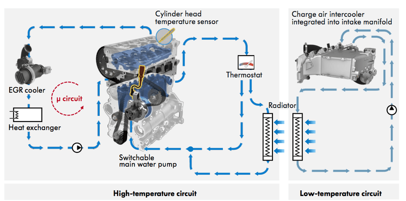

Thanks. I did keep my dashboard setting on the coolant level and it did stay at 90 degrees though. Would that be the case even though it overheats?
In a word - YES.
More detailed answer - during your DPF regen the input/output gases reach around 600 degree celcius. The EGR cooler and coolant circuit help cool that down when a regen is complete.
The EA288 engine has 3 coolant circuits, one specifically for the DPF/EGR. The main coolant temp sender is in the engine block and is linked to the main coolant circuit. That has nothing to do with the DPF/EGR and will not detect the super hot DPF/EGR coolant. If it did, you'd get overheat warnings everytime you had a normal regen. The car is not actually overheating, just the smaller (blocked) EGR circuit is boiling your coolant. The main coolant circuit is absolutely fine, hence the `normal` coolant temp.

I really appreciate your time to post that. Its been annoying me since this all started, I also apologise for asking this question twice but im a lot clearer on things now. The Matrix is in the post from Germany and when that finally arrives we can get that fitted, get some heating back in the car and get this sorted.
