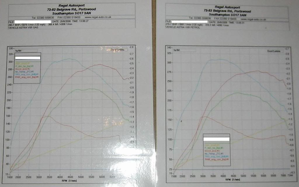

Just to throw some figures about, i saw these a fair while back
peak bhp is 279.7 on Shell 99 petrol and 290.7 on lpg. No point in putting 99 octane in anymore
That's probably becuase LPG has a higher octane rating - around 110 IIRC.
