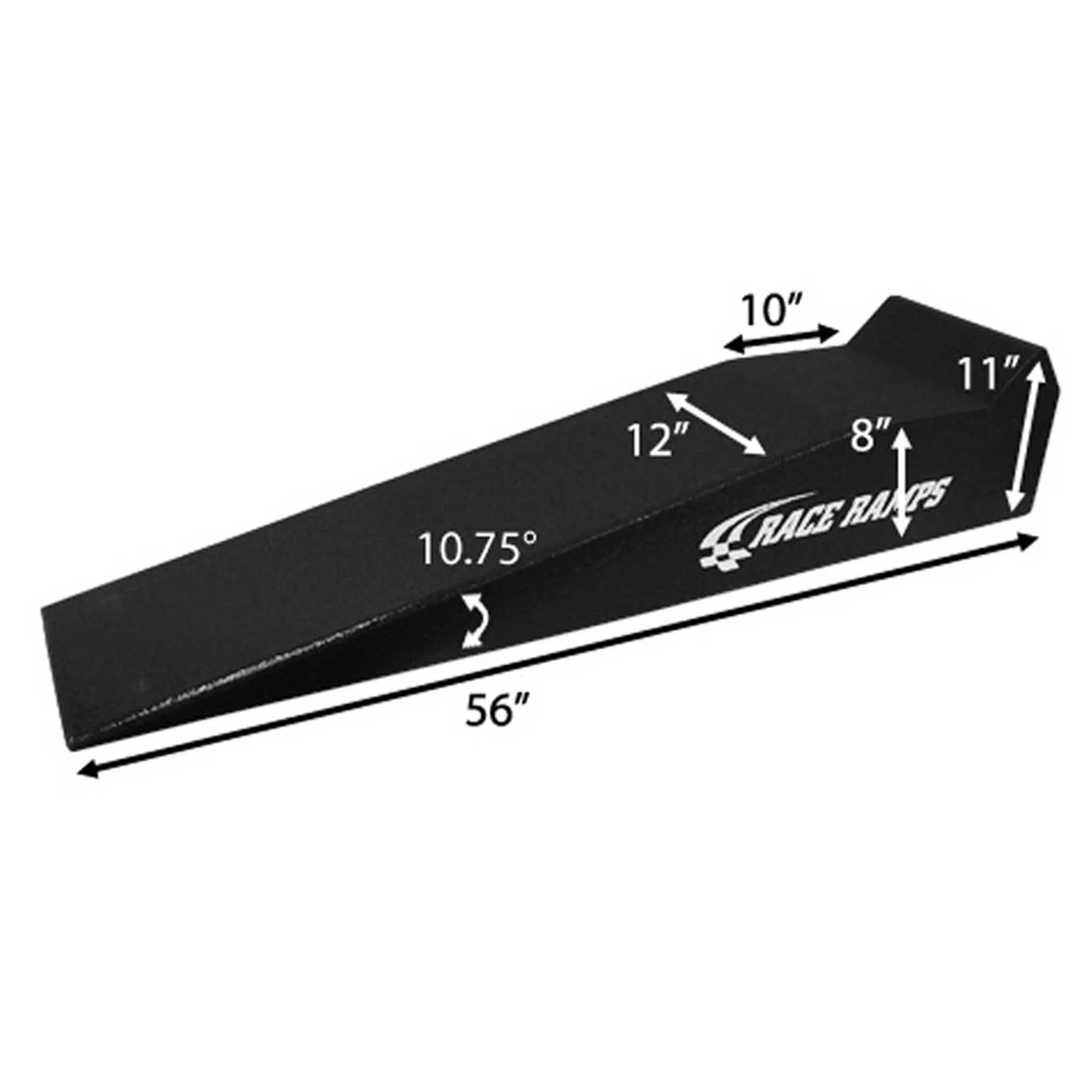

Am tempted to just get a decent set of ramps (maybe even some Race Ramps, they're pretty pricey, but I like that they're solid, not hollow, and the RR56 model provides 8" of height) and chocks, possibly using a regular trolley jack to lower the car onto the top of the ramps. Could even put some jack stands underneath the reinforced sill jacking points afterwards for an additional layer of safety, or at least leave the jack in place as well.

The only Race Ramps products that I’ve seen are their stacking “wheel cribs” they come in. 6” heights and are made to be able to stack 2 so that means a total wheel lift of 12” - which looks quite unstable to me, plus they or made of some very light weight crossed cell hard foam.
The ones I was thinking of are 8" high (not stacked - see below. It also sounds like you can get the "wheel cribs" in 8" or 10" height single piece units. I'm thinking maybe a pair of the 8" ones would be fine for an oil change.

The wooden ramps that I fabricated are only 6" in height, and I can easily work under my wife's 2015 VW Polo 1.2TSI, and also under my 2011 Audi S4, so aiming to buy some that is 8" in height should work well for you.
Thanks, good to know, don't want to raise the car more than needed - the main thing will be having enough clearance to get under the car the remove the engine undertray. I'm pretty small myself, so sounds like 8" lift should be fine.
Blimy - they are expensive!
Don't waste your money - the Halfords ramps are same height - 200mm, they are very sturdy and only around 40 quid.
