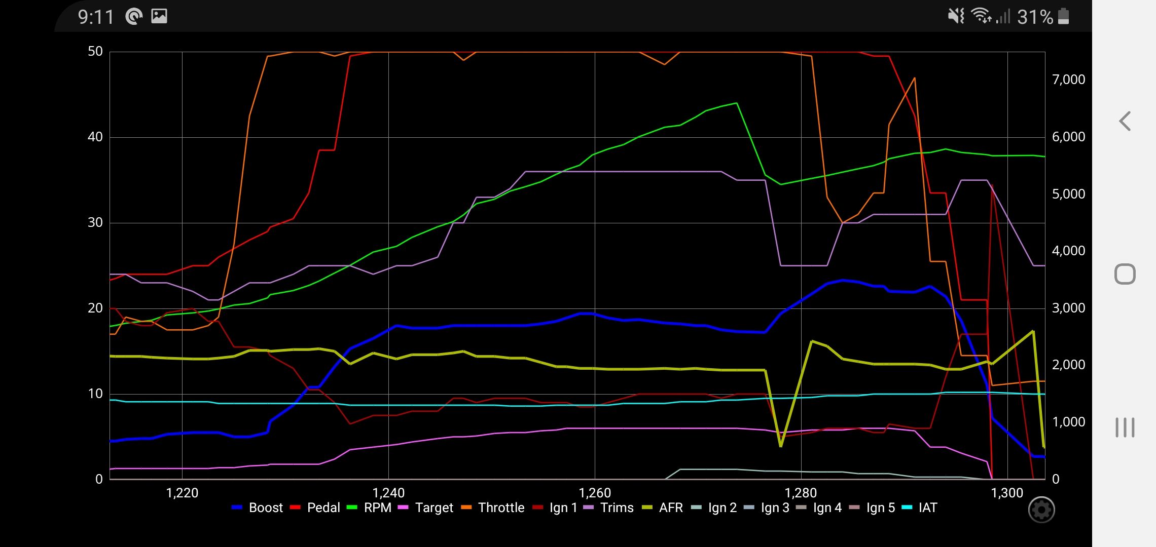

Hey thanks for your reply! iv checked all connections everythings as should be, iv just done some logs i did a map0 log for comparison and in 3rd gear im getting upto 15psi of boost where as on map3 im getting peak of 20psi but as it changes into 4th boost rises to 24psi id upload the log but there is that much onit i think it will be usless tbh so I'll just upload the screenshots of both on here
Post log on datazap :)
On a third gear run ign_1 should climb steadily like step of stairs from 0 to 9 or 10. There are some corrections to on the cylinders but that's pretty normal on R / Cupra. Can't really tell from those graphs, sorry.
