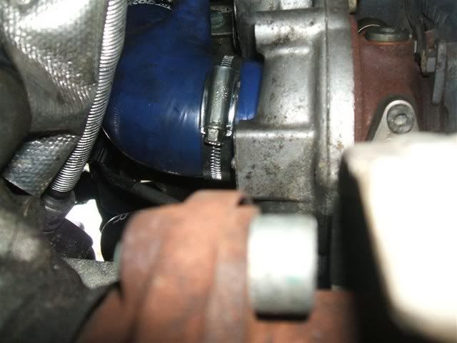

wastegate...is that the opening of the turbo where it meets the TIP?
If yes, then you need a silicone aftermarket tip.
Your regular K03 has a small wastegate port, where the tip comes on. Your original TIP (turbo intake pipe btw which is the black hose in which your dumpvalve sits, and on the other end your MAF and airfilter) has a metal casing on the bottom which fits perfectly on your K03 wastegate.
BUT because the k03s has a larger wastegate in diameter, the metal part of the TIP does not go on the wastegate!
Therefore you need a silicone TIP which due to it being silicone can stretch over the larger wastegate!
tell them not to try and force the original tip on your new turbo, and get yourself a TIP!

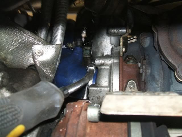

Ok the thing I am talking about is this:
If its that, then they need to spray on a little wd40. slips on then. Its a bitch to do I know, but have one of them under the car guiding it and the other from above pushing it on. He needs to stand infront of the car and with his right hand push it on!

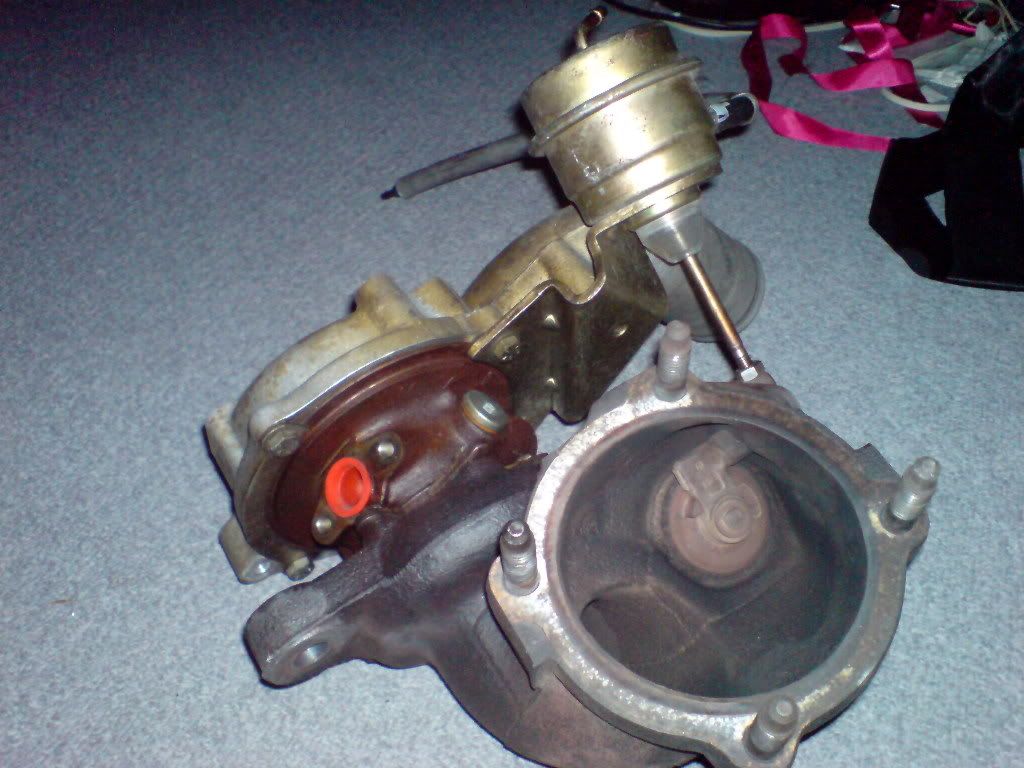

I'm talking about the 4 bolts just above/to the left of the red plastic cover in the below pic:
that lets you twist the 2 parts

ok on the K03 there is 3 vac lines running to it in total. 1 to the far bottom, just next to where the TIP comes on the turbo.
then another one on the acurator which is the copper looking UFO thing in the above picture at the top (you can just see the small nipple)
And then another one.
That last one you need to block off. The K03s no longer has a opening for that.
just run that vac line to the beginning (might be a T piece not sure anymore) but block it there
