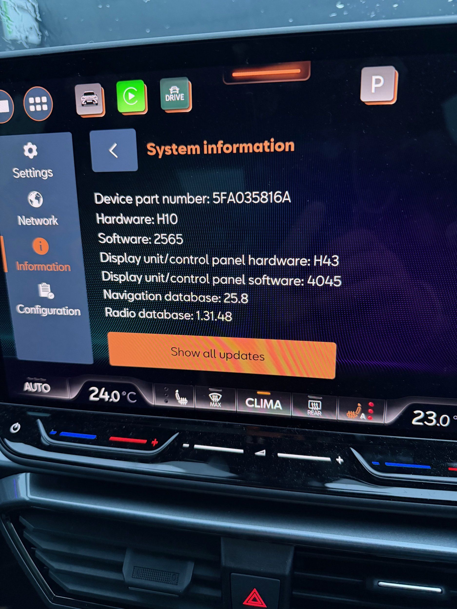

Hi @James_R - thanks for the information about update PV4RC.
How can I see if my car has this update - or indeed, which software my car is currently on?
I've already accessed this screen, but I don't think it tells me about PV4RC...

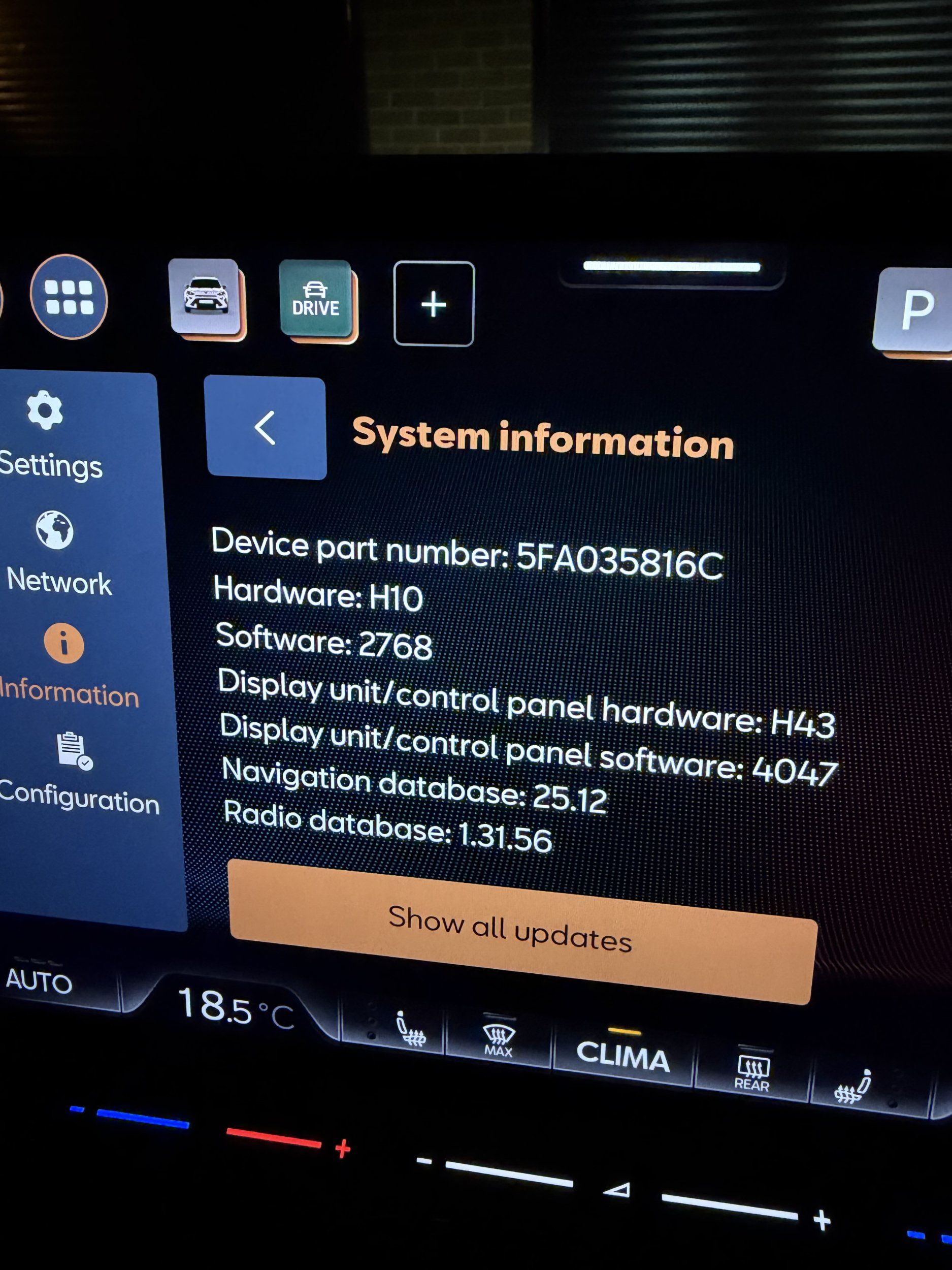

I have just had the PV4RC update done on my VZ3 (333). Initially i can see that their are a few improvements. The ambient lighting no longer flickers, my drivers seat now moves back when i open the door to allow easier access(not 100% sure this was an issue). The cruise control now works better and increments in 5mph steps when you press the + or - buttons. Just need to check the auto dipping headlights are working later, they have never worked since it rolled off the production line. I think the upgrades are quite extensive and the dealer had my car for 2.5 days to install this update!
Will see in due course if this fixes the rear tail light warnings i get randomly.

We only got our car 2 weeks ago and shows 2565. Everything appears to be working although driver's seat doesnt move back as door is opened. System tells me i have latest software. Ill enquire at dealership in New Year.
2768 is the latest version at the moment but needs installing with the rest of the software on the vehicle. I believe the seat issue *should* be covered.

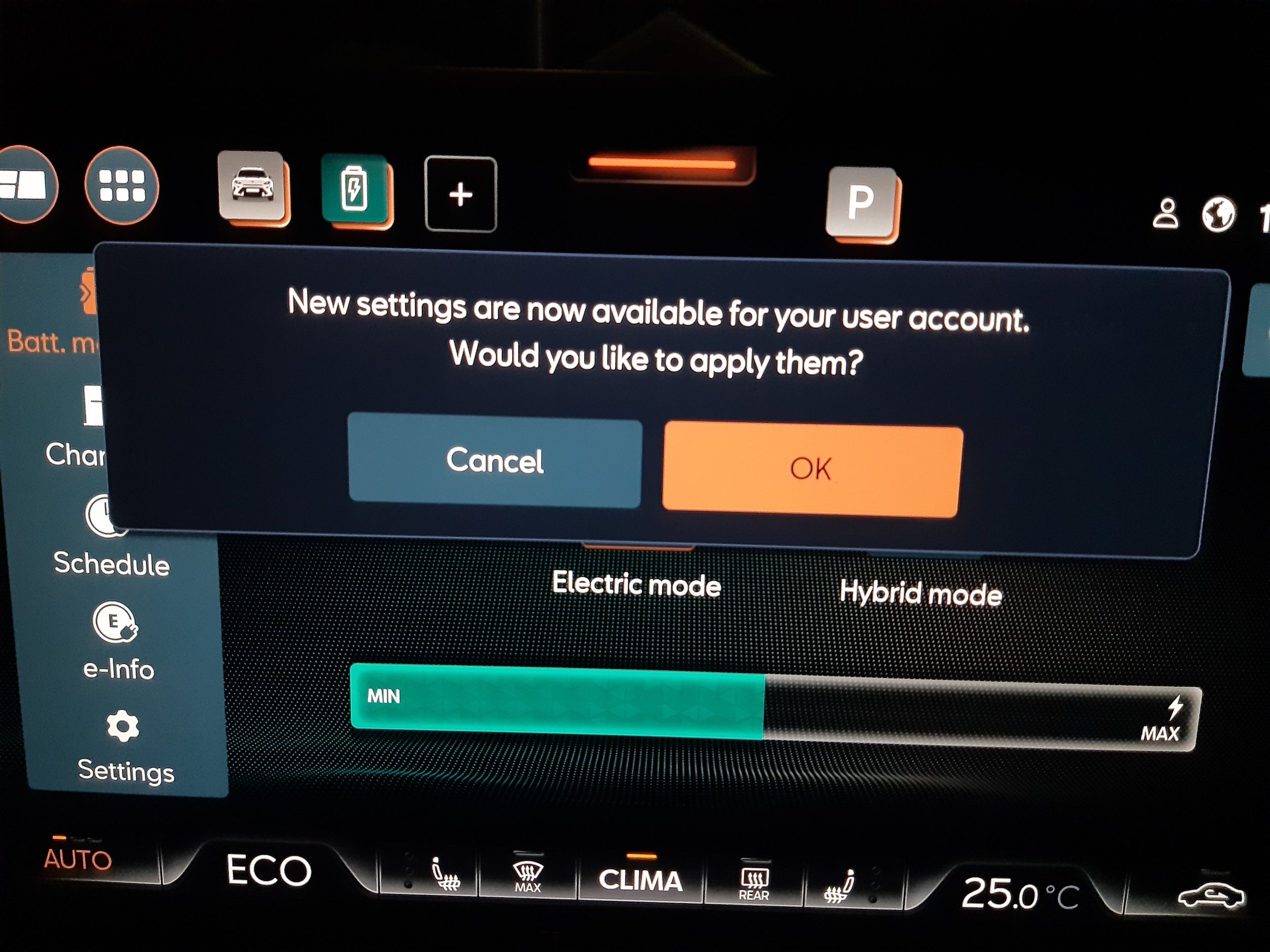

Further to my post above I have worked out was is causing the Light Animation to reset.
Remember this is on the Loan Formentor (75) running the 2768 software.
Everytime I restart the car i get the message below, if you cancel the Animation is held, if you accept then the Animation is reset. Irrespective of clicking OK Cancel the message appears on every start.

"...message appears on every start." - that's highly annoying, isn't it? (well it would be for me, anyway)
Why on earth do they allow these things to be installed on your car without designing & testing them properly? Bl**dy muppets.

My car had its first service today and they also performed the PV4 update. I now also have software #2768.
Must admit I was a bit hesitant, but everything seems to be working fine so far. Thanks again to @James_R for the heads-up.
