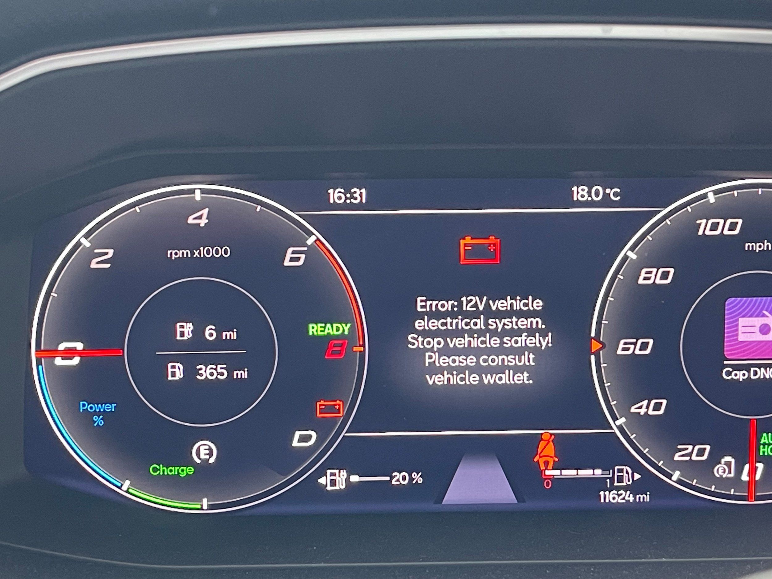

After three trips to the service center software was upgraded to 1898 and it seems the SOS error and intermittent problems have gone away. However, on starting the car and driving 50 meters we have a new error. 12V vehicle electrical system. Stop vehicle safely? The service center weren't able to apply a fix for this so it looks like they'll call us once they have a solution. The car is also under recall due to a fire risk with electrical arcing of some description. Hope they aren't related. Only a few service centers have trained engineers but the closest an hour away doesn't have spare parts for this and will call us once they have stock. Hopefully once these issues are fixed this is the last time to the service center for a while. Anybody else had the 12V error and knows how to get it fixed?
Same as you. After TCU FW upgrade to v142, system to 1898 and recall (2 recall with one related to cable), problems are gone.. reactivity is very good, CarPlay works fine, without lag. Only make 300kms right know but all works fine

The SOS message and infotainment issues are fixed from what we can see from three weeks driving. It's just the 12v and now a red battery warning that we are dealing with which started on leaving the service center. So this could well be related or an issue that was hidden previously due to faulty software. Seat customer care manager is trying to get resolution via the dealership CityGate. Will let you know as and when we get this fixed.
The only news i received is that for the recall issue they are increasing trained engineers from 8 centers nationally to 32. The problem is that there are no spare parts to resolve the fire risk as we learnt when we tried booking the car into one of the 8 centers.
