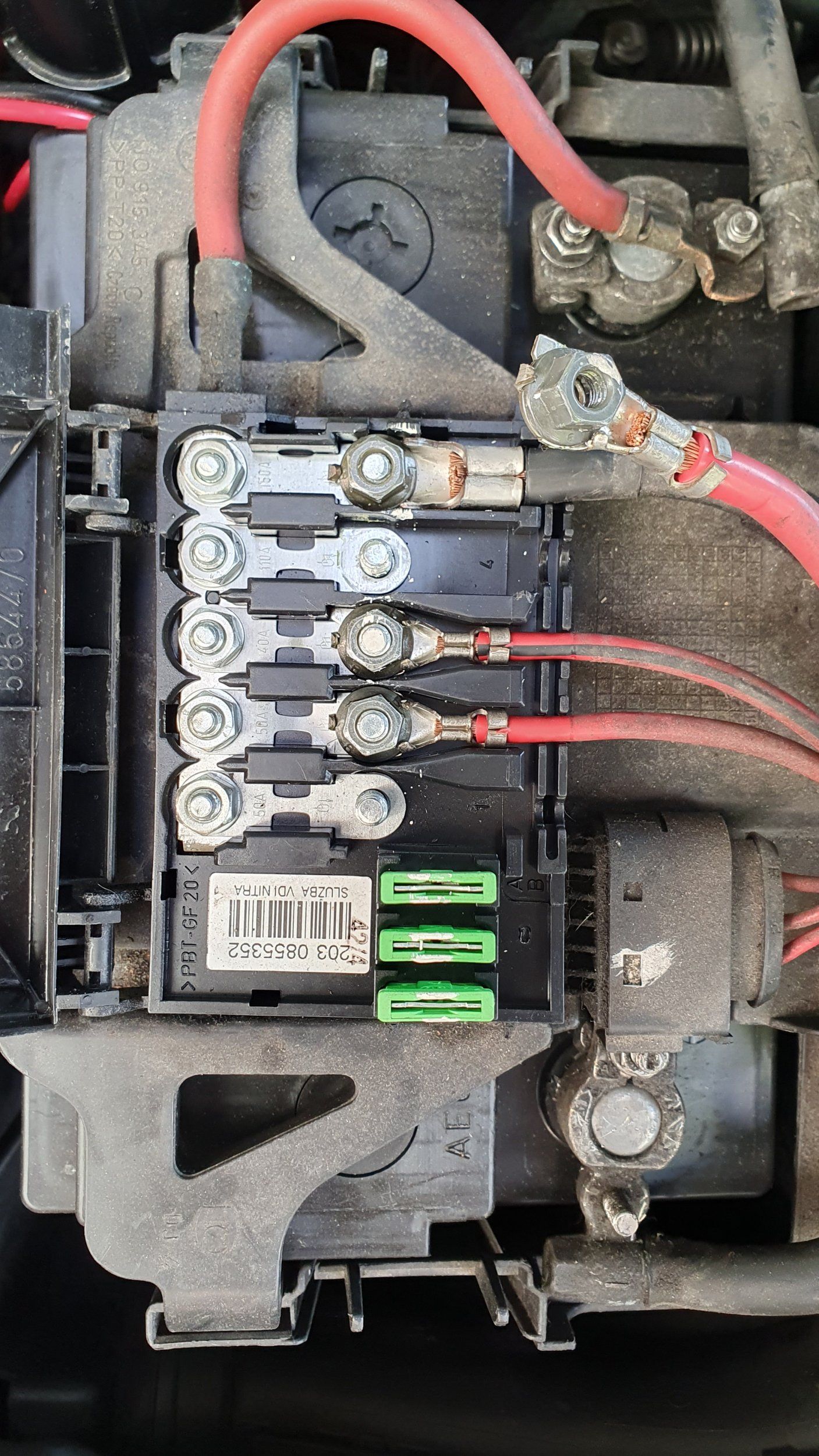

My car has been in a local garage for 2 months and they have failed to find the battery drain issue. I replaced the courtesy light with a new one so it's not that. Then they thought it was the ignition switch, so replaced that, but still have the drain. Now they have given me the car back after giving up.
Whilst the car is off, I measured the current through each terminal shown on the attached pic. The one that's disconnected has a 2A drain!
Does anyone know what that cable supplies?

Interior relay panel
Water can sometimes trickle into the panel under the steering wheel, so I'd pull the relays and check for rusty contacts.
