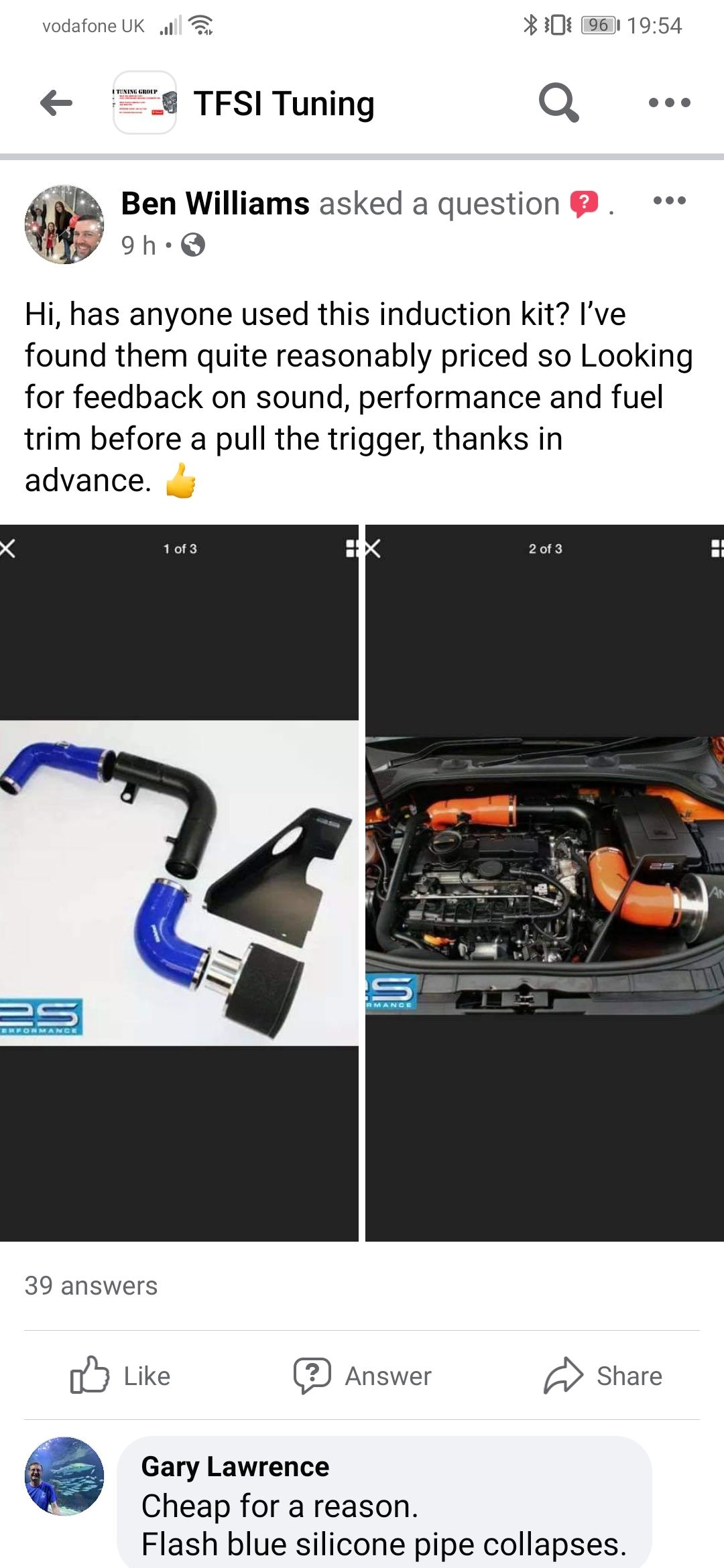

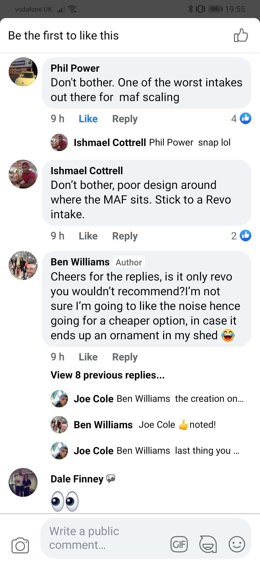

One little bit of advice, R/Tech have said that the airtec is one of the worse intakes for fuel trims, I read it today, should have stuck with the revo mate
Reactions: Benmk2cupra
Here's the post mate
