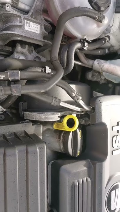

My 2018 1.4 has a problem, I had been out in the car came home parked up for 5 mins and then the car would not start. When opening the drivers door it makes a strange noise as in the video below, I believe it's fuel injector seals which have gone
Do you have a strong smell of petrol? If you have it's possible it's the dreaded fuel rail bolt fault.
Had the same issue last year, parked the car up after traveling 70 miles from Bristol airport, went back out to car 15 mins later and car wouldn't start, and fuel gushing out of fuel rail.
If you Google VAG fuel rail fault you will get all the information.
Apparently it resulted in a recall on all VW vehicles in America, but in Europe it was ignored.
Yeah that's what I think it is, googling it came up with skodas, VWs, and seats all having the same problem, fingers crossed its not going to cost a fortune, I'm 10 days outside of my used car warrenty typical
Oh bummer, I think I payed my local garage £260 which included towing it to their garage.
They fitted 4 new bolts and new injector seals, apparently it is more likely to happen to cars built between September 2017 to mid 2018, due to incorrectly set tooling in the factory.
Mine was built late 2017 and registered Feb 2018, so right in the range, that's not too bad a price, still an unexpected cost though
Definitely, when you consider that it's done free of charge in America and Canada.
Why our motoring safety authorities didn't insist on this being a life threatening safety recall in this country and Europe is absolutely criminal, I just hope and pray no one gets badly injured or worse because of this.
