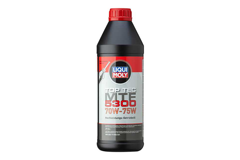

Opie Oils recoomended these for my 184.
I appreciate it may not be that simple if there are gearbox variations.
I had mine changed at the start of the year and it has made 1st and 2nd less notchy and a tad smoother.
Reactions: Leonfrdiesel184

Check this one for manual 02S 6/1 gearbox (MQ250)
