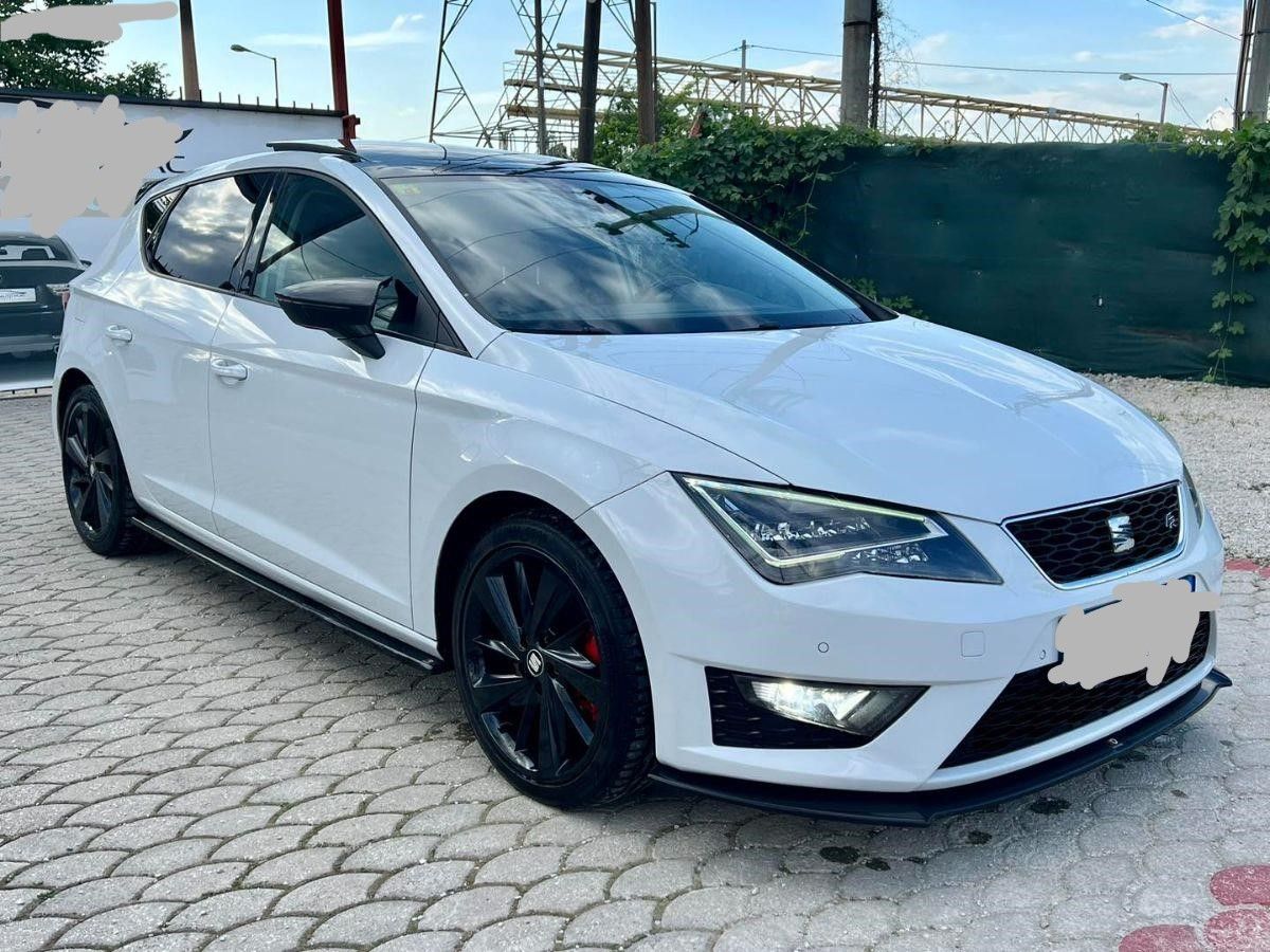

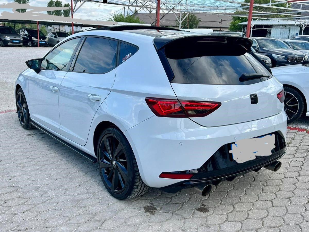

Hello everyone, I'm seeking some guidance related to buying a used 2013-2016 2.0 TDI Leon. Most of the cars where i live are imported from Germany, Belgian, Switzerland and all of them are 180k+ km of millage, almost all post i found say buying anything more than 100K is a risk. I have an eye on a 2016 model 2.0 TDI 184 HP, it looks and drives solid, no mayor visual damages other than some scratches in the bumper and on the right headlight. It has quite a few options in comparison to other leon's on the market, it comes with: sunroof, Adaptive Cruise Control, Front and Back parking sensors with rear parking camera, half leather half Alcantara seats from what i understand, 18inch original black FR wheels, full LED package, additional USB ports with wireless charger i believe, 6 speed manual (which i prefer). it also has some additional body part fitted from the last guy: front splitter, side skirts, back diffuser, and spoiler, and it really looks like we was taking care of the car nicely. The problem is its 237 XXX km of millage and i don't know if it will have any problems. my current Leon 1.9 TDI has 301 XXX km, it has a remap to 150hp and has just had his second transmission replacement and i need a new car by the end of the year. the asking price is 11 900 euro but i will probably get it down to 11 000 after todays talks, and will probably do a full belt, water pump, oil, filter change which will cost me around 800 i belieave. Do you think is a wise move to but the car? below are exterior pictures of the car

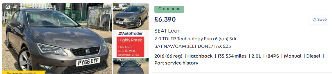

Seems expensive compared to UK:
=7440euros.
Plenty of Leon's/Golf/Octavia's etc. with higher miles - just depends on how its been driven - usually those boy racer add-ons don't correlate to a 'gentle' driver. Aggressive launches and gear changes of course will shorten the life of any car drivetrain.
