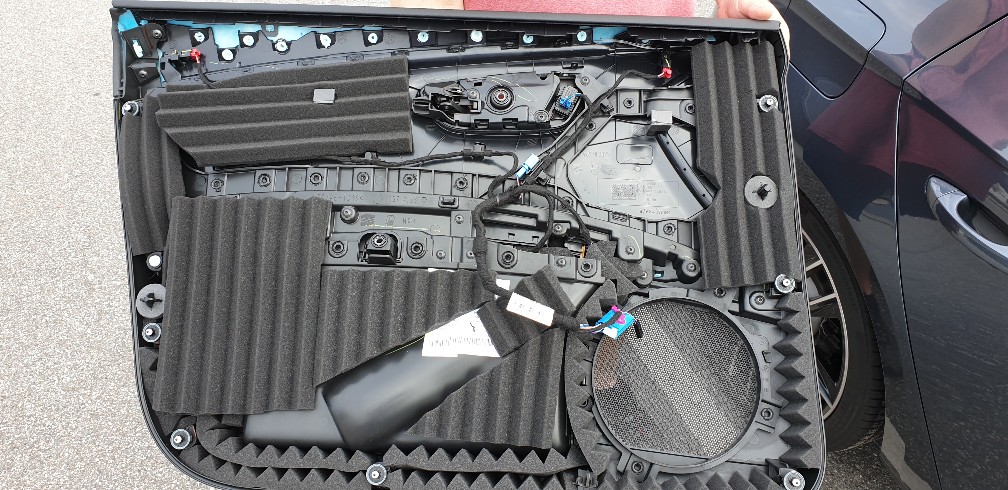

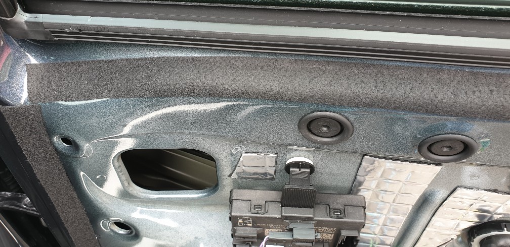

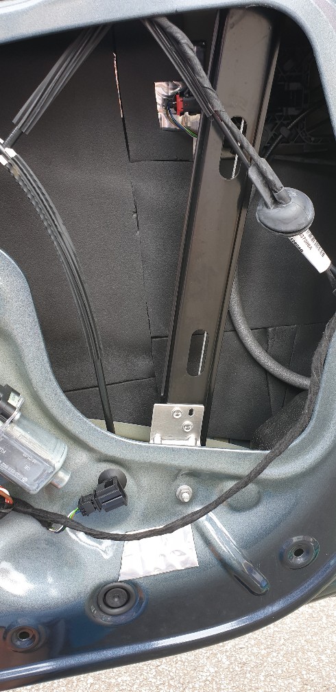

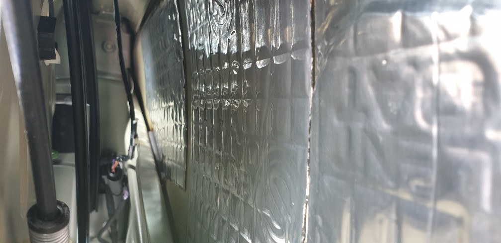

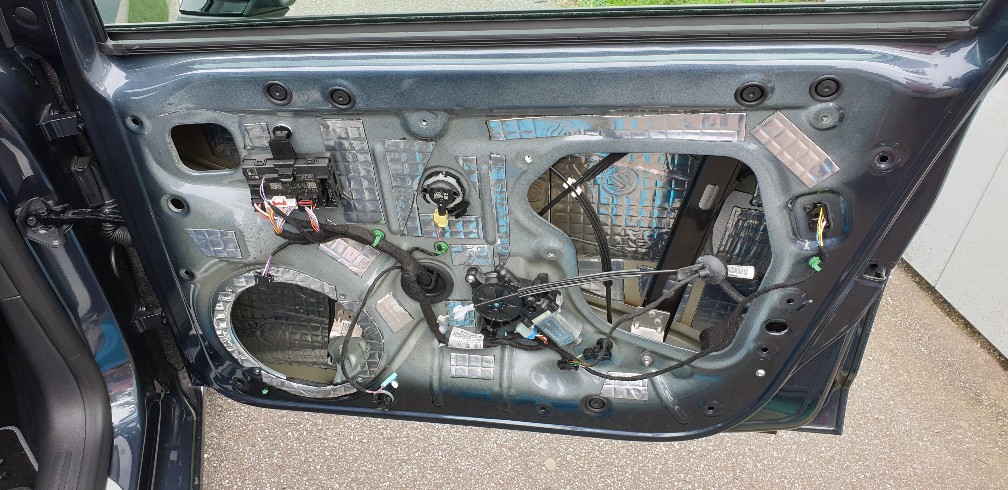

Been fiddling with sound deadening the last couple of days. Boot and front doors done so far, next few days will be the rear doors and under the rear seat. Been using Silent Coat and a 10mm closed foam on top, and the acoustic foam inside the door panels. Anti squeak tape on contact surfaces. Already made a noticable difference, especially on the stereo sound. Had to change the sound settings as the bass was way too heavy now.
