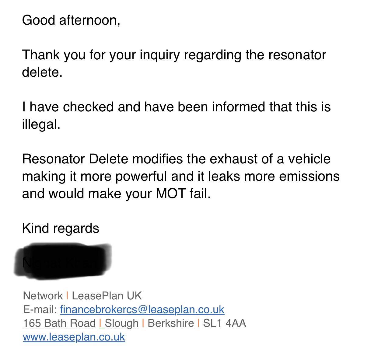

Well, this is the response back..
It’s not illegal. Any ideas how to respond?

Well that's just totally incorrect. Removal of a catalytic converter would mean MOT failure on emissions, but not removal of a resonator or silencer.
The mid silencer (that isn't even there on the new GPF'd ST) is there to attenuate a particular dominant engine firing frequency. The rear silencer is a 'broad-spectrum' frequency attenuator for the rest. Their answer is wrong.
