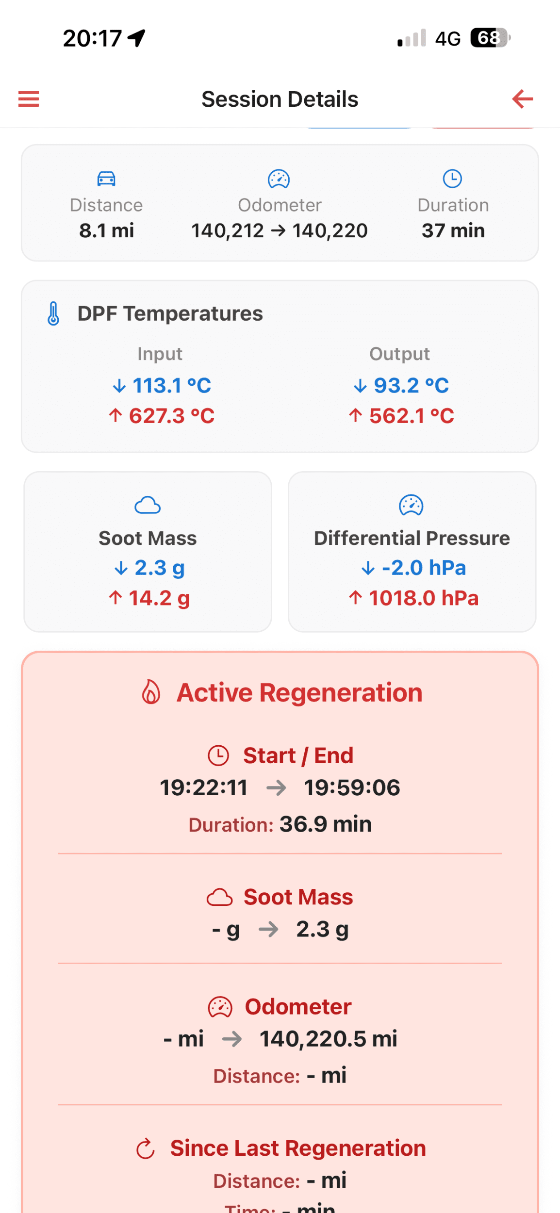

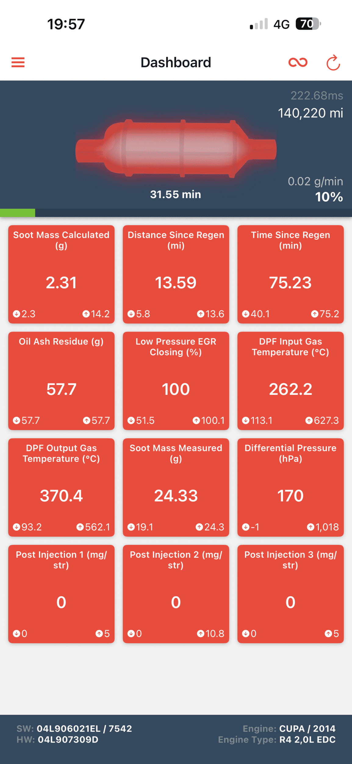

I do have vag DPF I’ve included the screen shot of the last regen, have just noticed the soot measured vs calculated is wildly different.
