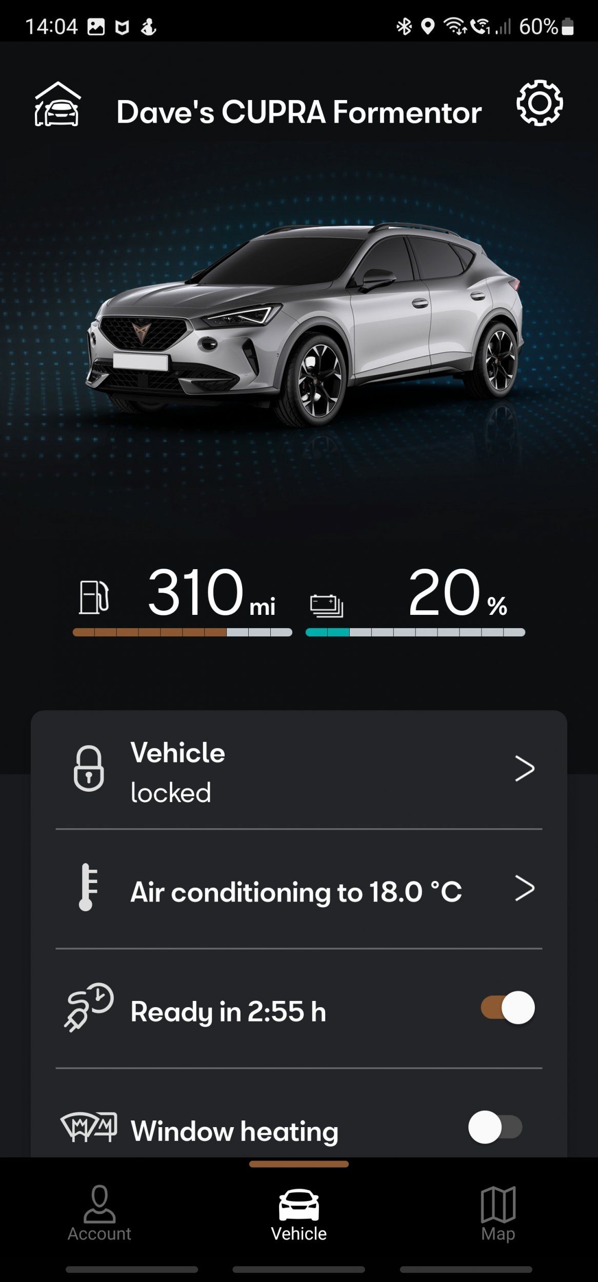

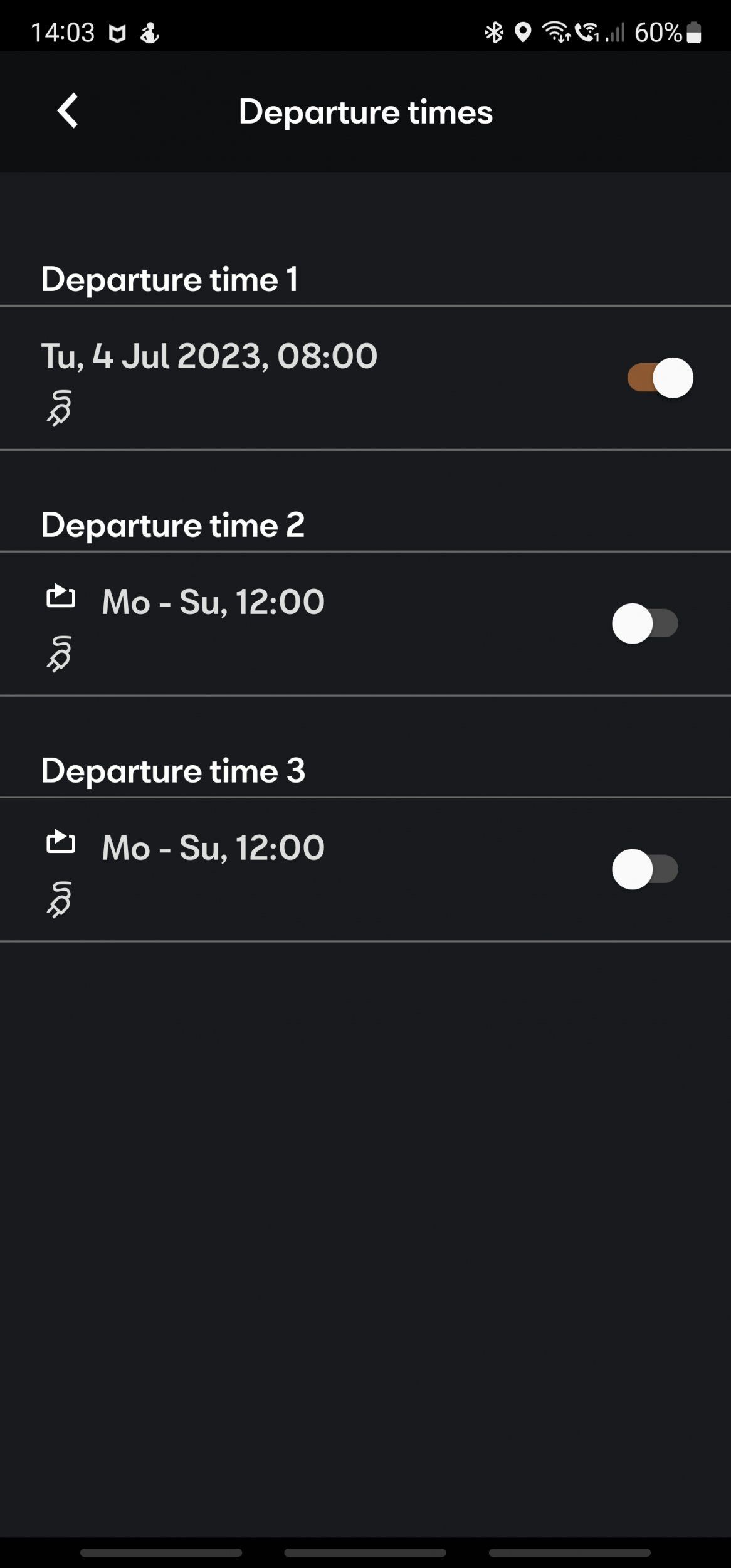

I can't understand what you've done there unless your Seat Connect app is different to the Cupra Connect I have? Departure time is set for the time you want to set off on your journey. So the car will start to charge at sometime prior to the set departure time. If you battery is at really low, say 10% then it will start charging much earlier than is it's at 90% for example.
I have a departure time set for 8am tomorrow in the screenshot attached. It's charging now because I have the minimum charge level set to 50%. Once it gets to that level it will stop charging and start again probably around 6am tomorrow.

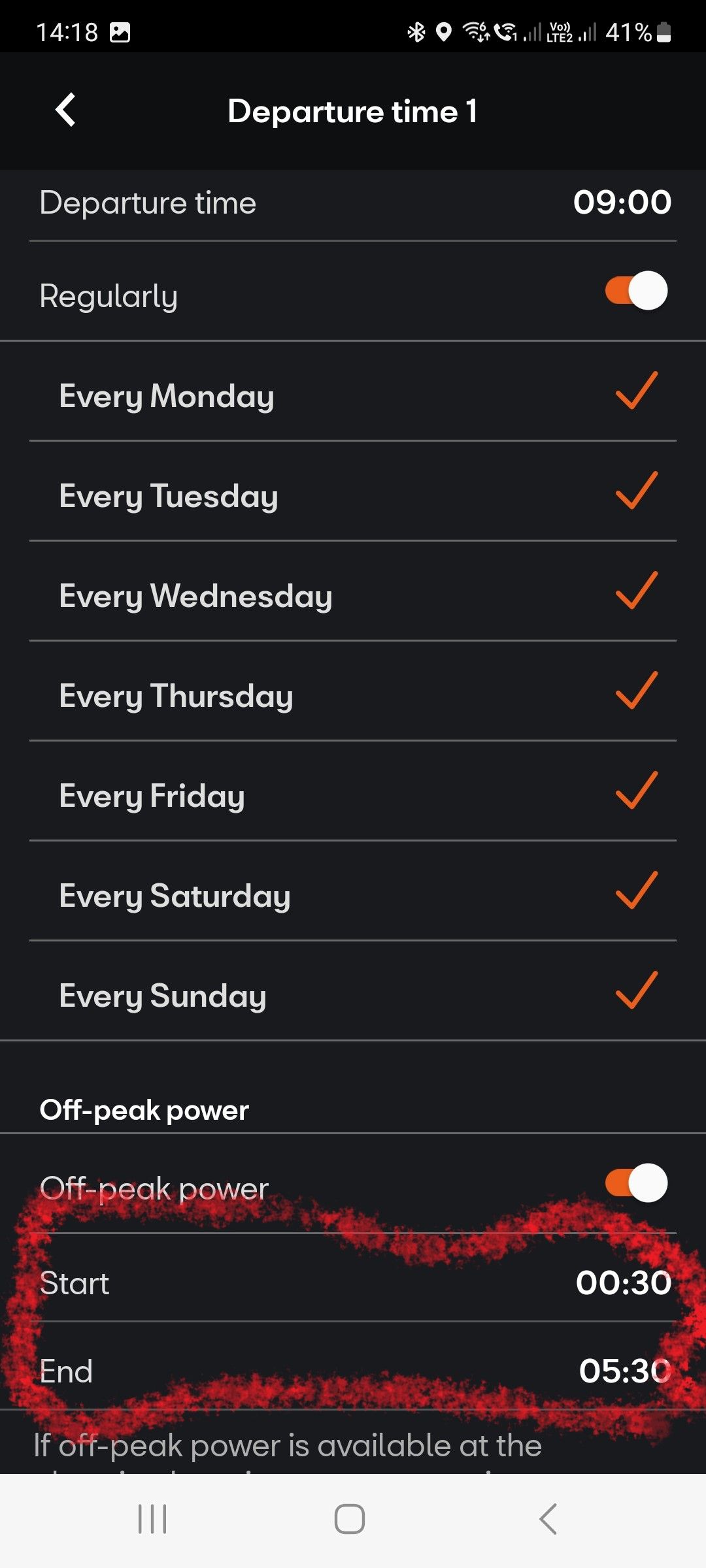

just tried the same process again and its just immediately started charging and has ignored the schedual?
Could be the minimum charge level as I mentioned above perhaps? Have a look here:
tested again and it seemed to start charging when it was supposed to.
The timer was set in the off peak power settings! it seems to start charging but doesnt stop? by the looks of things it will just charge to 100%
I have set it to start charging at 00.30 so fingers crossed i get in car in the morning and its charged.

Hi Darren, yes you've understood that correctly.
I don't have off-peak peak electricity unfortunately so I've never dabbled with that. I wonder if you need to set a departure time at all though if you've set off-peak to on? Surely it'll simply charge between those times assuming you've plugged it in of course. 5 hours of charging from a 3 pin plug should be just about enough I'd have thought :unsure: .
What I don't know is that if it hasn't reached 100% within the off-peak power time band will it then restart closer to the departure time just to top it off?
If you don't get the full 100% within the off-peak window you could fit a 16a commando socket. It would be much cheaper than fitting a proper wall charger.
