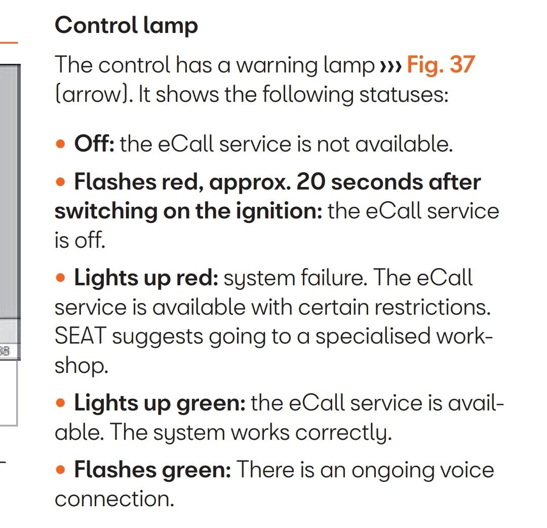

What colour is the light next to the SOS button
Off, sometimes it flashes red
Sent from my Pixel 4 using Tapatalk
dan555
Sep 29, 2020
241
95
From the manual
You will need to take it to the dealer, could be the sim card/modem isn't working or is off
