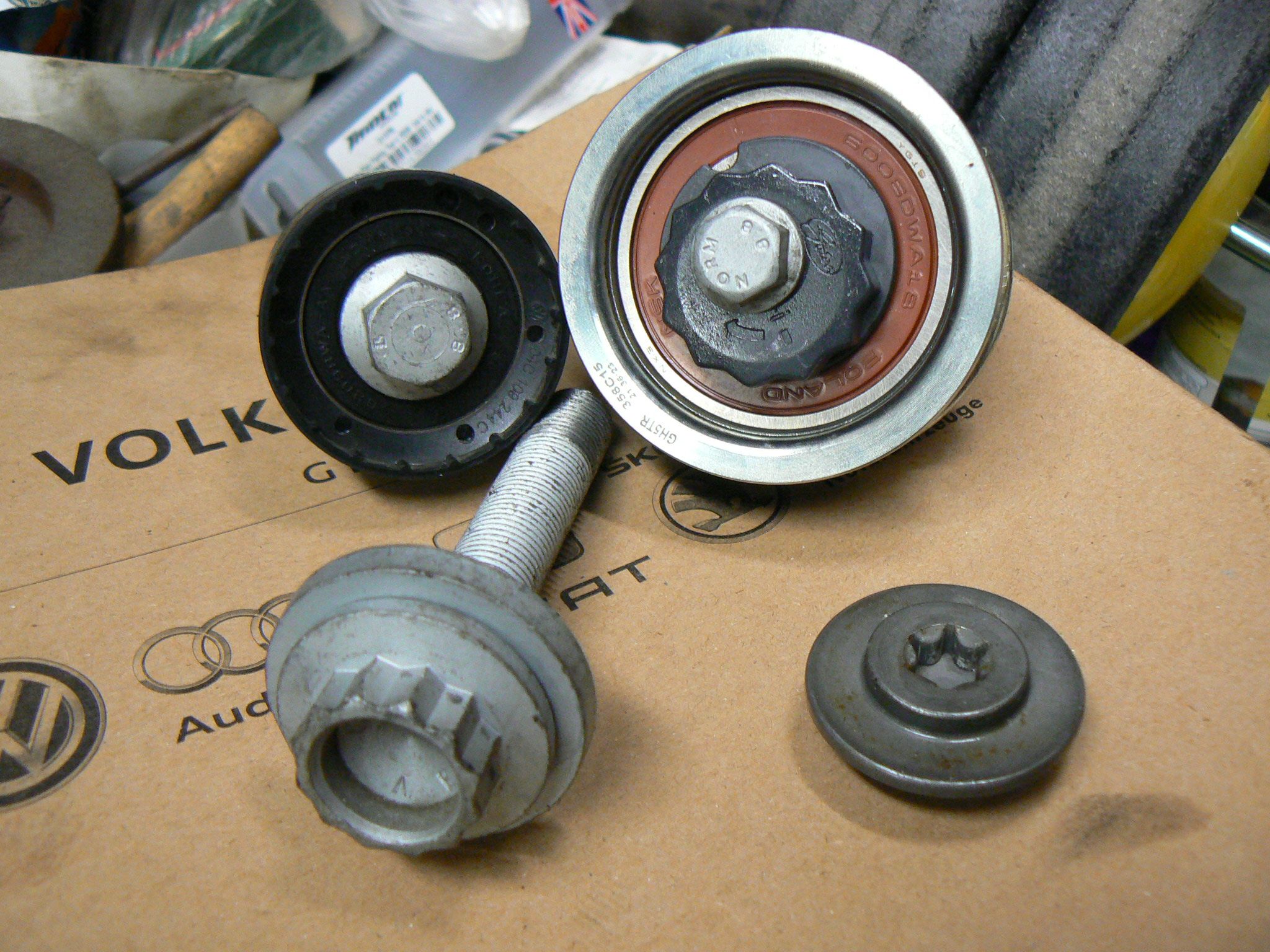

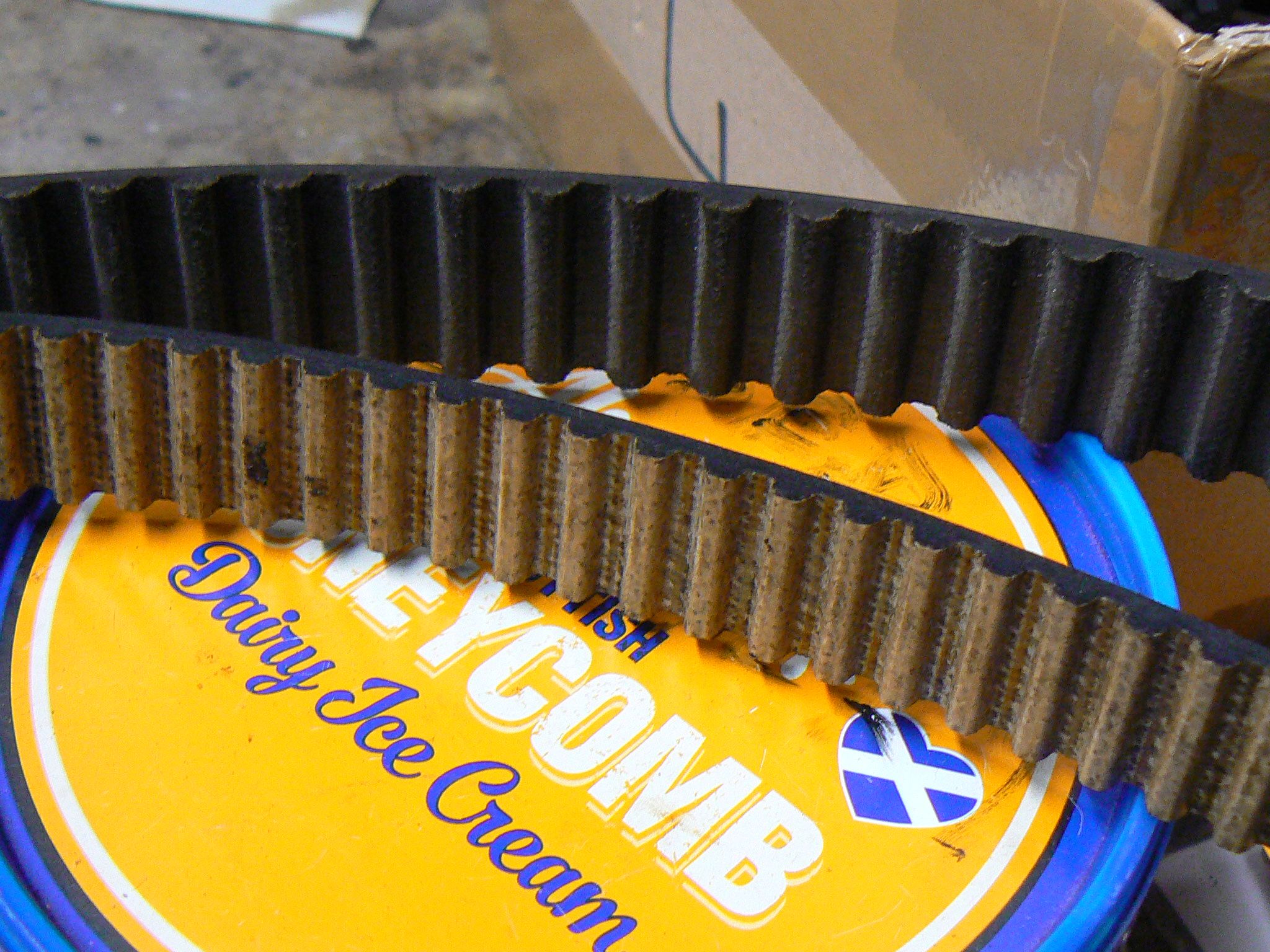

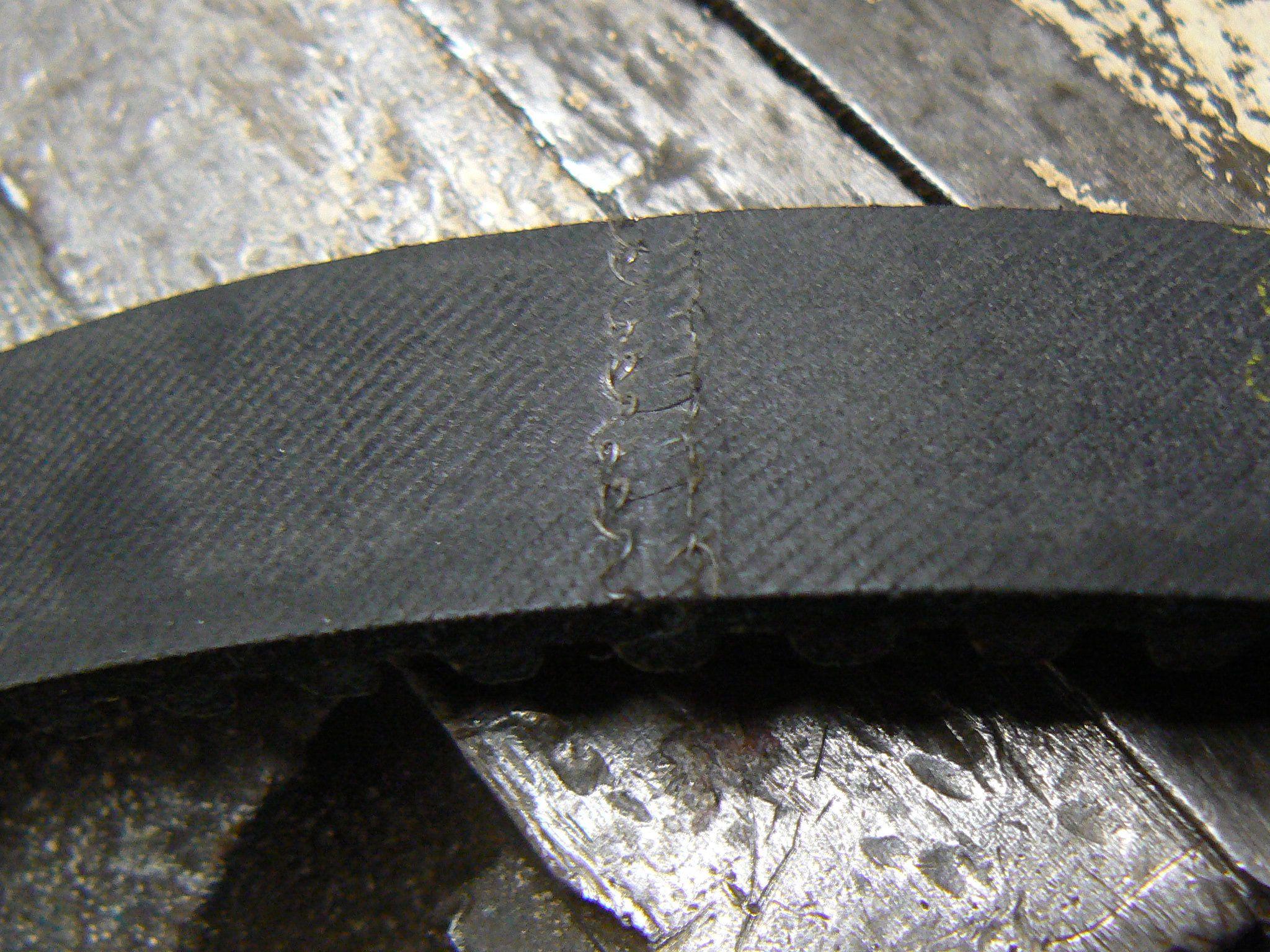

Ok folks, I'll have a go at uploading an image of the old timing belt showing the area of concern. This is on the outside of the belt and, to me, looks almost like a join in the belt which is starting to fail? However that doesn't make any sense because surely these belts are made with endless looped cords? If you look closely you can see there seems to be a small amount of separation going on and I'm glad I decided to get a new belt fitted. I've changed many timing belts in my life and never seen one looking like this, it's most usually the base of the teeth cracking if anything. I had a very careful look at the old tensioning and idler pulleys as they run on the outside of the belt and I thought there might be an imperfection which had caused this belt damage - although unlikely as the belt and pulley faces would never line up opposite each other exactly the same with each revolution. The faces were spotless on both components. The belt guards are comprehensive so I think a "foreign body" can be virtually excluded. I'm afraid it's all a bit of a mystery folks.
By the way, while we are looking at timing belts, I was surprised to find the old belt was a branded Dayco. I've always seen VW branded belts coming off at the first belt change - and I know this was definitely the original belt as the car was new when I bought it. Also does anyone know why Dayco belts have white teeth? (see second picture which shows the Dayco in front of a Gates I changed recently). All other makes I've ever used are black.
The auxiliary belt looked like it would have happily gone on for some time yet but, for what one costs, I'm glad to know it's been replaced. Plugs also looked in really good nick but, at just over 5 and a half years old replacing them will, if nothing else, have reduced the electrical load in the coils and I'll not have to look at them for another 5 years. Also, of course, it's going to much reduce the risk of them seizing in place. By the way my fears about coil removal were unfounded I was told they came out without much hassle at all. Next time, if I'm still around and not in a home somewhere or had my license revoked, I'll be doing them myself. Having been trained back in the '60's all my life I've installed spark plugs with a sparing application of anti seize on their threads - I would use Copaslip on cast iron heads and Alumslip on the ally ones. Now a days the plugs have a sacrificial plated coating which is supposed to stop the plug seizing to the ally head metal so you're to put them in "dry" now. I have to admit I'm still using anti seize on the older members of the "family fleet" but I'm won over now by the arguments for "going dry" on newer vehicles. I'm mentioning this because I've turned up something I didn't know and in fact need to do more research on because it may be incorrect. It is that, especially on DI engines which almost all use stratified injection (simply put the injector is triggered multiple times during the injection process - it "stutters" - so the charge density varies in the combustion space). I think, if I've read all this correctly, the position of the side electrode is important in all this and correct positioning is achieved by fitting the plug dry and torquing to the recommended figure so the side electrodes will end up facing "right". Anti seize or failing to torque with an accurate wrench may result in the side electrode being wrongly located. Of course I may have completely misunderstood all this but I'll definitely be installing plugs in DI engines both dry and torqued until I know more.
I was also very pleased to see the tensioning pulley is all metal - a sensible choice if the belt is potentially a lifetime fitment. Just find myself wondering why they didn't make the idler all metal too? Also, in that last picture you can see the "humongous" crank pulley bolt and, what I'm guessing is, the VVT pulley blanking plug? Which has a rubber sealing ring on the other side, which is probably why it gets replaced?
Of course I've had a really good crawl around just to see all the nuts bolts etc have been correctly refitted (sorry if that's offensive you AVW guys) and I couldn't see a single thing to call them out about. Absolutely everything just as it should be! However, during all this crawling about I noticed, as you do, that the auxiliary belt tensioner pulley is slightly damp with grease on it's inner face and I suspect it's seal is just very very slightly leaking. It's not worrying me but probably means I'll fit a new tensioner at the next big service - going to keep an eye and ear on it in the meantime, just in case.
To me that joint looks ok. The pale colour is PTFE coating from Dayco HT belts -
From gates marketing blurb: "HT belts are immediately recognizable by their exclusive light-coloured inner side due to the presence of the PTFE film, an exclusive Dayco patent."
When engineers design pulley systems they ensure each smooth pulley diameter is not evenly divisible with the other pulleys - so if one pulley was 100 for example - they wouldn't make the idler any number which devides evenly into 100 - 100/50/25/20/10 etc.. to avoid as you say increased wear from the pulleys repeatably lining up. Obviously can't do this for timed pulleys!
Regarding plastic idlers - it depends on how much 'work' the idler is doing if they can 'get away' with plastic - so if the idler is only deflecting the belt a few degrees plastic may be ok - it the idler was substantially changing the belt direction metal would be the better choice.
Regarding spark plugs, the modern iridium ones generally have a very long life. Recently changed some on the Mitsubishi Colt in my 'household maintenance fleet' at 60k miles from new - and they looked great the gap was in spec (no erosion). probably could have easily done 80k miles. No seizing in the alloy head. Do not use grease/anti-seize on the threads as this may effect the earth path of the plug - and anyway not needed, the boot from modern coil on plugs prevents water ingress around the base of the plug - unlike my Rover V8 for example where the plug base is open to the elements!
Regarding 'spark plug indexing' this makes 1% of bugger all difference! Don't worry about it - just install dry to the correct torque/angle. Some OEM plugs have the threads cut at the correct angle to 'index' the plug automatically when at the correct torque - but really it makes all but no difference.

Thanks Super V8. Being a bit of an ageing Hot Rodder at heart I just love the sound of a V8. The old 2.5 Turner V8 in the Daimlers being a particular favourite with me, it just looked so "beautiful" - I also hold the Rover engine (extensively developed from the old Buick unit) ) in high regard. It has to be the British equivalent of the old small block chevy?
I know my plugs would have gone much longer but at over 5 years old I don't regret spending the money and actually they are much more affordable these days that they used to be. As you say modern plug connectors, very often now part of the "coil on" individual ignition coils are very good at protecting and keeping the plug insulators clean. Unfortunately these extended rubber boots can also make it quite difficult to pull the coils off which was why I decided to let them do the plugs this time round.
Very interesting what you have to say about "divisability" with regard to the pulleys - good engineering practice. I remember, many years ago now when still doing my City and Guilds, one of the students asked why Rolls Royce parts were so expensive. Our instructor chose ball and roller races to illustrate his reply saying, If an "ordinary" ball or roller race is designed so a spot on the ball/roller lines up with a spot on the race once every 50 revs then the RR one will line up once every 500 revs and that sort of precision costs more to manufacture. To this day I don't know if I believe him. In fact in later years I got to know the engineer who maintained the RR's for Holyrood up here and I was in his workshop one day when I accidentally kicked an old wheel cylinder which way lying on the floor - looked to me like any other cast wheel cylinder. "CAREFUL" he said loudly, "That's a Rolls cylinder you're abusing there, have you any idea what they cost"?
I'm so glad to see what you have to say about plug "indexing". I've read a couple of articles about it and have to say I just don't "get it" so glad to hear what you have to say. Completely in accord with your reasoning on not using anti seize on the threads of modern plugs too.
Thanks for clearing up the "mystery" about the white coloured teeth on the Dayco belt. Did you enlarge the image I posted of the damaged bit on the surface of the outside surface of my old belt. The image my camera produced is quite high res so can take enlarging to see more detail, you can see the wee hairy threads which seem to be pulling out of the surface of the belt around that imperfection. I really don't like the look of that and I don't think there's any way it should look like that. As I get on very well with the lads at AVW I'm going to take it with me next time I'm out that way and ask them if they have an opinion on it.
Thanks very much for your contribution here, I've enjoyed reading it and now know why the Dayco has white teeth! All best wishes.

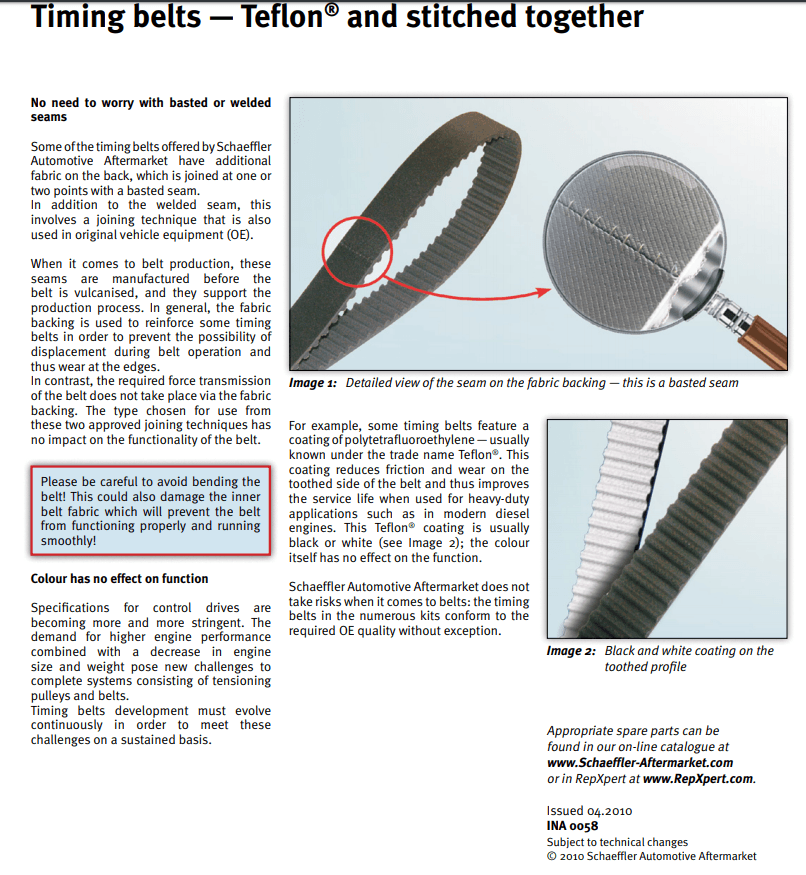

Regarding the stitching on the belt - this stitching is 'only' the fabric backing - it's not the actual belt tension strands which are stitched.
You might find the below info interesting:
Thank you so very much for that. I didn't know the belts have this stitched join and have never noticed it on any of the, probably hundreds of, belts I've changed in my life. As the saying goes "you learn something new every day". I've got at least half a dozen old ones hanging on a hook in the garage right now. I'm going to have a good look at them to see if the seam is visible on any of them. Looking closely at my old belt it's obvious that it's this stitching which is loosening and you can see the small grooves in the rubber where the threads were before they started to unravel. Yup, for me, changing the belt was the right thing to do. The article you featured states that the stitching is carried out before the belt is vulcanized so whether the failure of this stitching would eventually result in this outer covering delaminating and either the seam opening up or the whole outer belt coming off, who knows? I'm a lot happier knowing I've got a new belt on there though.
