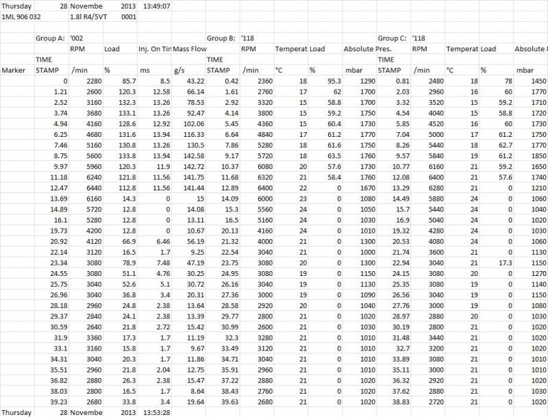

Well I managed to get a laptop to work and have taken some logs and to say the least I am very disappointed and it does confirm that my car seems to have lost its sparkle in performance :confused::confused:
I am sorry that I have to copy and paste the results but I am hoping someone can decipher and help me understand what the issues might be, Badger asked me to read blocks 002, 115 and 118 which are below, any help would be greatly appreciated as this performance is poor for an AMk engine, I did several runs and all about the same the maximum g/s reading of 142 is very disheartening, cheers
Group A: '002 Group B: '118 Group C: '118
RPM Load Inj. On Time Mass Flow RPM Temperature Load Absolute Pres. RPM Temperature Load Absolute Pres.

Hopefully I have managed to find a way of posting my image here fingers crossed
First Link
If this works it will help to see my logs as I do need some help in trying to understand the problem with high fuel consumption and very clearly a big underperformance in horsepower.

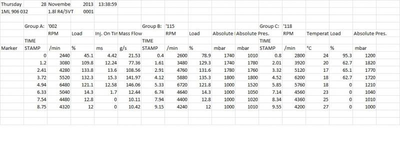

I have found another log I also did but not all of the right blocks but might help in giving me some advice please
