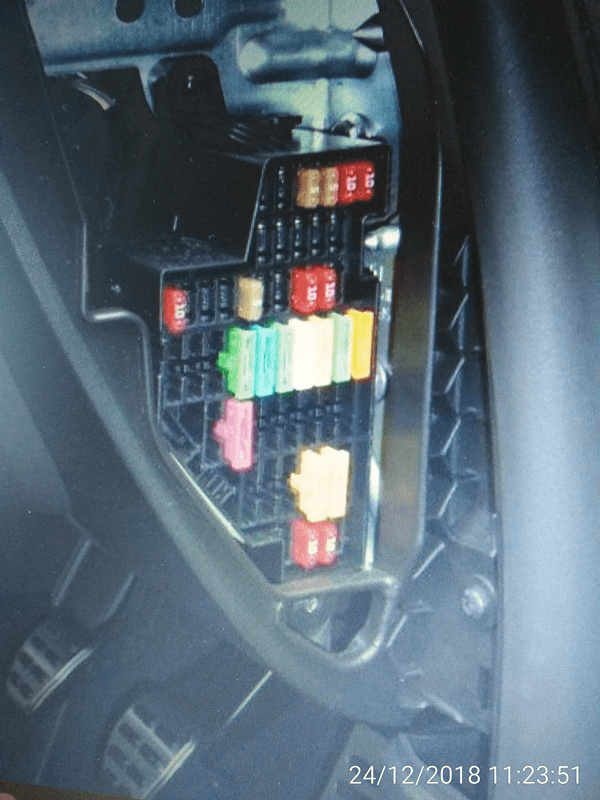

Depends on what you are trying do, can you use a different fuse that is permanently live?

I'm not sure where I'd begin tbh haha, I think maybe leave it or get someone to fit a kit to make it live as I don't wanna mess with fuses. On the mk3 thread it sounded easy but seeing how different the diagram is, I'm not sure what should move/replace. I've found the one for the 12v and removing it makes it so it doesn't work at all, unsure how I would make that to then go perminantly live.

Could you take an image of your dush fuse box?

Dec 18, 2019
27
Legend, will check mine to see what's the difference later if any and test a few bits out. Thanks or that pal!
Dec 18, 2019
27
No differences at all except ones referencing Engine D2L - 4 speed TFSI. Really frustrating haha

Did you find a solution?
What are you trying to find? A permanent live feed? If so on the back of the light switch there’s a red wire. If for some reason you can’t get to it unscrew the fuse box and use your multimeter to find a live from the back of there, should be plenty of options
