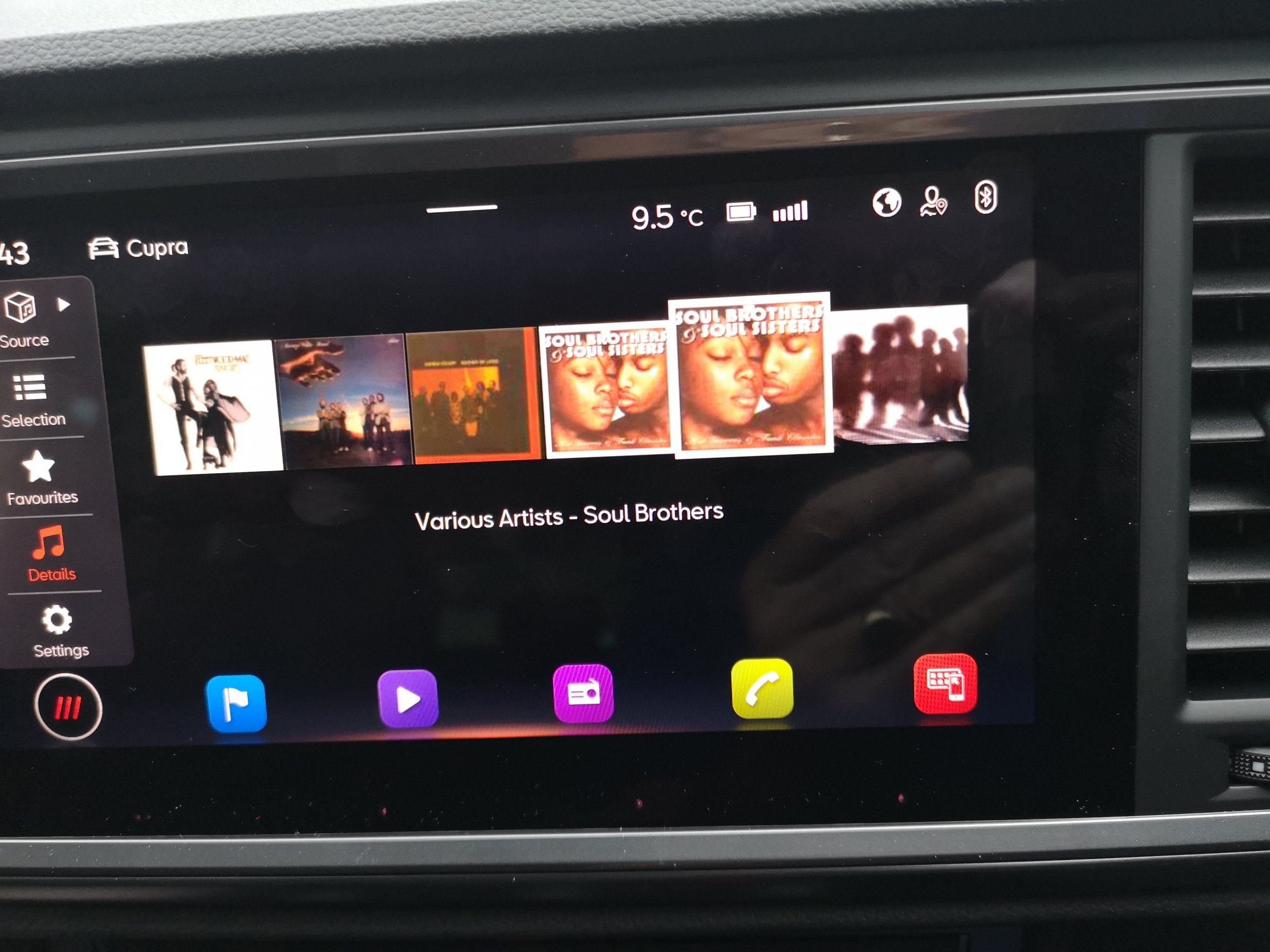

Tried new usb c. and only 3 out of 35 albums show art. Still trying to see what the difference is. Tried embedding
jpg using Windows Media but no difference. Noted one album was a download from Amazon and had no Cover jpg.
Other two Flac files had cover.jg. Obviously missing some hidden folder difference.

Ha looks like a fix. Did it old school using Mp3tag to embed the album art on each file. Briefly add directory from data stick, open each album folder, select all files then drag drop the cover.jpg or in one case drag from google, then save and change to next folder. Might not be easy with large amount of albums. Did not check for any batch process options and did not find the Discog link on Mp3tag easy to source the album art.
Thanks to @Bedlam and @Tell for heads up on this one.

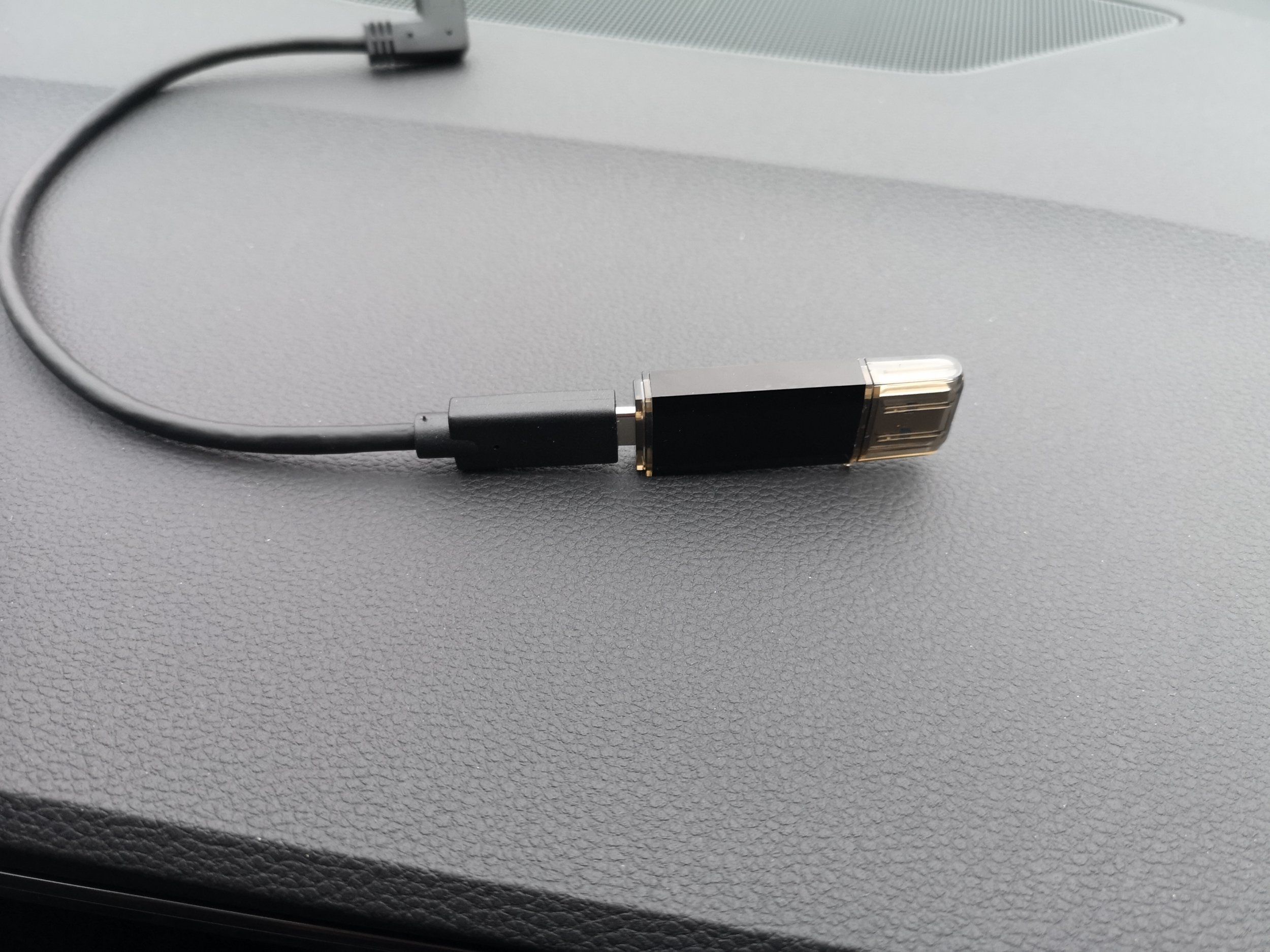

Using a right angle usb c plug and cable to a double ended usb stick
