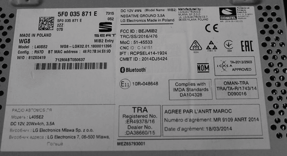

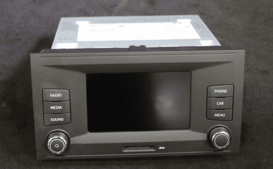

I have 5F0035871E 2ZZ (MIB2 ENTRY it seems) Notice the lack of NAV/TRAFFIC buttons.
Oh I see, it's called MIB2 'entry', interesting. Either way though you have to have the unit in the glovebox, that's how it is able to intercept the connection between the screen and the computer. With yours the computer is internal to the screen, so it won't work.
