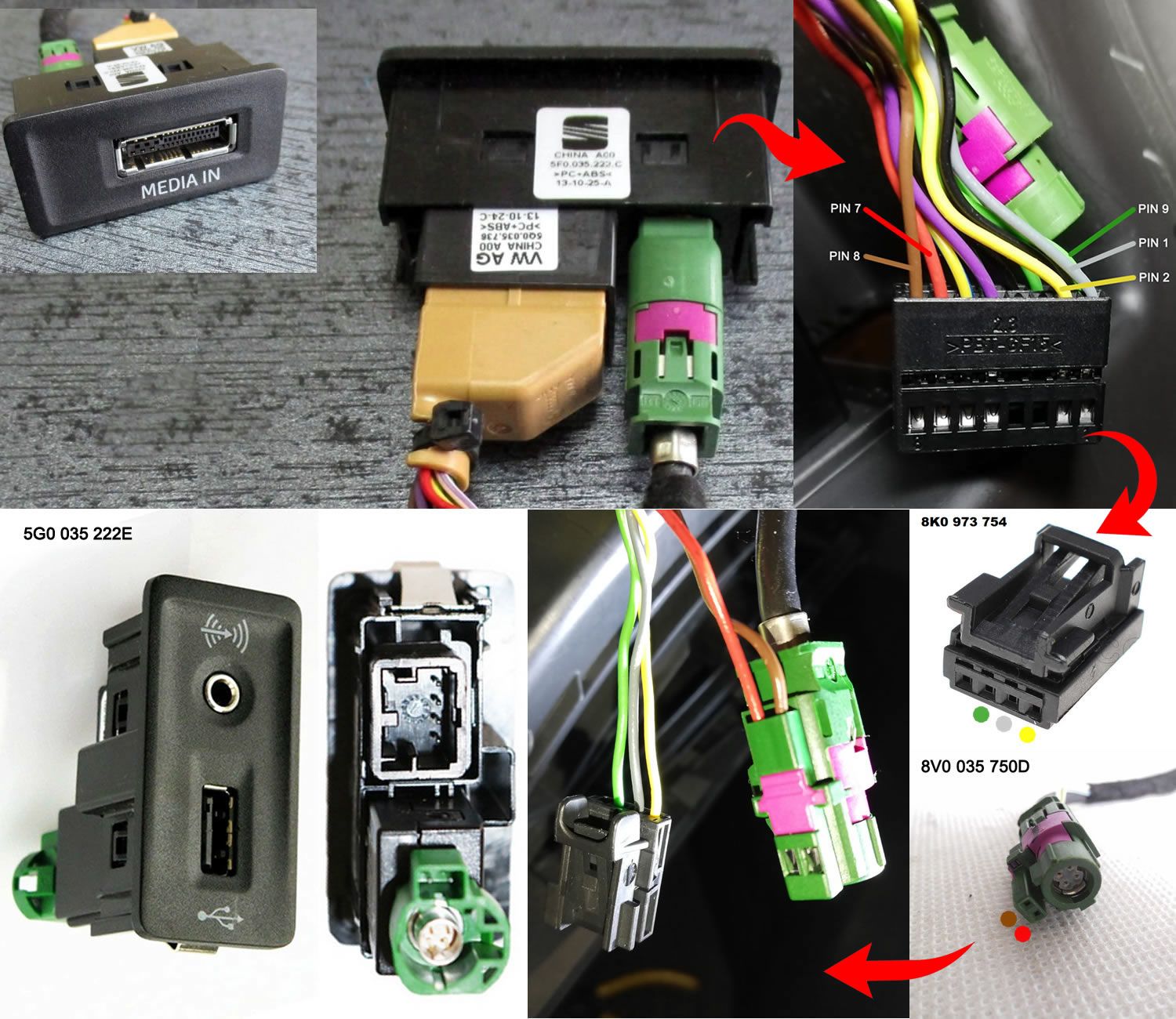

Now my car doesn’t have a USB port! For me to get the full link CarPlay system working, I need to retrofit a USB port in.
To retrofit the USB port replacing the OEM Mitsumi module, you can follow this guideline below.
Hope it will help you.
Parts
5G0 035 222E > USB+Aux module
8V0 035 750D > 6-pin HSD Connector (w/5v)
8K0 973 754 > 4-pin electric connector
Pinout
From old 16-pin Mitsumi connector to new 4-pin USB electric connector
pin 1 ---> pin 2 (grey)
pin 2 ---> pin 1 (yellow)
pin 9 ---> pin 3 (green)
From old 16-pin Mitsumi connector to new HSD connector (5V)
pin 7 ---> pin 1 (red)
pin 8 ---> pin 2 (brown)
Coding
Deactivate Mitsumi module:
STG 5F > byte 8 > deactivate bit 5
Activate USB module:
STG 5F > byte 19 > activate bits 6 y 7
