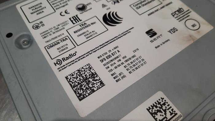

And is version 5F0035877A as good as 5F0035874A?
5F0035877A is without fiber optic connection but also HW50.

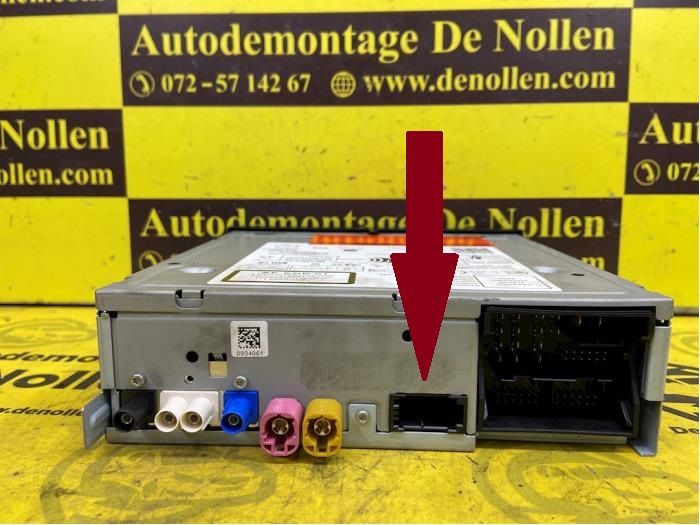

Does version 5F0035874A have a fiber optic connector?
How do you know (is there any marking) if the main unit has a fiber optic connection?
On the backside beside the quadlock is a extra black connection port.

Are you sure the unit you've bought has a MOST connector?... 5F0035877A does not, so it does not support maps on a virtual cockpit
There's 0 benefits to using 5F0035877A over 5QA035858, only cons
